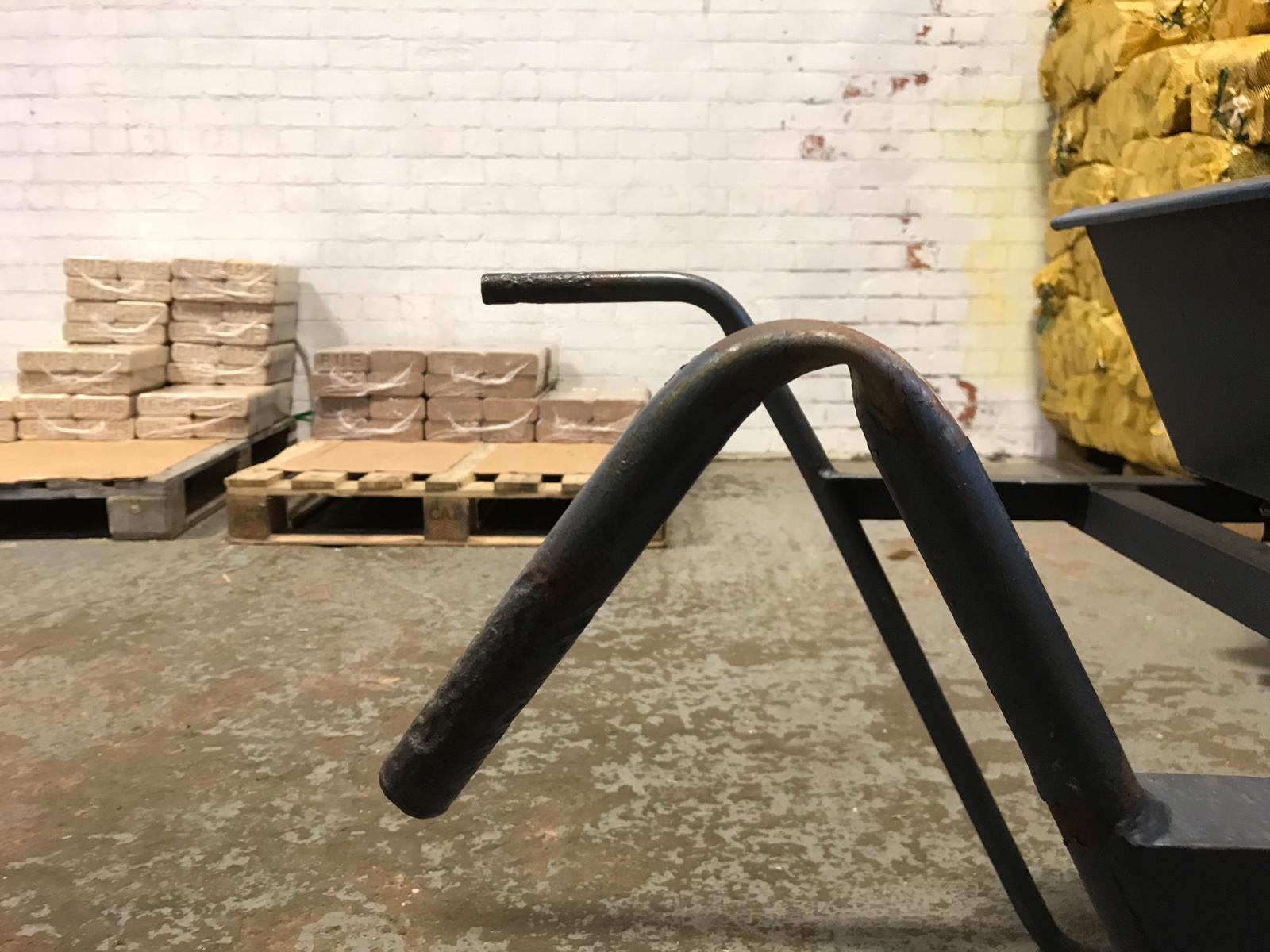

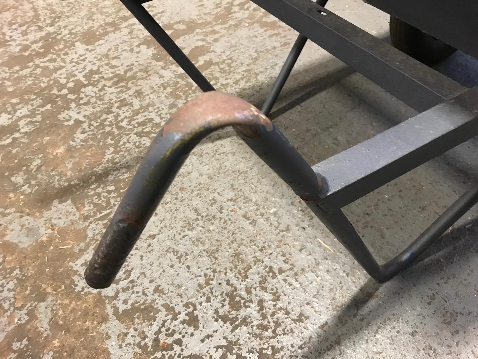

Both handles would be my choice too.Cut them both off at the same place,then replace with round bar,bend,if you can get a bit that'll slot in the old

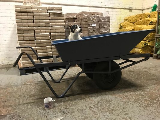

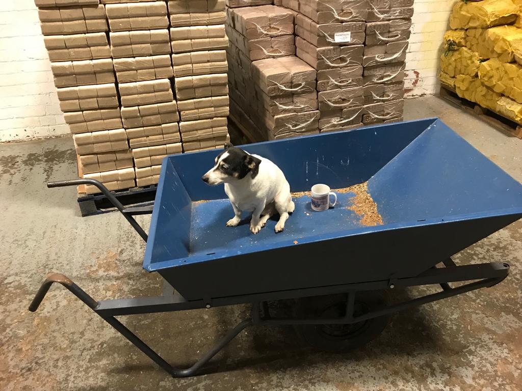

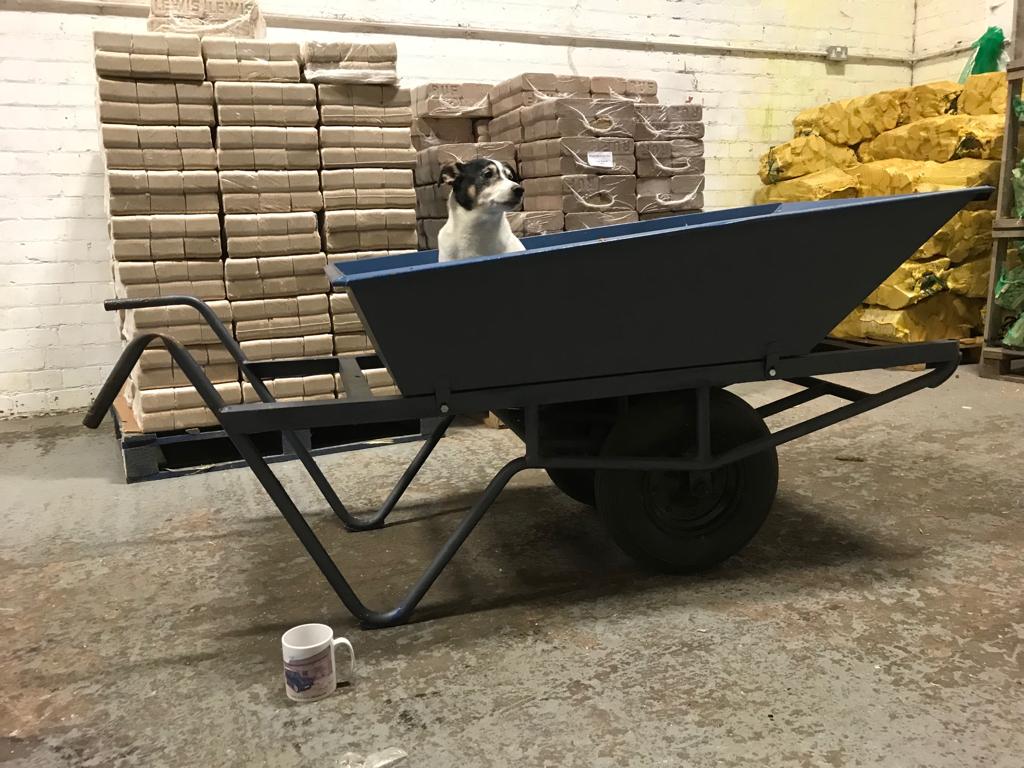

Cut em both off and make a new pair of improved handles.Some good suggestions thanksHere's a couple more shots to show the size of the thing.

I was thinking of similar, but do it cold with a pressure washer. Colin Furze did it it in one of his vid'sWeld a ply on the end with an airline fitting and reg on it, heat bend to cherry red and pressurise it slowly, if you’re lucky it’ll pop the tube out
