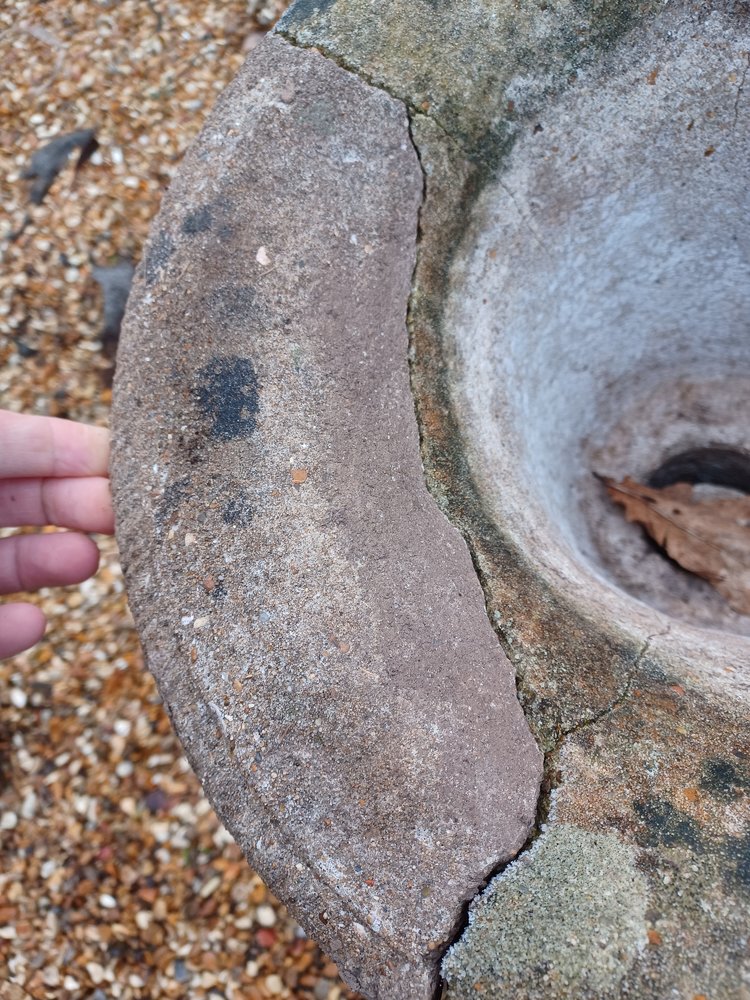

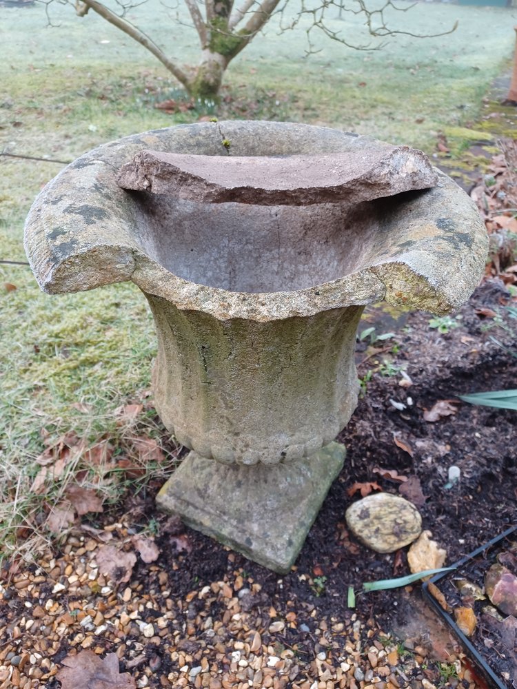

if they are you could give it a coat of neat sbr bonding agent and let it dry then resin glue it together . it will; stick like sh.it to a blanketSurely depends on how friable the surfaces are?

Bodge, DIY, I guess.Thanks again for all the help. What did people like me do before the internet? Bodge stuff I guess![]()

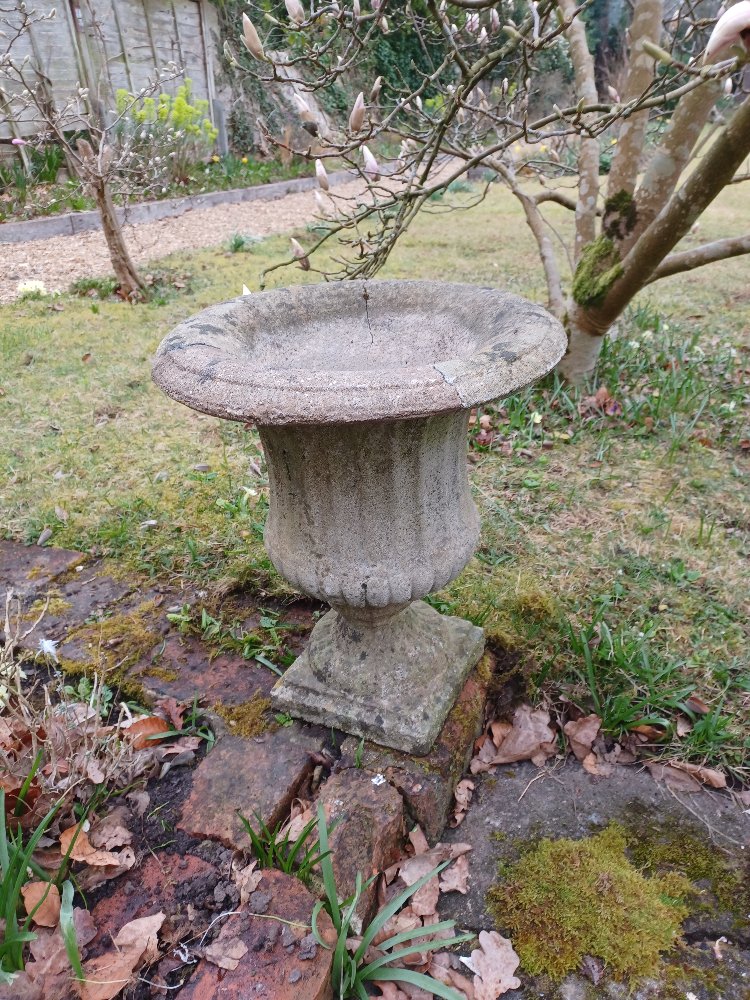

I'll get round to filling the cracks at some point.
Done an excellent job there...need something that will get into and seal the cracks.
Some sort of grout isn't a bad idea...something weatherproof with the consistency of a self leveller maybe...then brush it into the cracks. Colour match will be the challenge.What about some tile grout
I used a weak PVA solution on the mating surfaces, then this stuff from Toolstation: C-Tec Power Grab n Bomd Construction Adhesive.You have done a good job of that. What adhesive did you use in the end?
