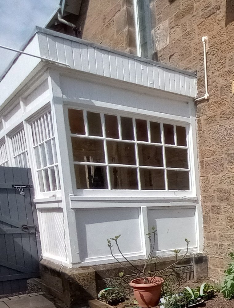

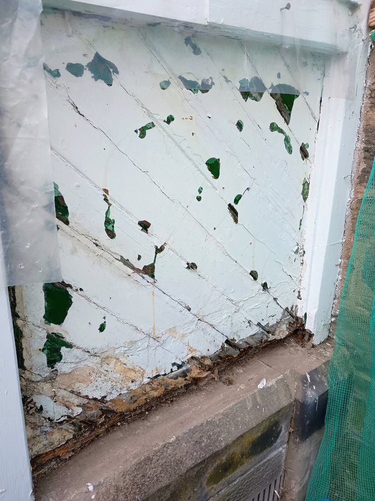

When I was prepping the windows for reglazing I couldn't ignore the panels below that were covered with peeling sheets of thin plywood.
Pulled it off to find this. What I'd like to do is demolish the entire porch and rebuild it, it's full of rotten wood, but that's for another year.

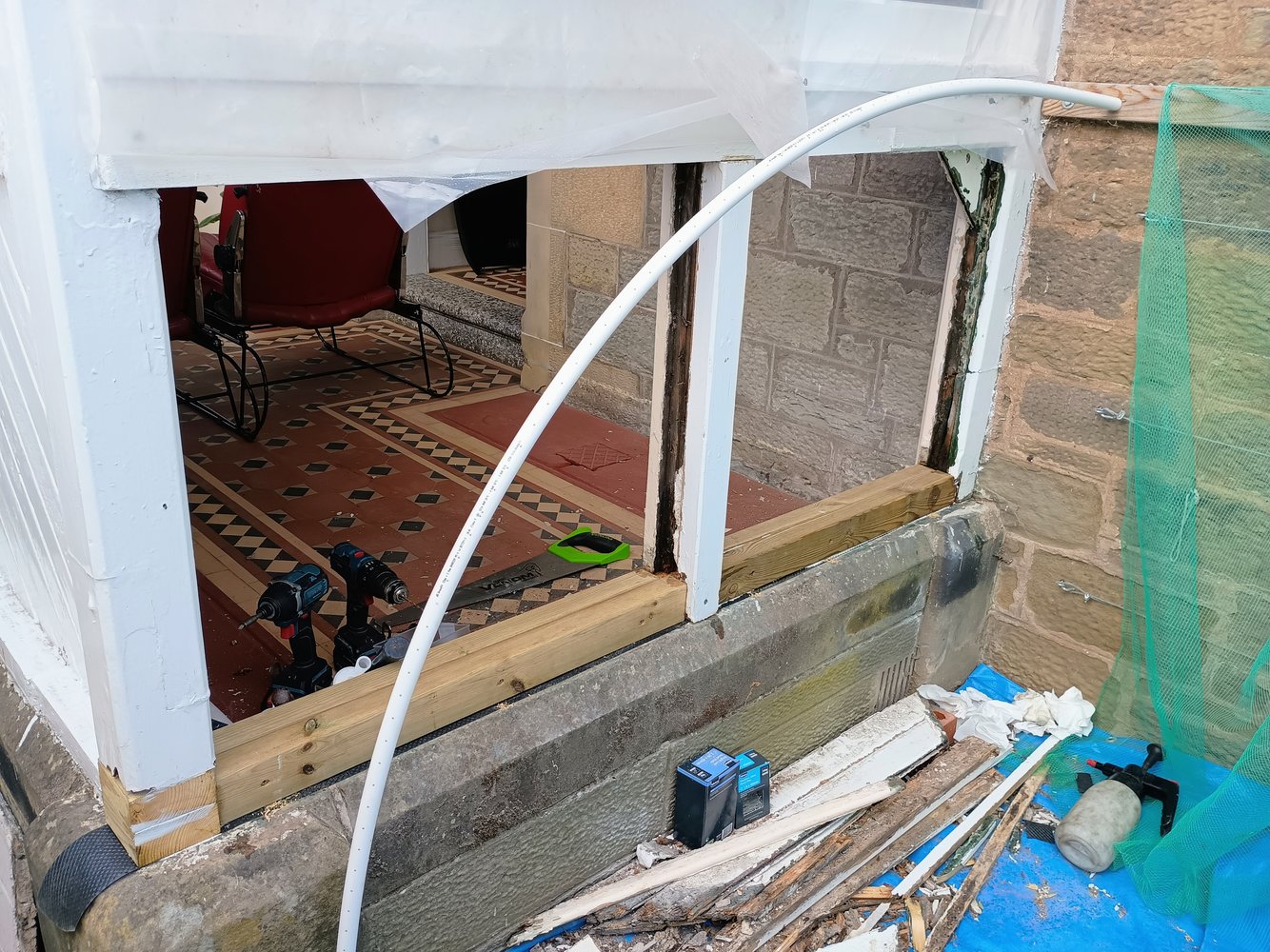

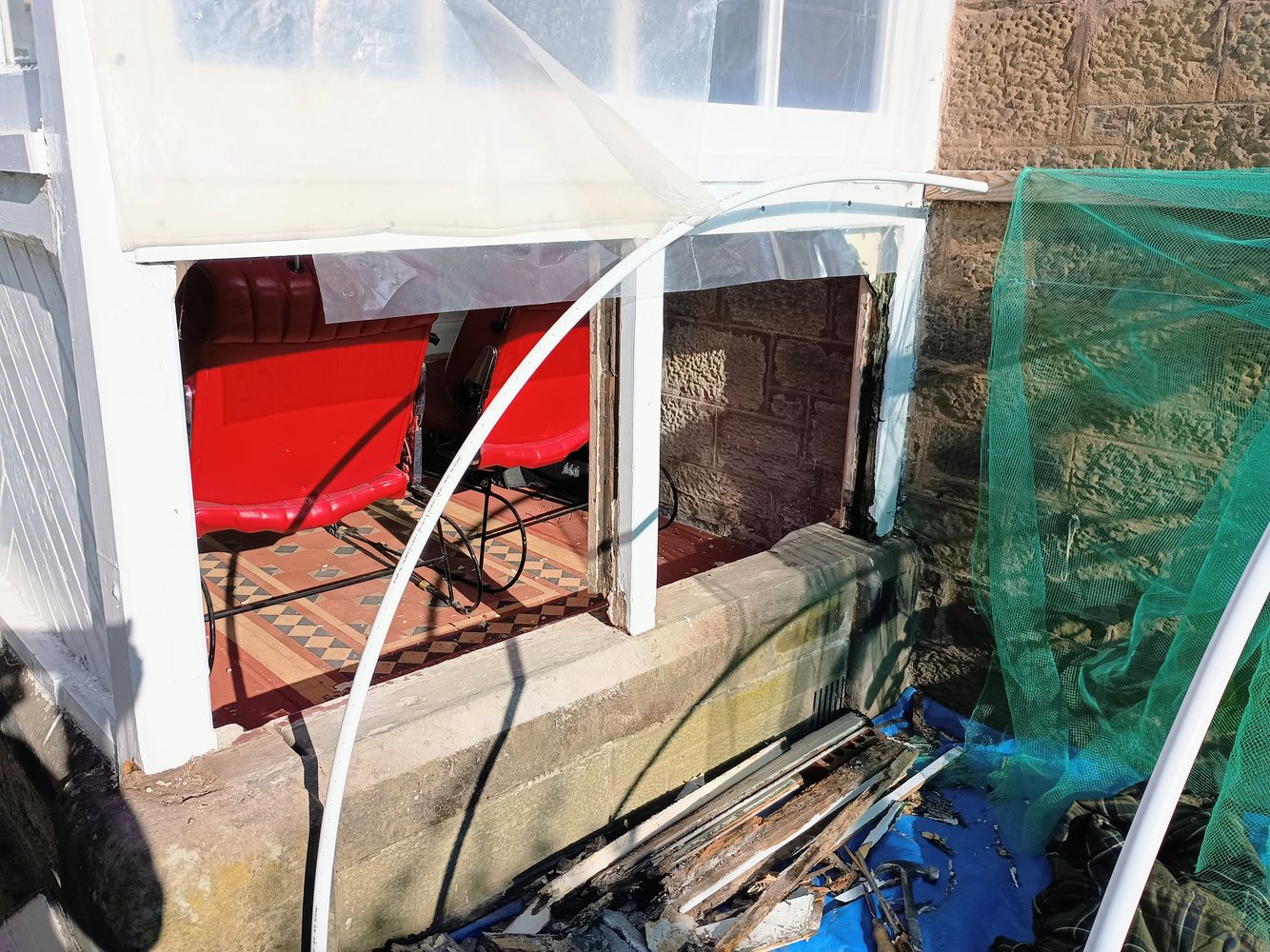

Ripped it all out the t&g and frame.

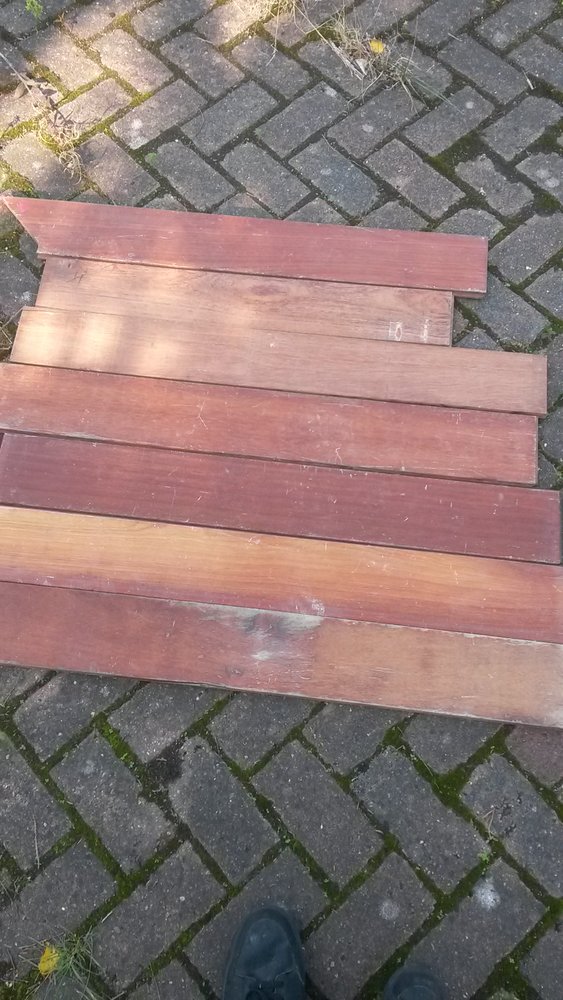

This cedar smelled good enough to smoke, mmmmm!

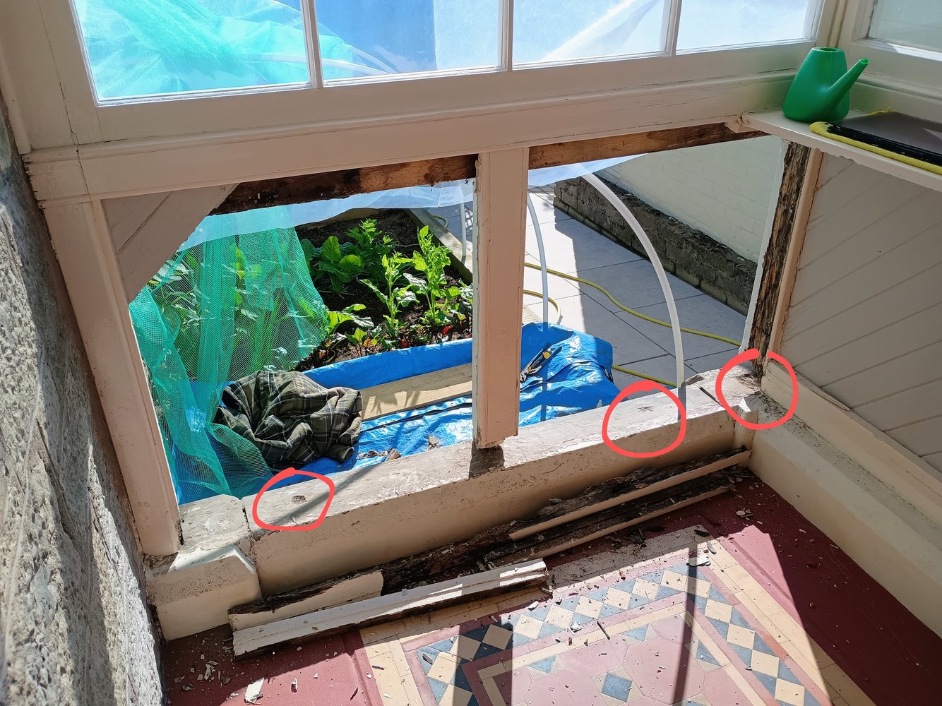

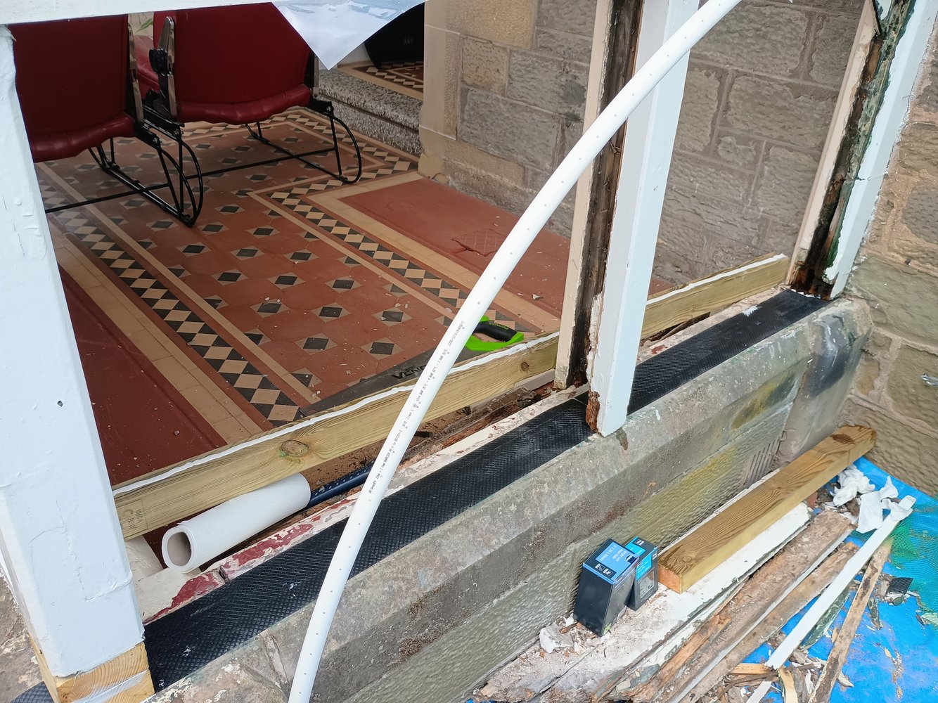

Dpc glued in place.
Frame in.

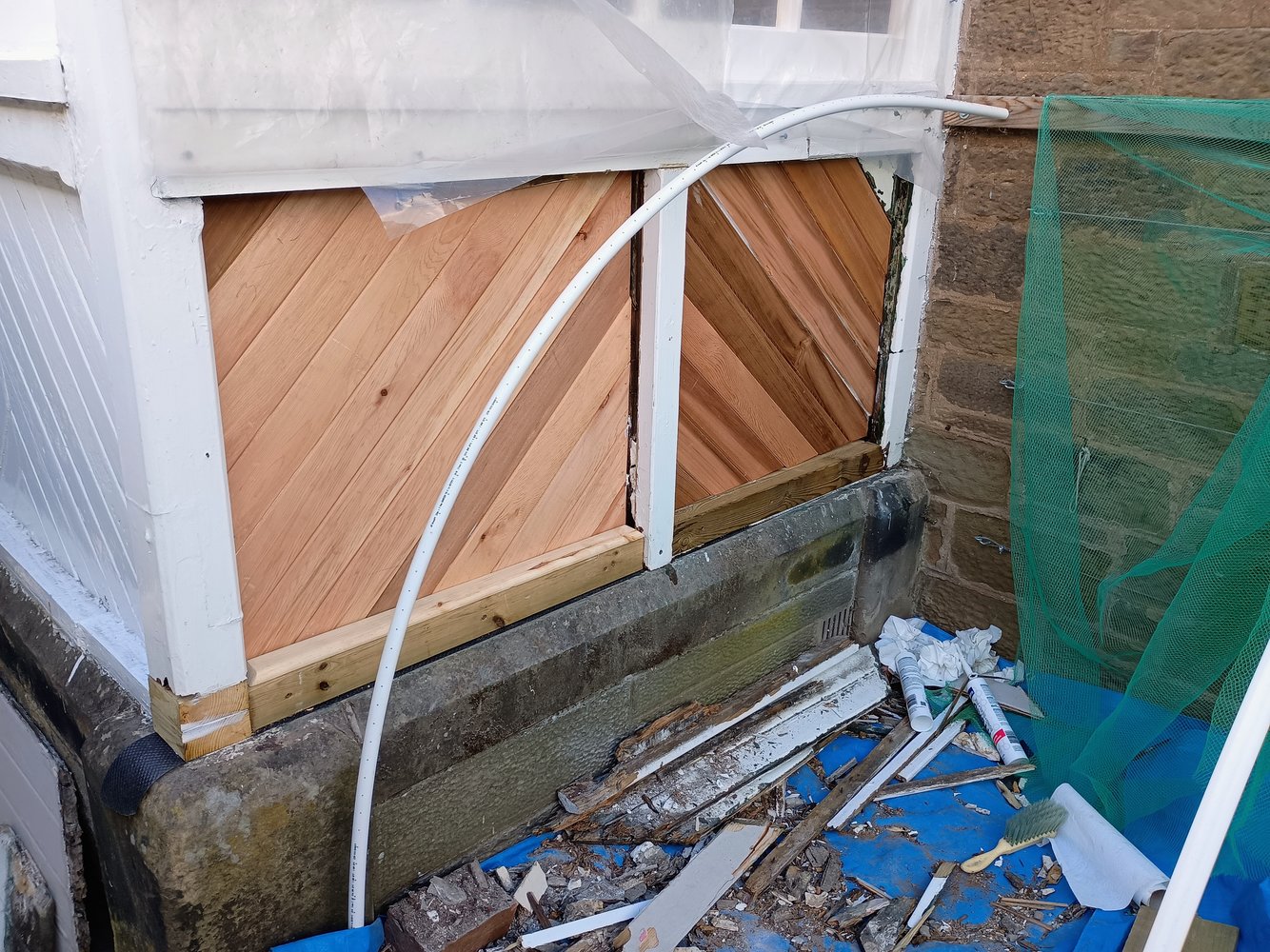

TnG in.

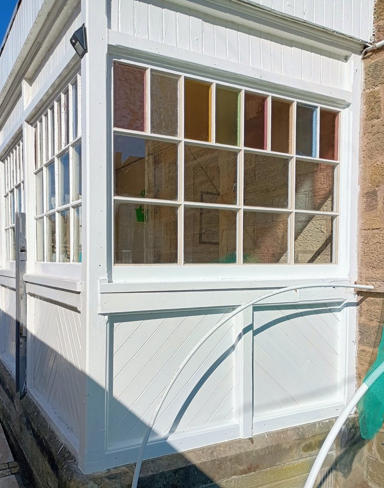

I'll finish the beading and paint on Saturday.

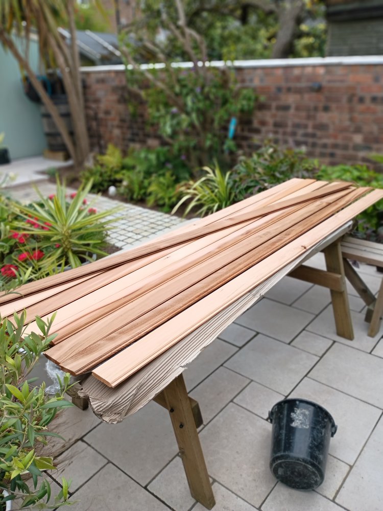

Dpc glued in place.
Frame in.
TnG in.
