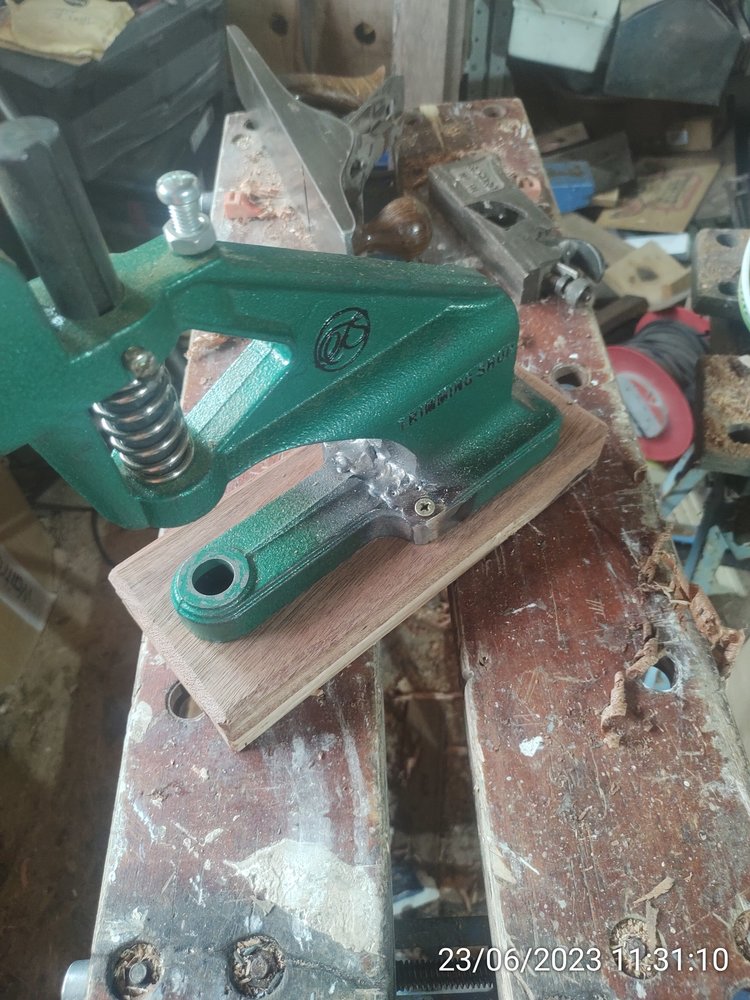

As others said, it will weld and also add a thick steel plate underneath to spread the loads. I use special cast iron electrodes from oerlikon but as you might know- not every cast is good metal and might not fuse properly ! It’s salvageable !
