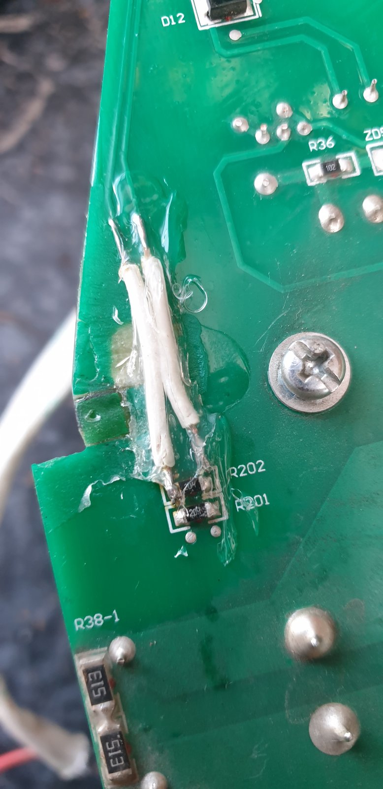

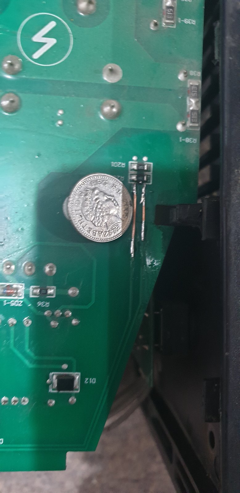

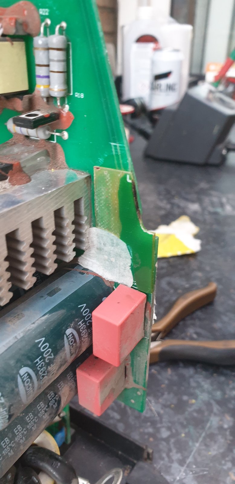

tryed googleing Mek Pack resin nothing comes up ?

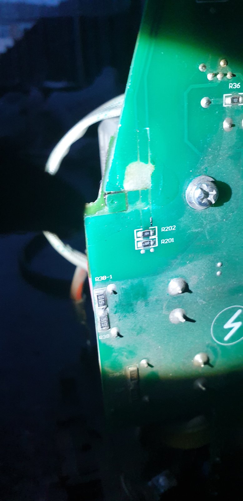

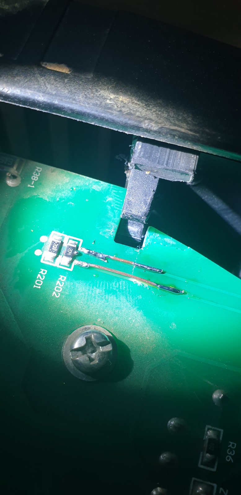

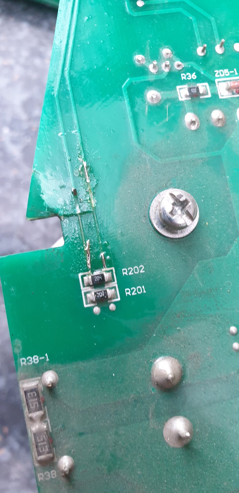

can you use solder to join im sure as soon as i put an iron to the solder it will a pool of molten metal and is solder not quite soft ?

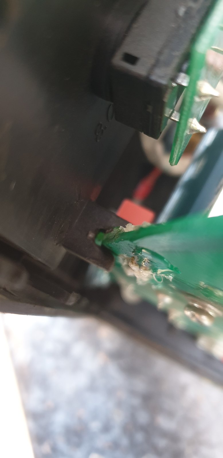

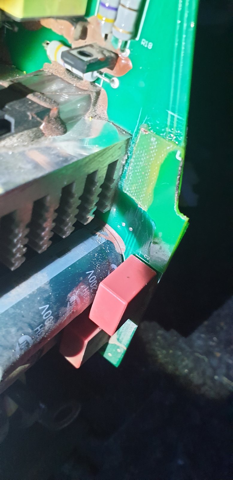

there is enough spare room around the fixing to secure some paxolin board to it with some small screws that you could then re fix it to the retainer!?
As for the soldering I would expose a bit of clean track and solder direct to that, the end that is all solder by RD202 if it goes to that I would be tempted to carefully solder directly to the leg of that!
If not using insulated cable then hot glue or even plastidip as that is insulating as well
Sy

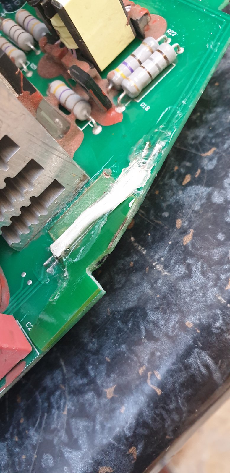

If its working as it is I would be tempted to fit it back in place, put the mount screw in but stop short of doing it all the way up, then cover everything with a hot melt glue gun.
Won't be the strongest repair but will give you a chance of getting the glue off again cleanly if you need to get back in there again one day.
If you’d like something 3d printed let me know the dimensions and I’ll do something for you
Fire some epoxy resin over it all if you're that bothered... or even some silicone sealant
