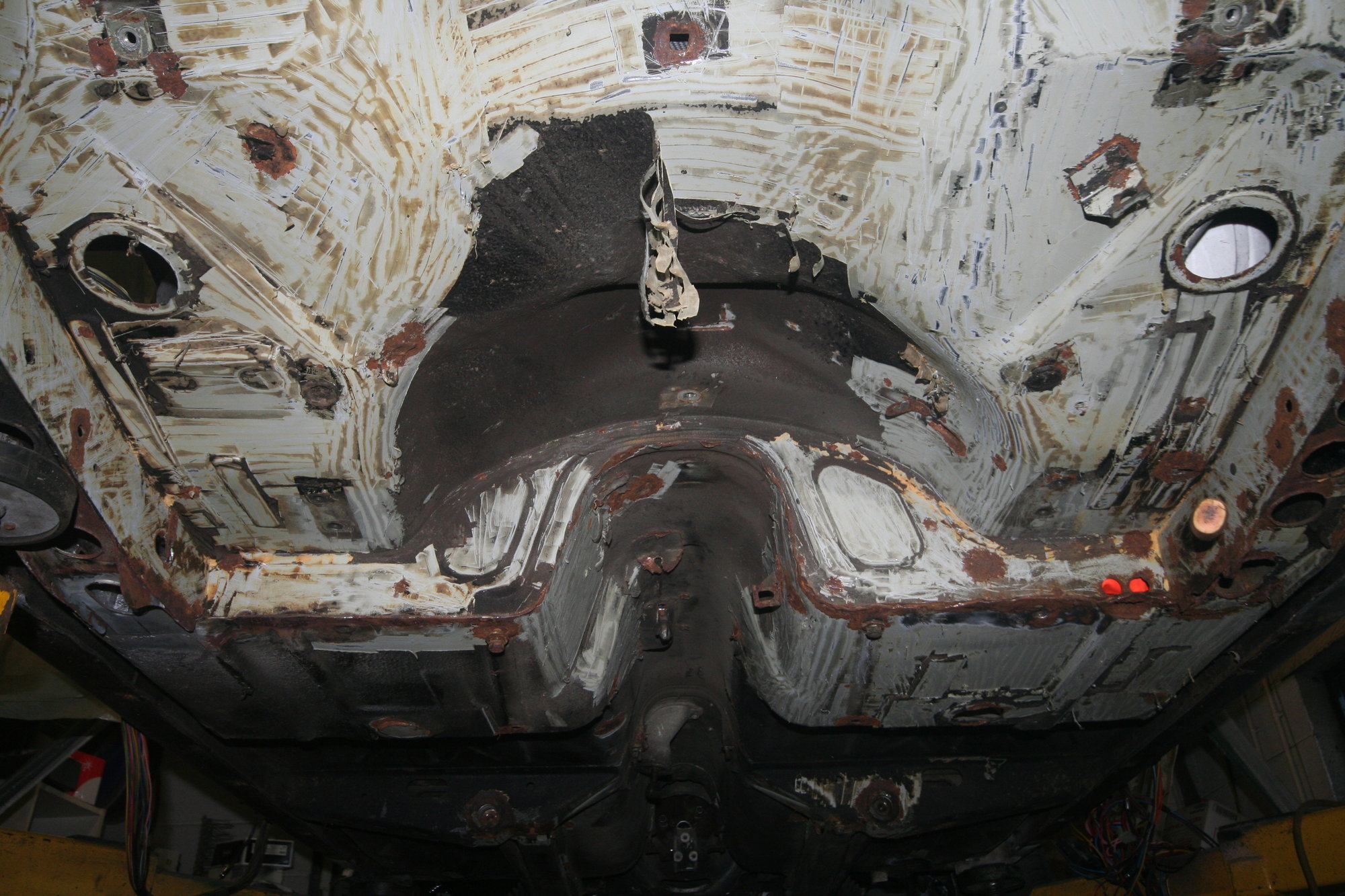

Heat gun and scraper on thick factory underseal
They aren’t too bad. It’s an elastic band from memory. It doesn’t shed its spikes either, not like those grinder attachmentsCripes, I can't imagine what sort of PPE would stop one of those letting go at high speed.
Poly disks I find are the best on an angle grinder remove it a treat. View attachment 270294
If you're doing the whole vehicle in a one-er and have a local service that would be my choice too.Dry ice blasting
