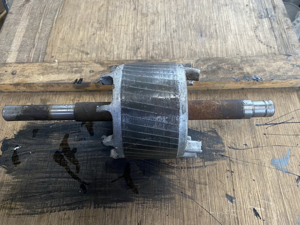

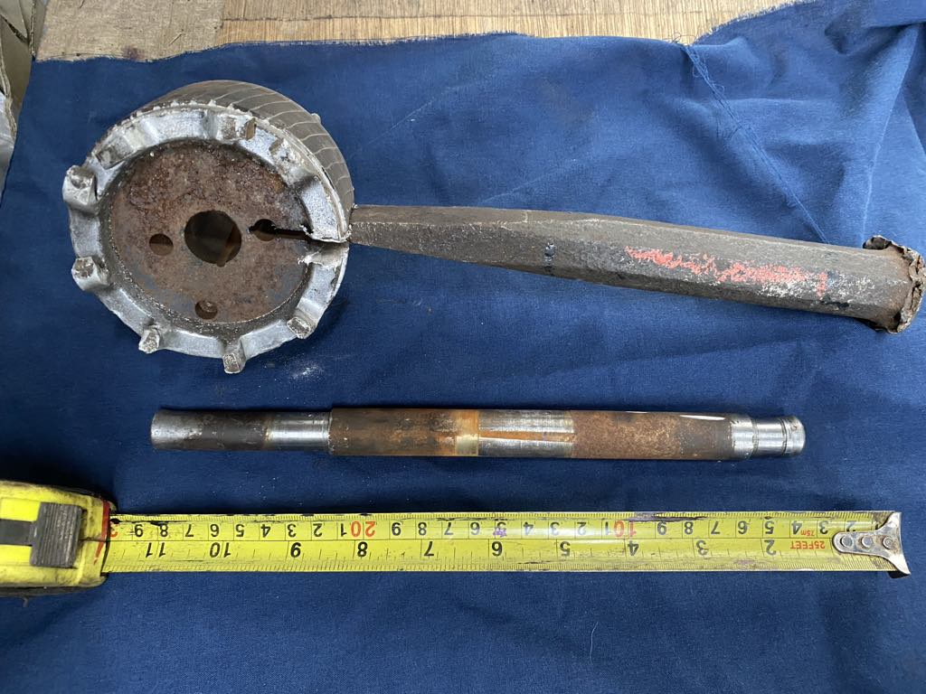

Last time I wanted the shaft from an old electric motor I cut the centre lump with the angke grinder, parallel with the shaft on both sides and drove wedges in the cuts to break the last milimeter or so.
Is there an easier way? I have tried driving it out with the 10ton press and with a big hammer but it appears solid.
I don't have any immediate use for the shaft, just seems pityful to drop it in the scrap bin.
