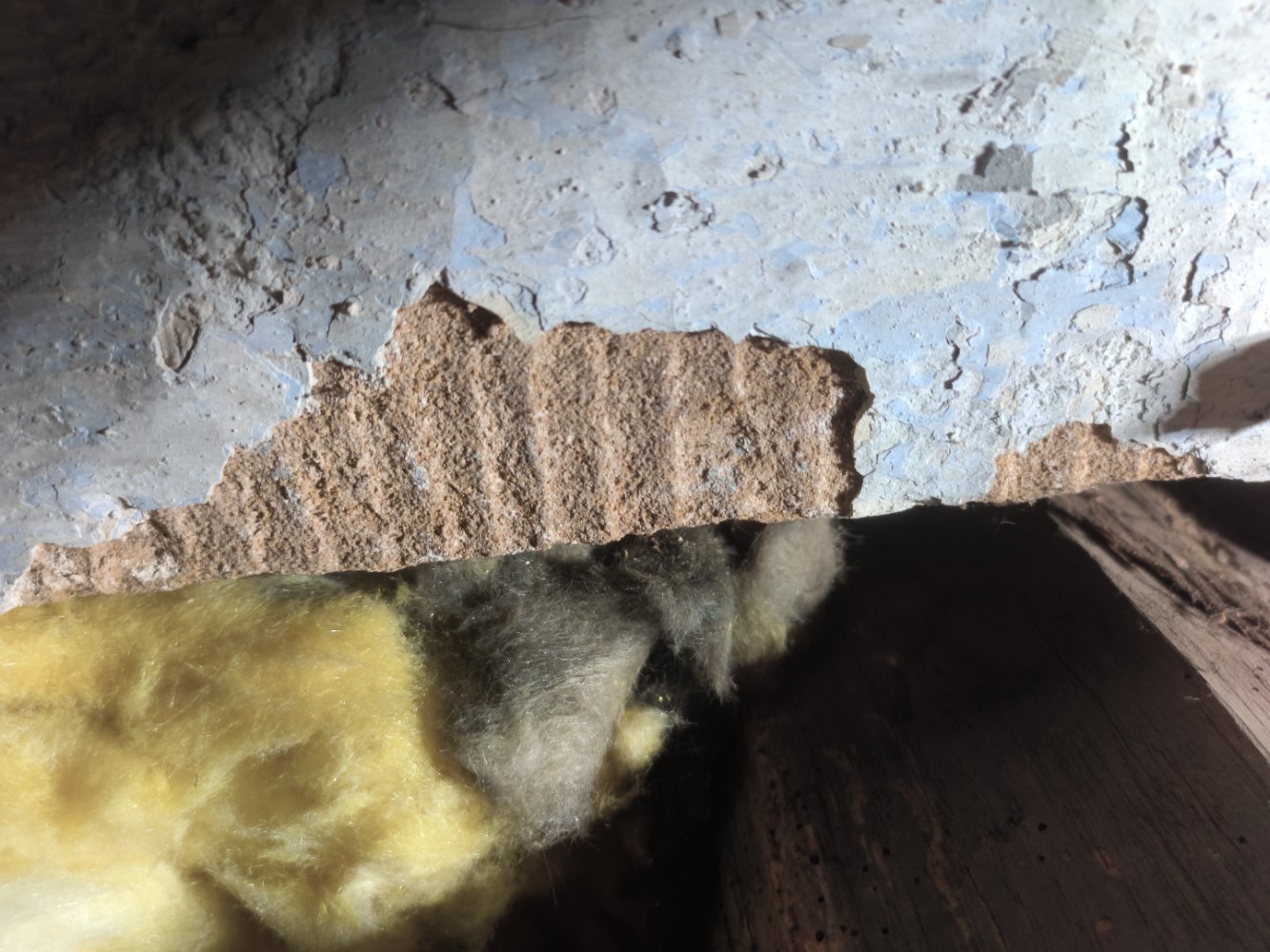

Is the pink stuff what you are trying to keep?
And the blue what you are wanting to remove?
If so, i reckon the blue is just a whole load of limewash. Water will not dissolve limewash in the same way that it will gypsum.
A steamer may loosen it for mechanical removal, but it wont dissolve it.

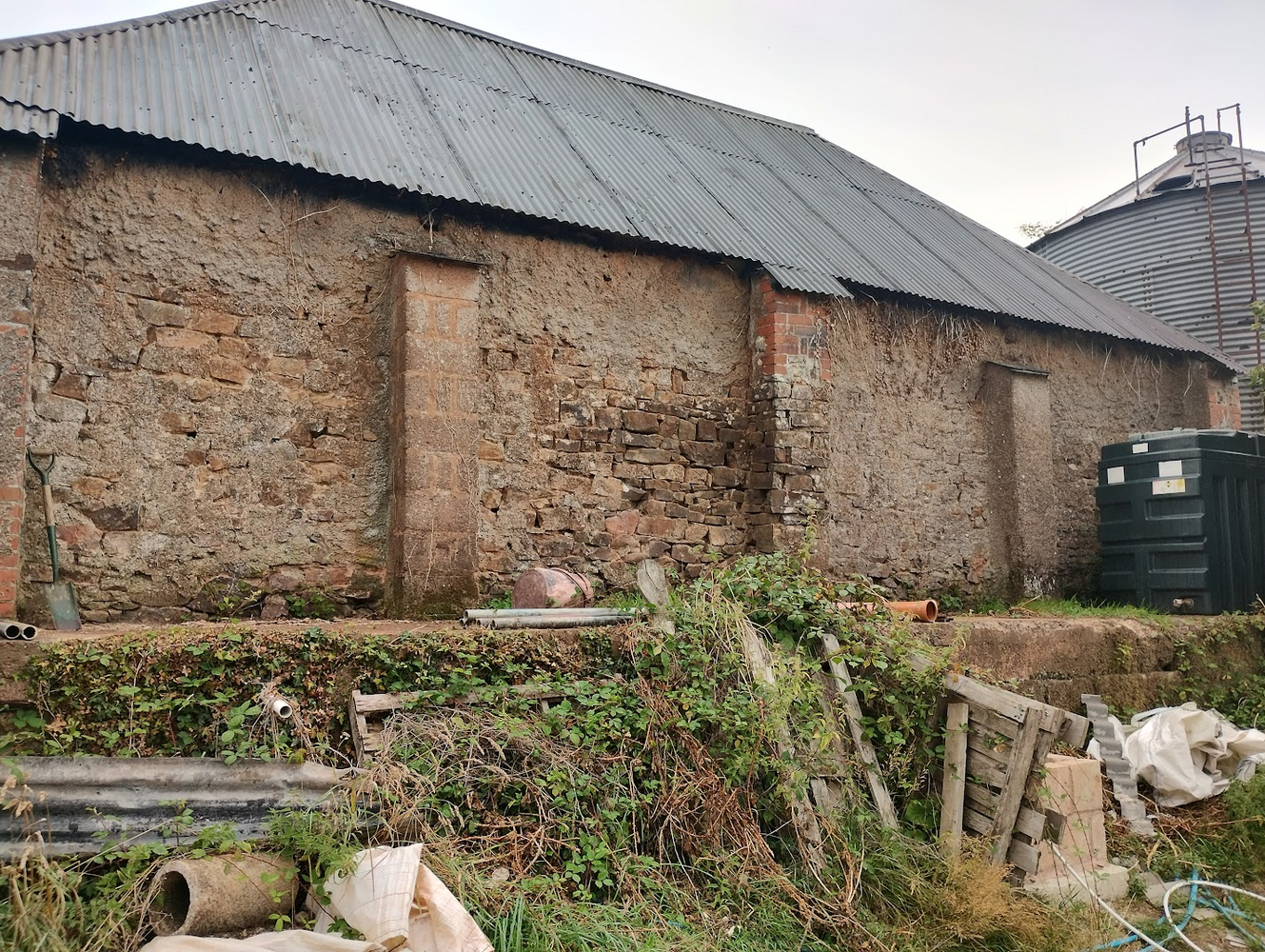

Im having an issue with scale from your photos, but it doesnt look big - id say just get on with it by hand (or whatever) and it will be done.
The job i posted prior was a close up of this -
Again, that was done by hand, without electrical tools. Sure i was getting paid, but its not like it took three lifetimes.
