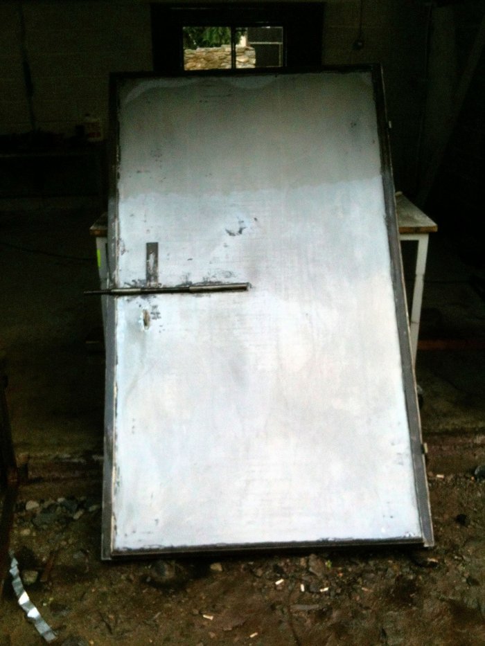

Painted it on with brush, had a few rough bits so used a pot scourer and left for 5-10 mins, ran the pot scourer over a few more times and flushed (from a distance) with lots of water from the garden hose
heres the result, had to run the wire brush over one or 2 spots but it fell off.
Anyone who has tackled with this in the past will know what a PITA it is.
