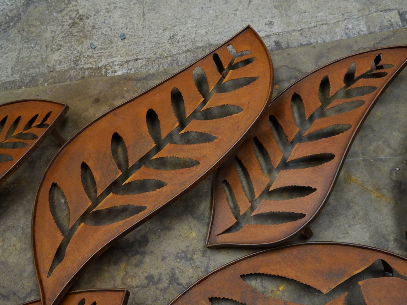

I have to make fifty of these, oh joy. I love freehand plasma work.
the cutouts are 600to 800mm long
The leaves are cut out of 1.6mm HR mild steel.
There is a fair bit of dross on the backs of the cuts it comes off fairly easily with a small cold chisel and a smart tap with a hammer; and they may want the leaf cutouts as well.
tap tap tap tap etc etc about twenty minutes per piece not hard but tedious and there is a skip load of it to do

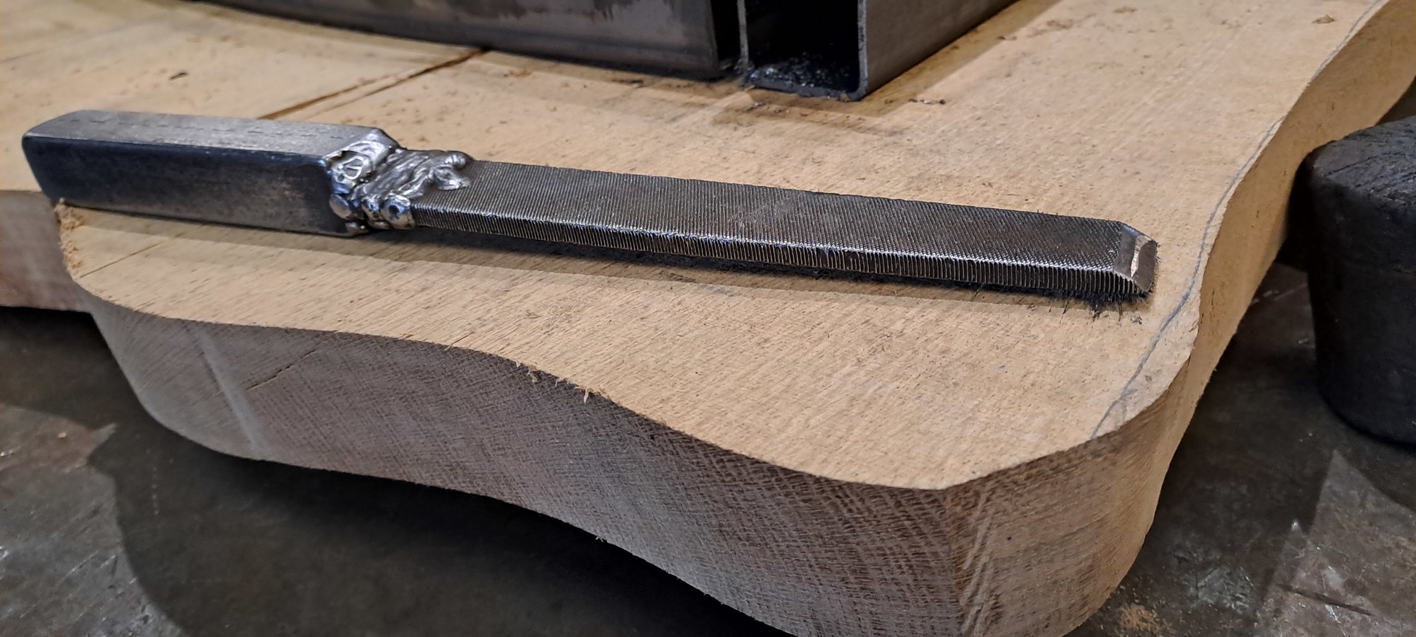

would an air chisel do the job without destroying the piece?
or any other tool?
ive had some success with a bike sprocket mounted in a cordless drill but there must be a better way
