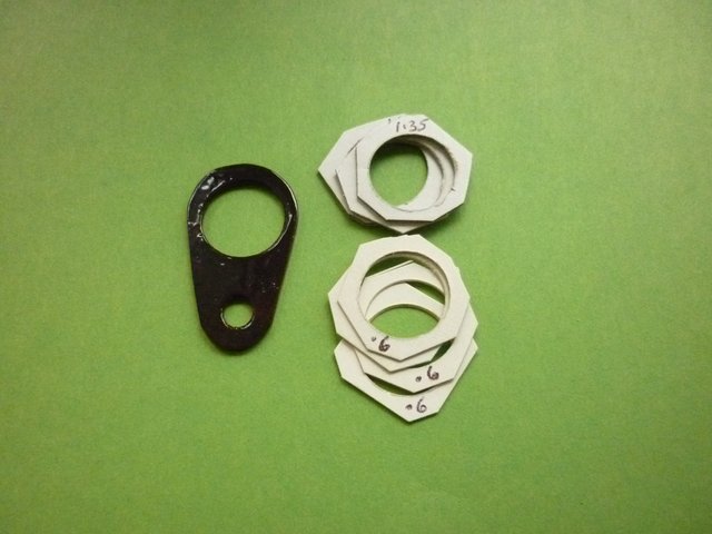

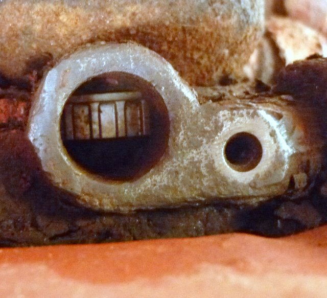

Inserting the sensor as far as it will go in to the hub (presumably the point at which the sensor is touching the ring) then there is a gap of ~1.5mm between the underside of the sensor shoulder and the hub. So to give a clearance to the ring of say 0.5mm, the 'shim' would need to be ~2mm thick.
The sensor is all plastic. The video in post 45, and ajlectronics' data clearly show some vehicles have shims. I'm not expressing any sort of opinion on how ABS sensors are/should be used, simply seeking advice on the seemingly odd situation I'm dealing with.
