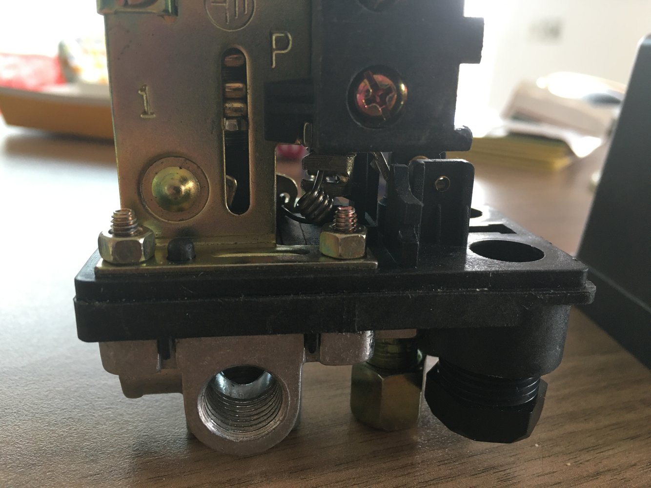

The unloader only works if you push down the switch on the compressor to stop it or you let it reach full pressure before switching itself off.
