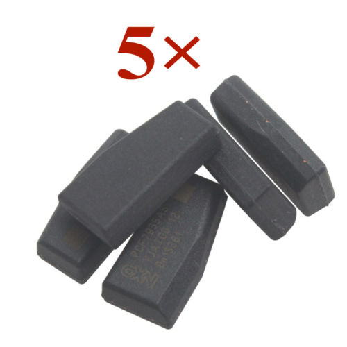

I have a programmed key and a standard key.
The program key is for programming a second or third normal key which immobilises the immobiliser.
So if the programmed key goes duff I can still immobilise the bike and still start the bike with the normal key.

not bad £3000 hrThe remote is pre set it won't lose the code, it's the car that learns the code not the other way round that's why you have a set pattern of things to do on the car to get it to accept the remoteyou have sbout 5 minutes after you remove the battery iirc, then it ma or may not hold the code
Fords used to come with a red master key to allow you to program new transponder keys insert red key ignition on / off remove master insert new key ignition on and it was programed,not sure if that's still the case vauxhals you can buy opcom for around 20 quid and it does just about everything on the carIts the PATs programming that tends to be dealer only, since that part still works you only have the remote fob to program up and that tends to be fairly user friendly, worth checking on a VW specific furum for the procedure, although for my galaxy which is VAG group the procedure is in the user handbook.
