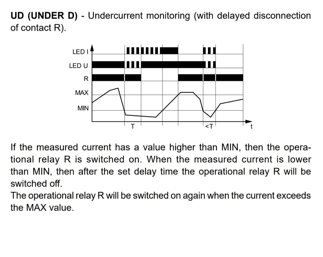

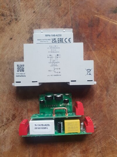

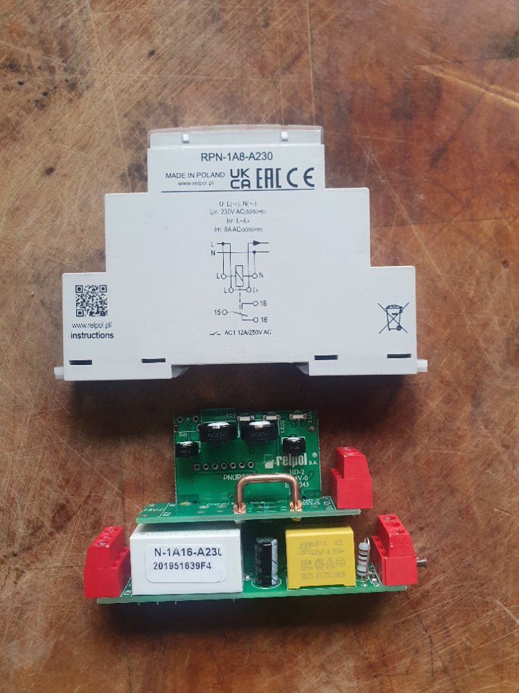

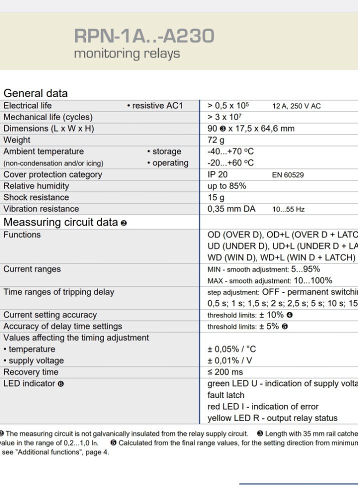

Oh yeah that wouldn’t help!!I'll have another play with it over the weekend and see if I can figure out exactly how it works.
One thing that doesn't help is that it has 6 functions but 11 or 12 clicks on the dial.
I'm not 100% sure what function I'm actually selecting..
We used to have pcb mounted rotary switches on some equipment that needed setting correctly, they had markings on but the only way you could ever accurately set the was to go back to zero and count the clicks. Go by the markings and they never worked properly!
