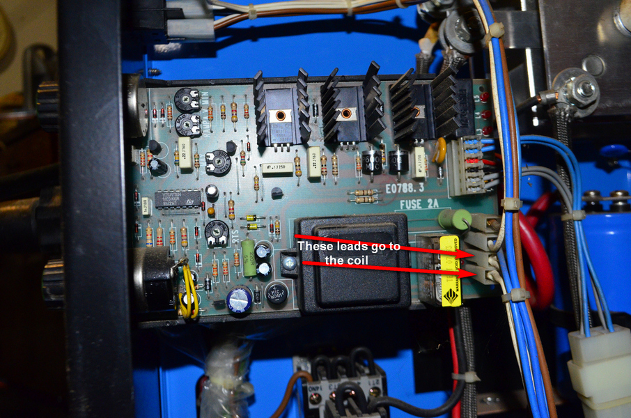

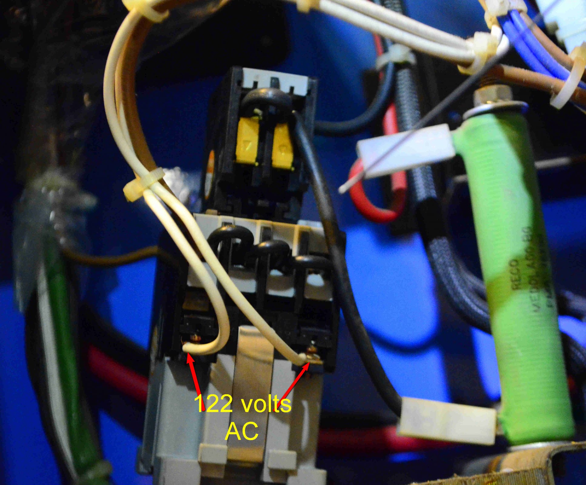

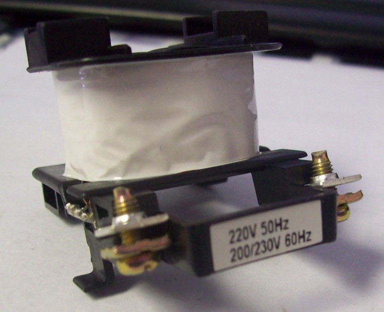

Mike, I did as you suggested and pushed in the contactor high output relay and when I pulled the trigger on the gun, the wire feed activated and produced an arc.
View media item 9079

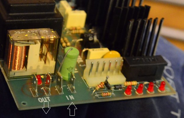

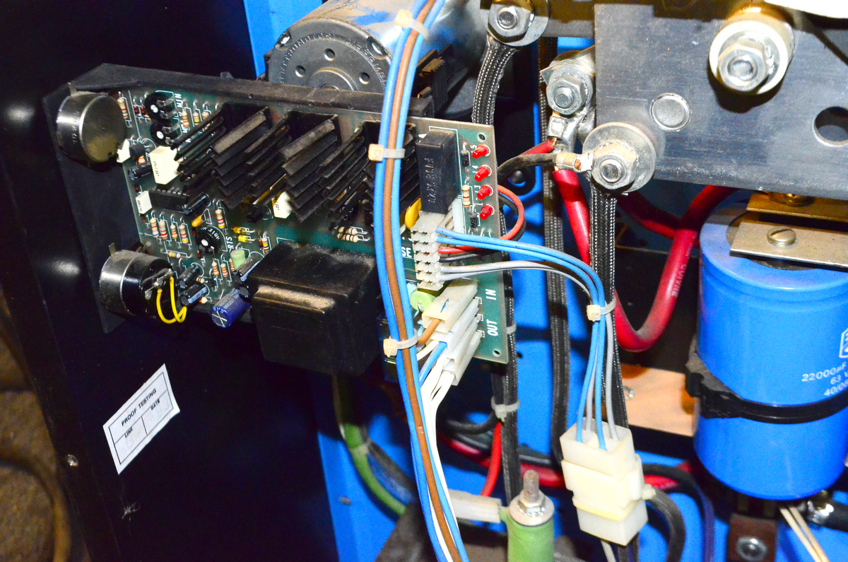

The PCB connects to the computer via the 6 pin junction and the 4 wires, 2 are out and 2 are in. What is it I'm looking for next?
This is an incredible forum!
auto correct ?

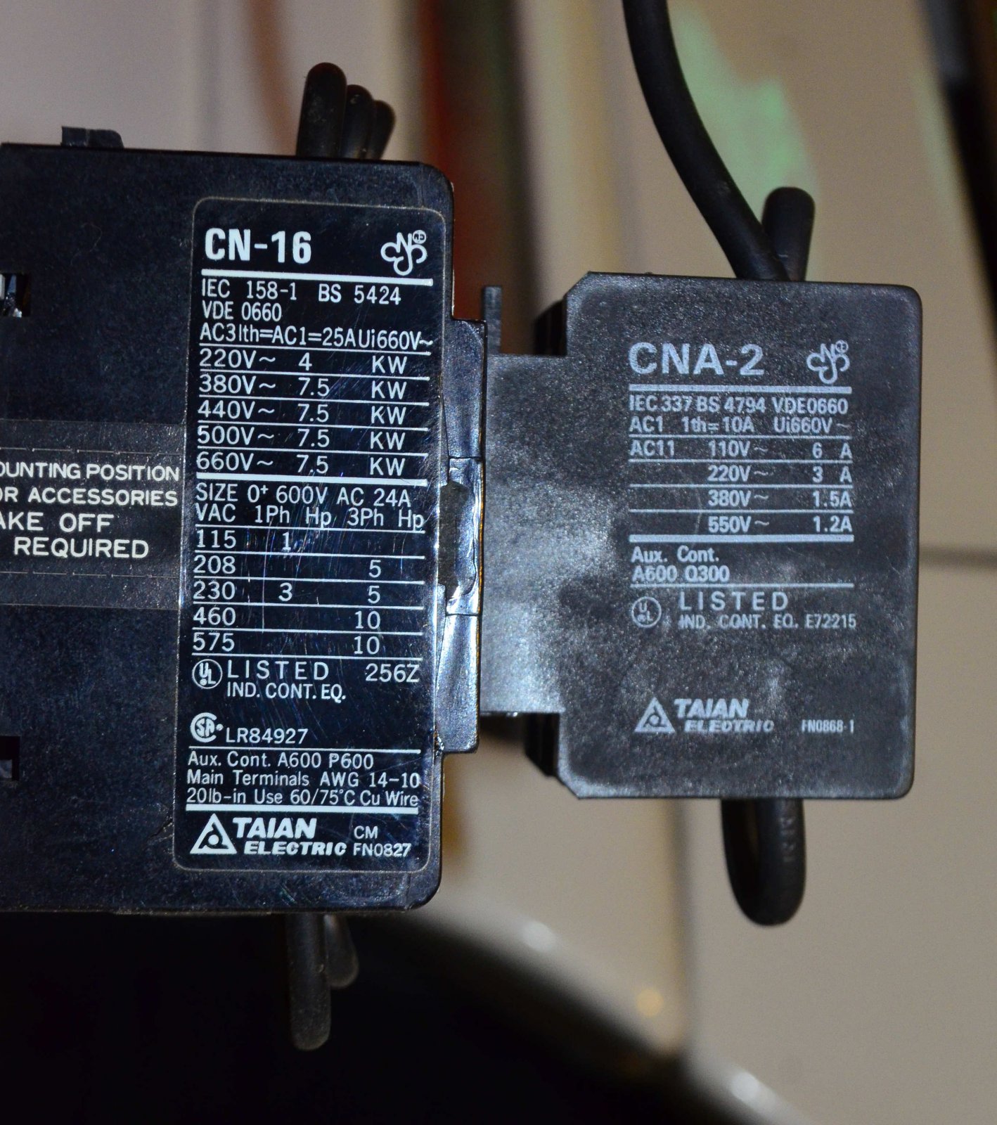

) is missing then there is a fault on the pcb or wires from pcb to contactor. Other reason is that the contactor is faulty. If you look at the contactor (which is just a big a55 relay) you will see there are several thick wires. These are the high current (and maybe high voltage) that the contactor has to switch on and off. There will also be a pair of thinner wires (think they are white on yours, pic not to clear), these are connect to a coil inside the contactor that when energized pulls the contactor in (on) and does what you did by pressing the button! If you put a meter on each of the two coil (white?) wires where they connect to the contactor and set your meter to AC volts, you should see on your meter a reading when you pull the trigger may be 12, 24, 48 110 or 220 AC depending what it is fed from. If you get none of these reading then try meter on DC but it is unlikely that it is a DC operated one as they are a bit more expensive as there is more copper in the coil !
