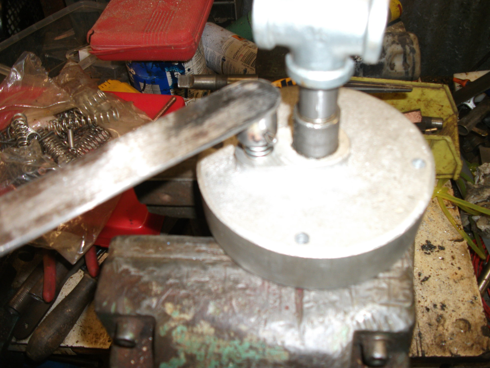

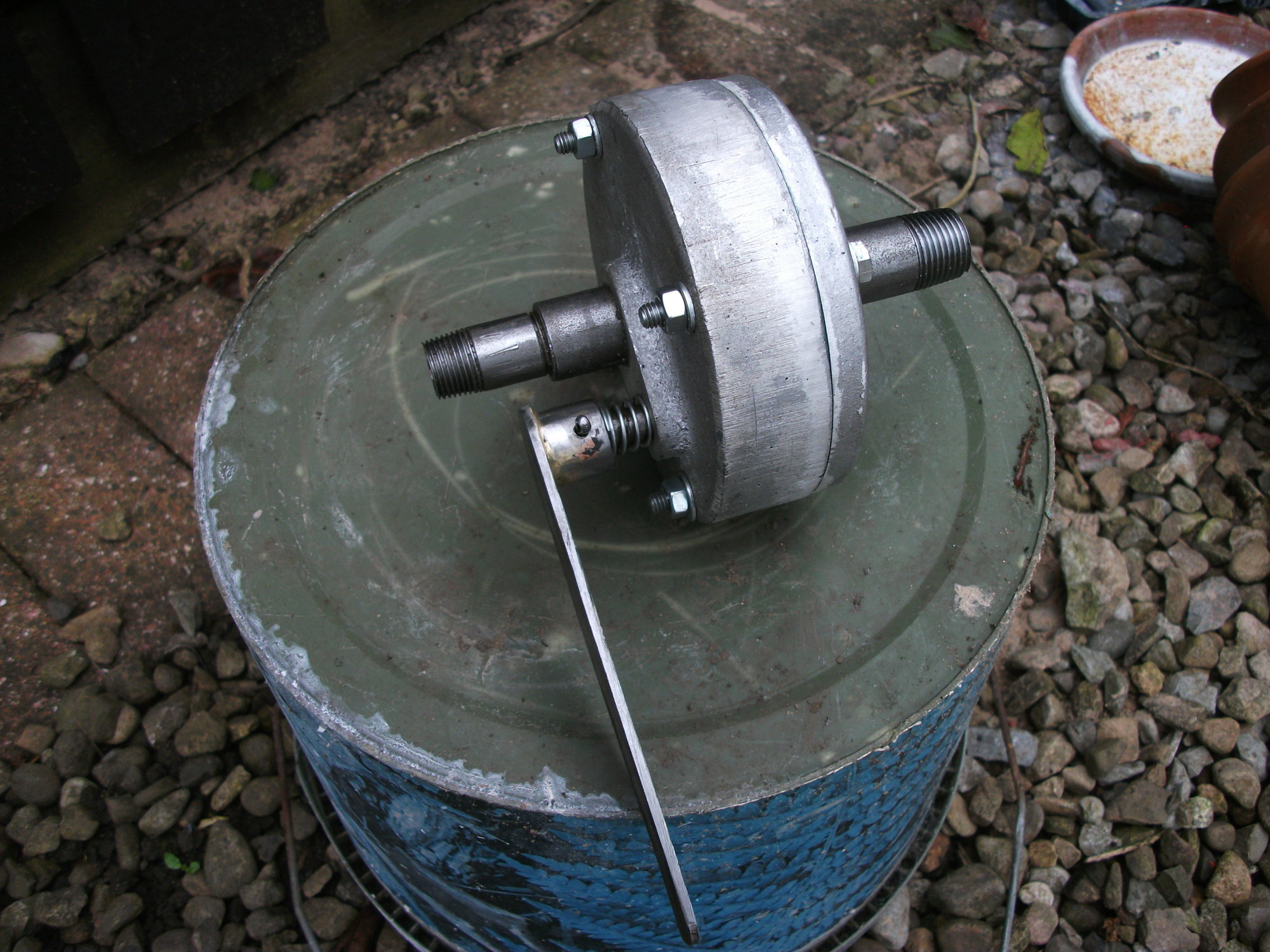

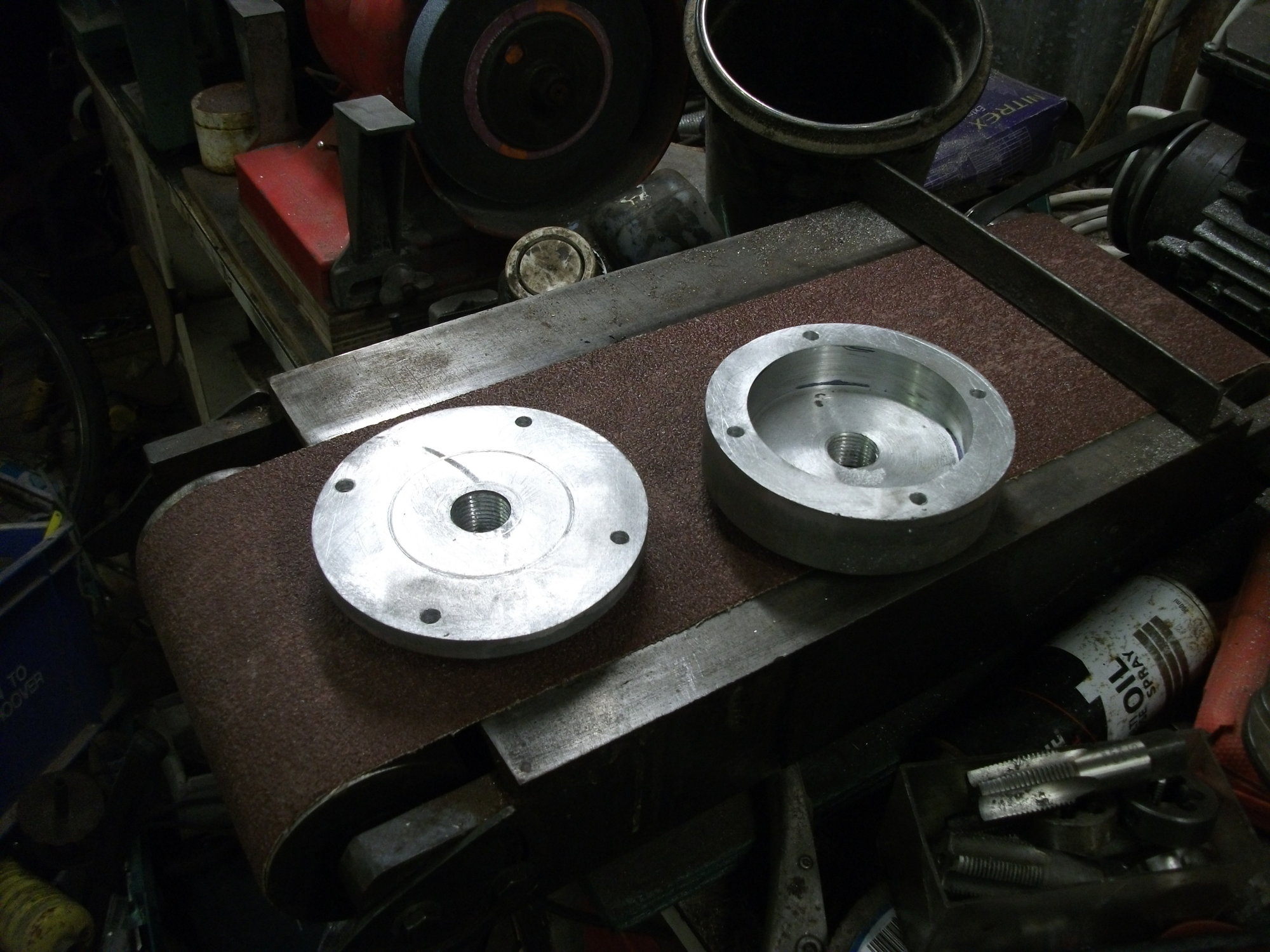

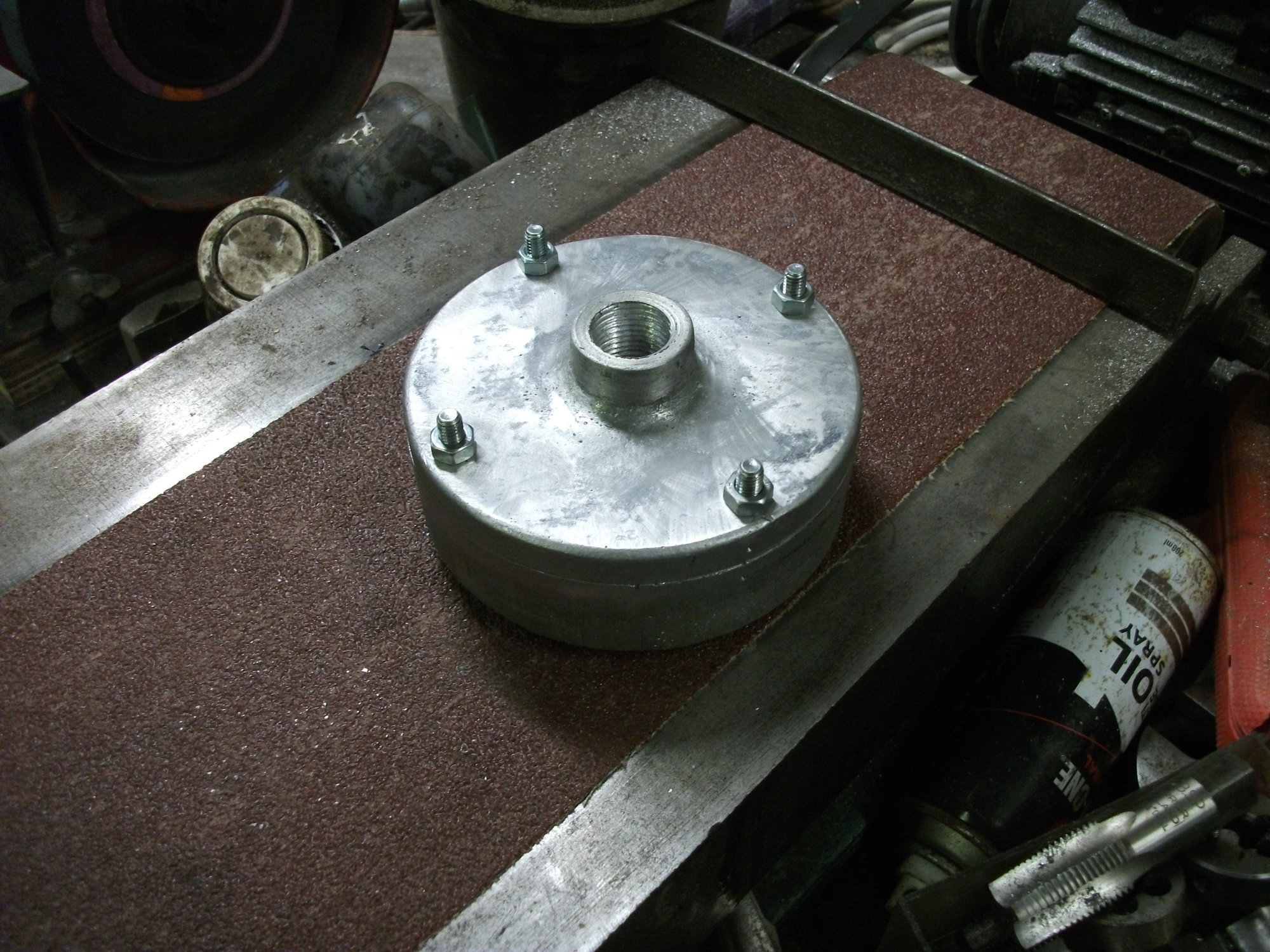

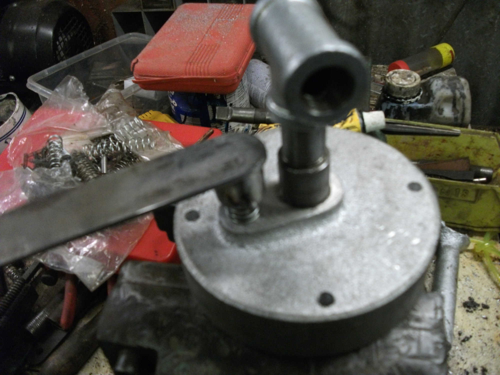

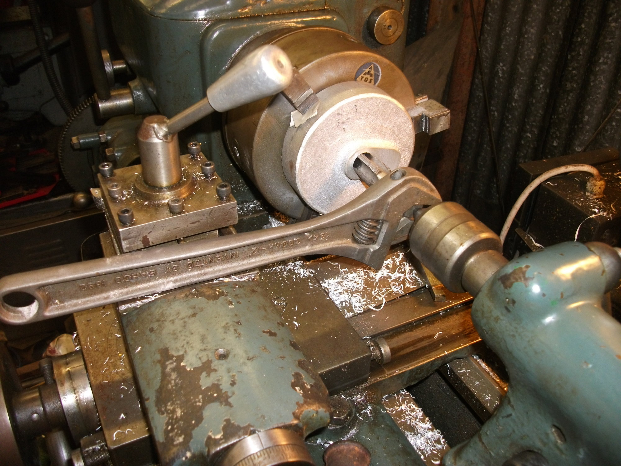

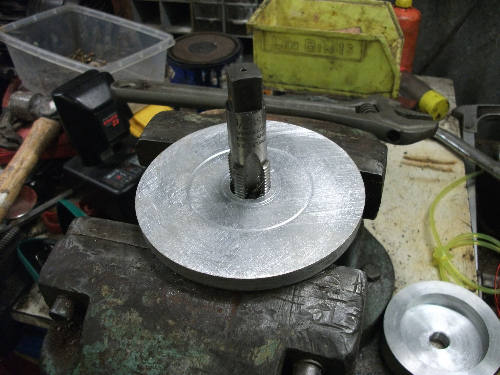

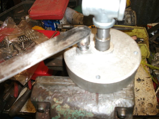

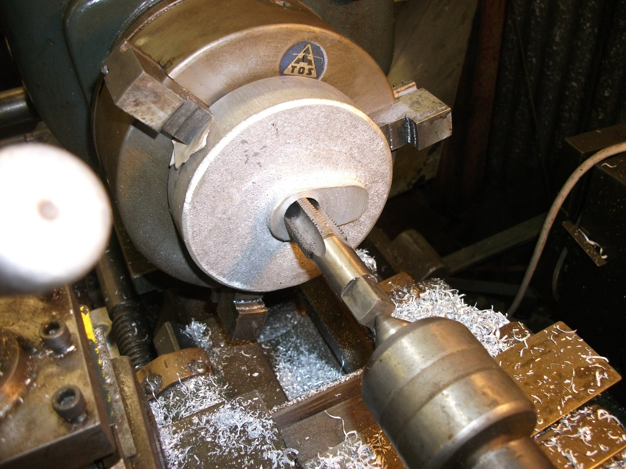

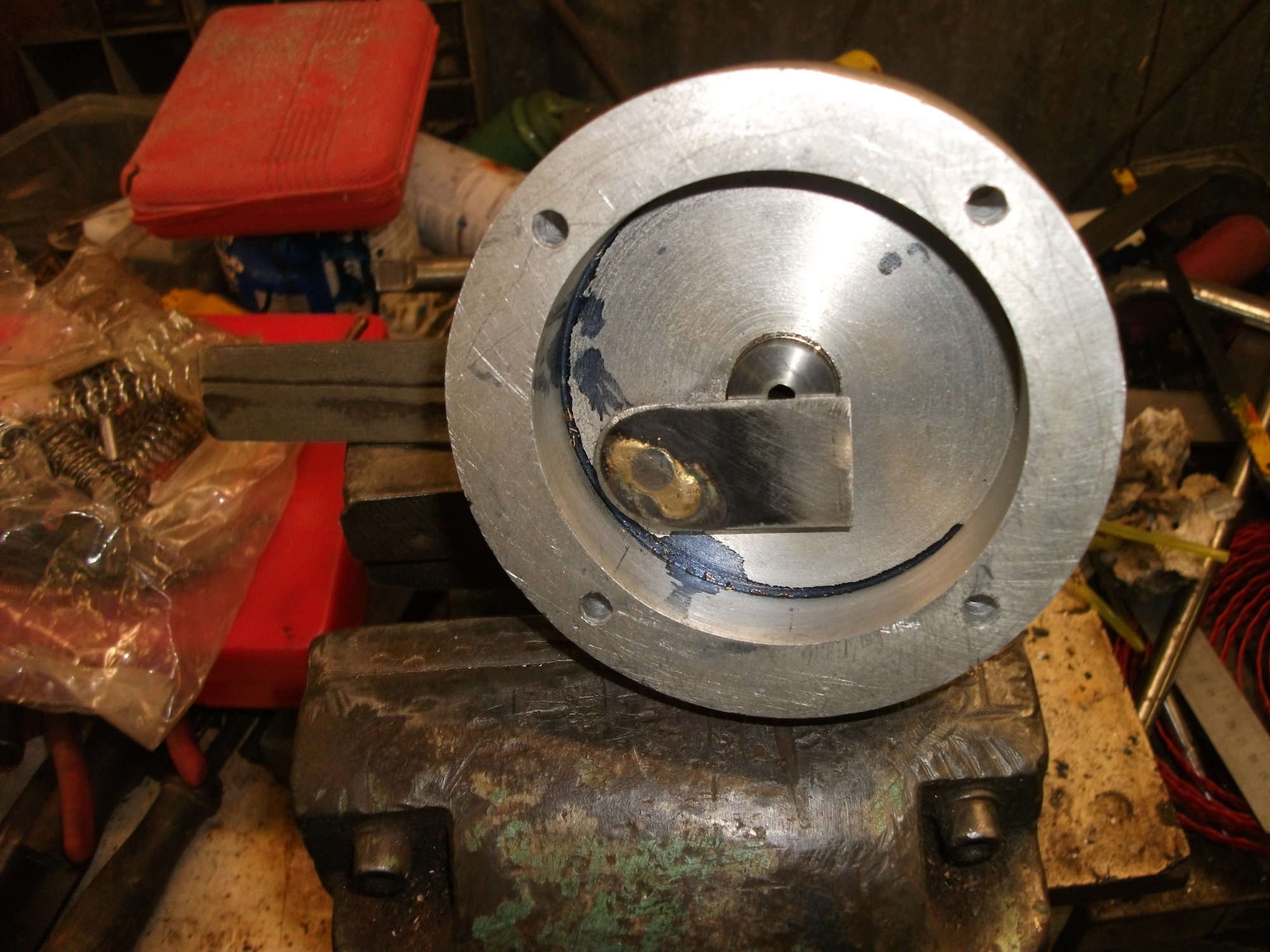

got conned by daughter in to making another one for her boyfriend . already made the wooden patterns last year and cast a few of them then cast them a few weeks ago gets a phone call is that valve made yet err no didn't know it had to be . anyway set to and got it mostly finished only need the flat valve to make and regulating handle and the outlet fitting to make . note the carboard packing in the 3 jaw to centralise it saves putting the 4 jaw on,it moved it over 25 thou and spot on
