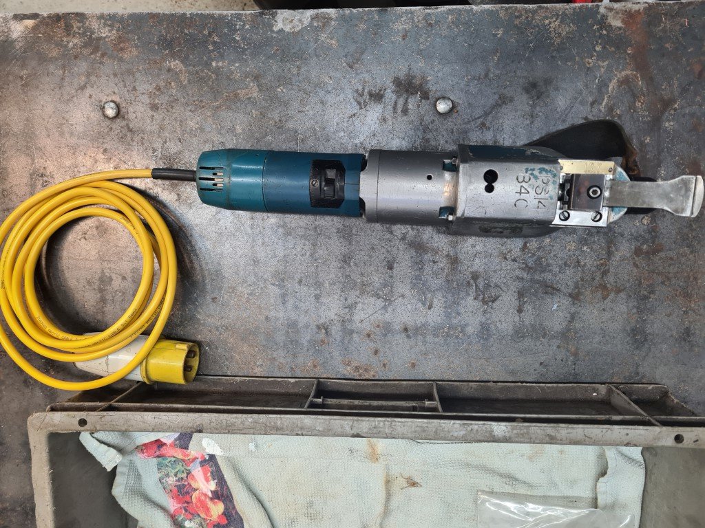

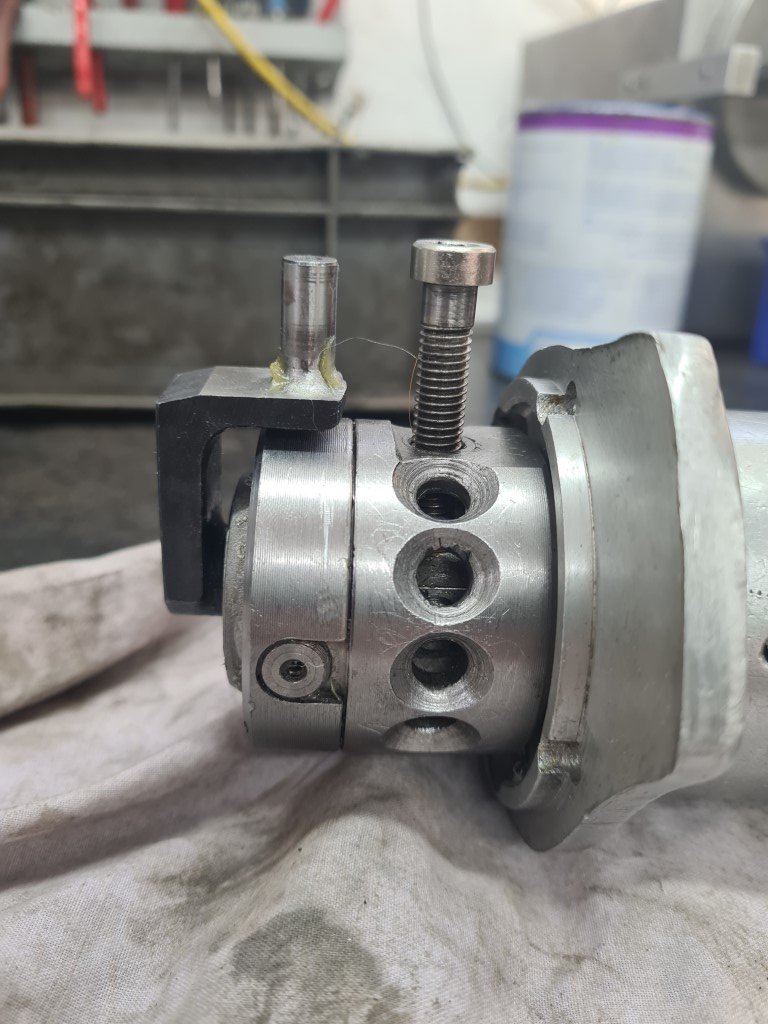

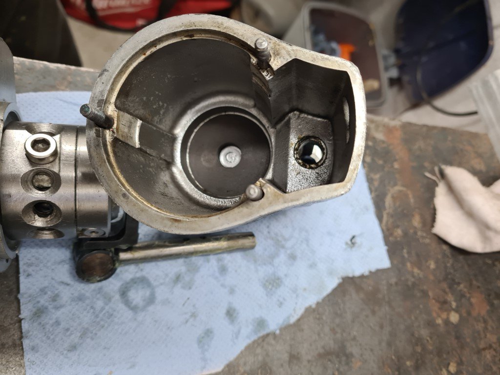

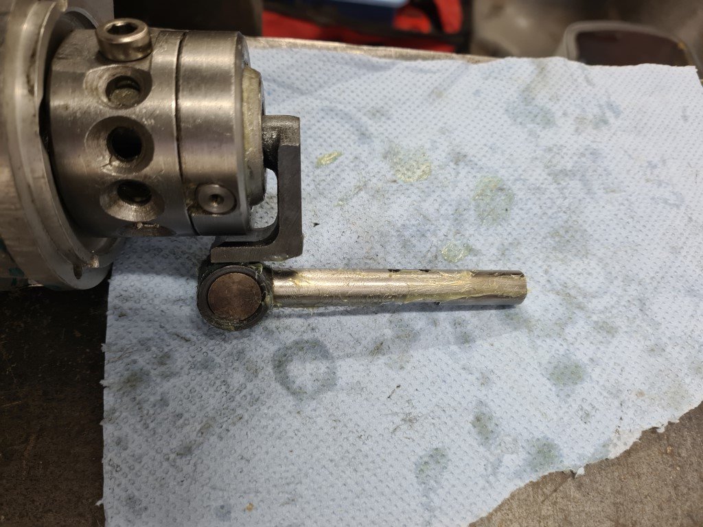

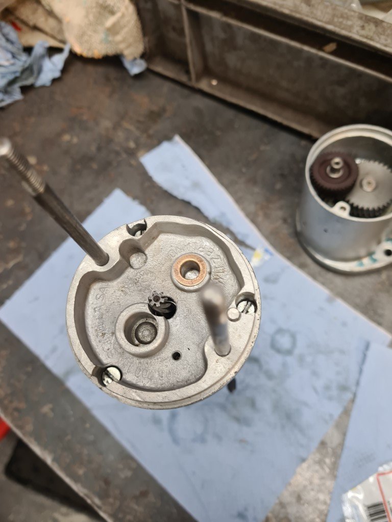

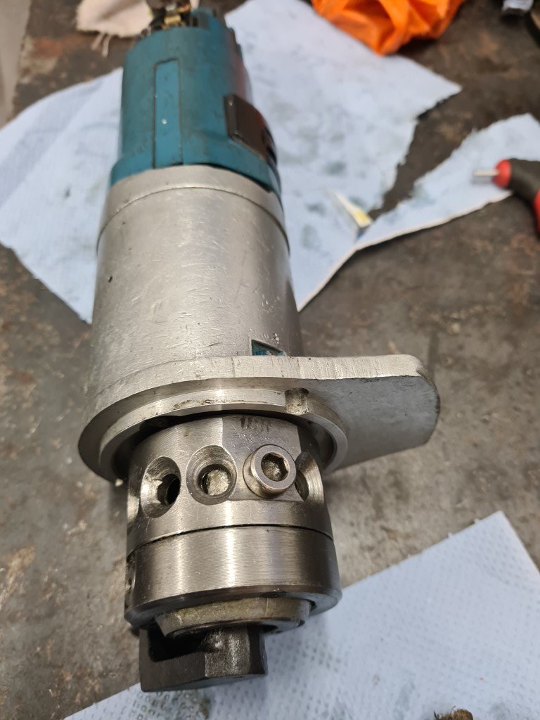

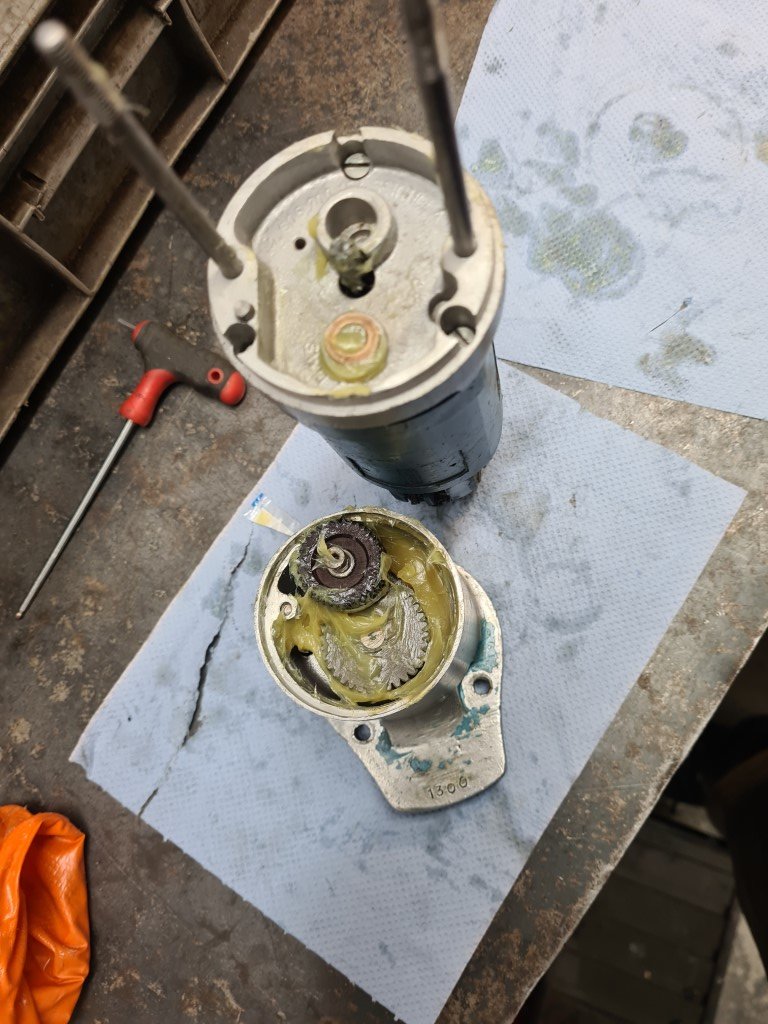

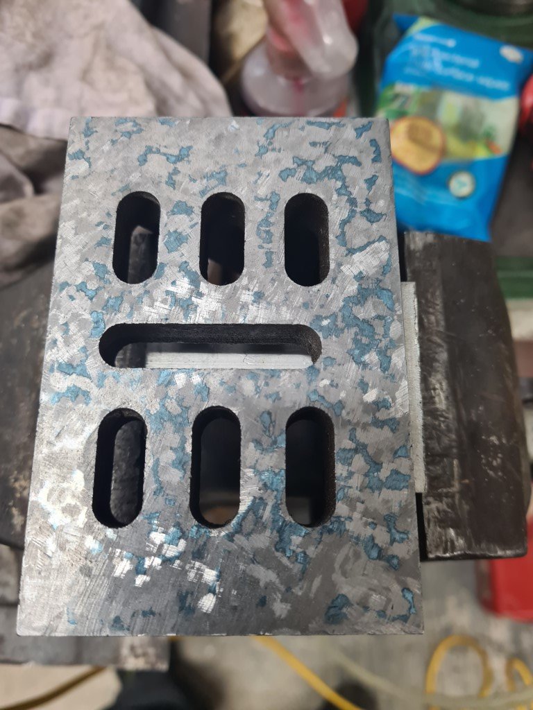

Just an update on assembling the wobble head. It turns out that the cage is "handed" i.e. it matters which way it is oriented when you assemble with allen bolt. If you get it 180 degrees out then when you adjust the stroke of the blade it goes the wrong way and won't adjust properly.
So to get it the right way round you need the castle nut end of the allen bolt to be aligned with the flat side of the cage as per the pic below. In this orientation the spigot should be parallel to the bolt when screwing in.
Cheers,
MM
