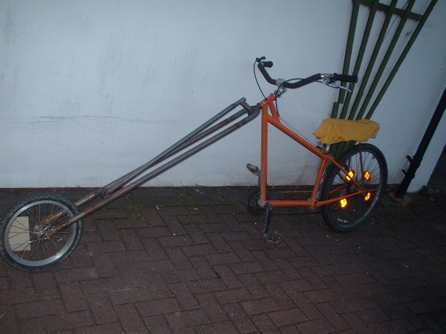

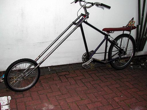

Watch out for raking the front too much, they reach the point of wanting to flop about all over the place. If you want longer forks lift the front end as well.

A good tip, tack the head tube on, fit a back wheel and use a pole to get a feel for the length of forks needed.
Examples of fork length and rake
Dr Hannibal.
Rides like a dream nobody has ever crashed this one.
Foxy Lady we went for a really raked head tube.
Rides like a pig, all over the place and no ground clearance
If we had raised the front and kept the long forks we would have been fine.
