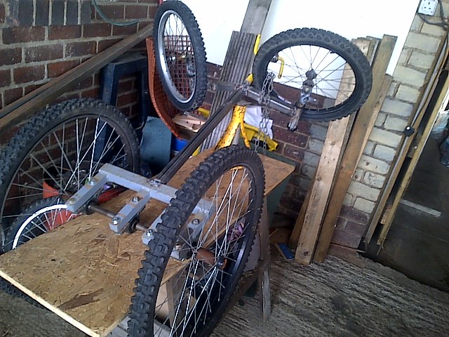

got morning off as no exams till this afternoon.
so thought i would make start on my 6 yr old sister's next bike.
it's a recumbant quad, going to be putting adjustable position seat on.
already fitted adjustable front boom by welding seat tube to frame then welding a crank to seat post, giving me 6" of adjustment.
it is upside down in pic as was on bench having steering tabs welded on.
