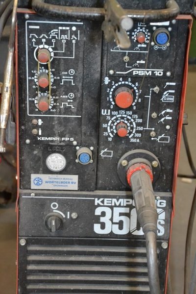

Well if the Kemppi RA230 list 11V as a no load voltage, that means it drops even lower under load.
 but how much it will drop by depends on the machine's design and how much wirespeed you're running through it. The higher the amperage draw, the more the load voltage will drop, to a point. It should be a "constant voltage" process, but in reality it isn't quite, especially for a transformer.

6.2. Automatic cycle welding
In automatic cycle welding (Pat. No. 46465), the welding wire feed is not continuous but pulse-free. The length of the welding cycle is controlled by the adjustment knob (A) on the front wall or by the cycle time remote control, which is connected to terminal G.
Selection is made with switch B. During a fixed pause, the melt solidifies and the continuously flowing gas promotes the cooling of the weld melt. This method can effectively prevent puncture of ultra-thin sheets (less than 1 mm) and control welding even in butt joints with variable air gaps. The method typically uses welding power selector switches (D)
Might be just a timing circuit for tack weldingIf I am reading this correctly, the machine has some kind of primitive pulse function as well.
