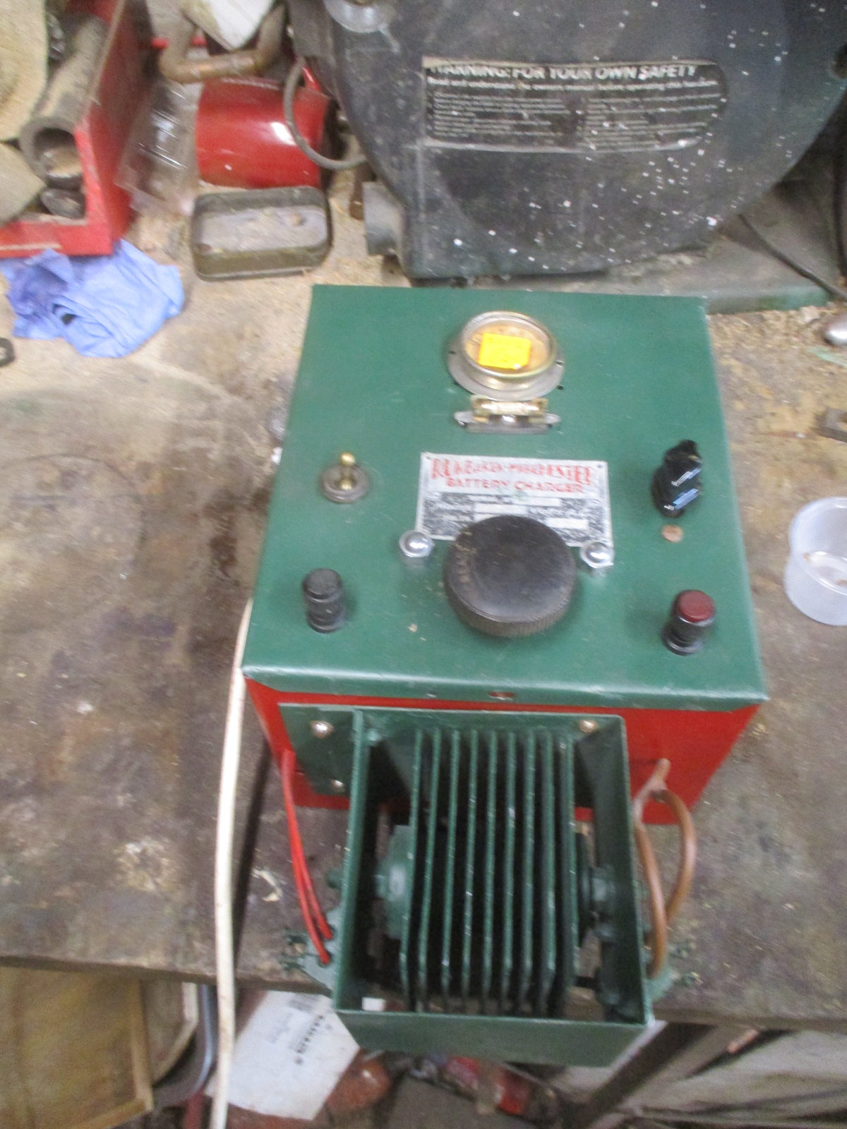

I don't know if it is relevant to your situation, selenium diode packs tend to burn out cell by cell and give odd readings while they do it.View attachment 249445
This one has gone wonky, not happy.
30VAC in then anything from 3.2VDC to 23.4VDC out.
Had it in bits, dusted of the AVO8. one diode has fluctuating resistance, one is stable until taped. The last 2 are good.
On Monday I will borrow the tools I needMonday a friend will borrow me proper tools to work on the board
