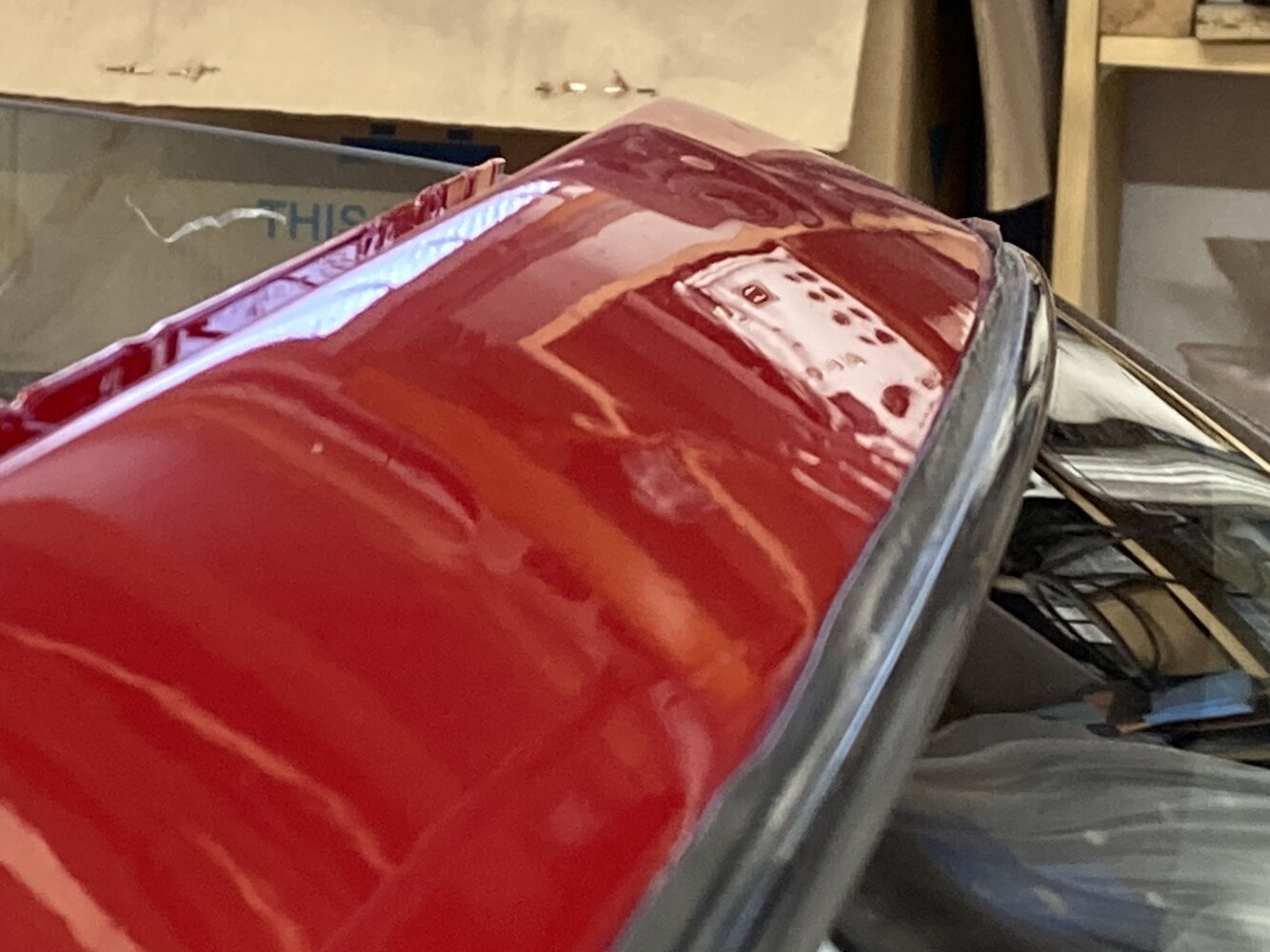

From my limited experience, it goes on quite thick. The first coat gave 100% coverage. Trying to go any lighter just gave a dry, rough surface.To me, only 2 coats doesn't sound enough
indeed , more paint you put on the bigger and deeper any stonechips will beNope. Excess paint causes issues, two or three coats of solid are adequate.

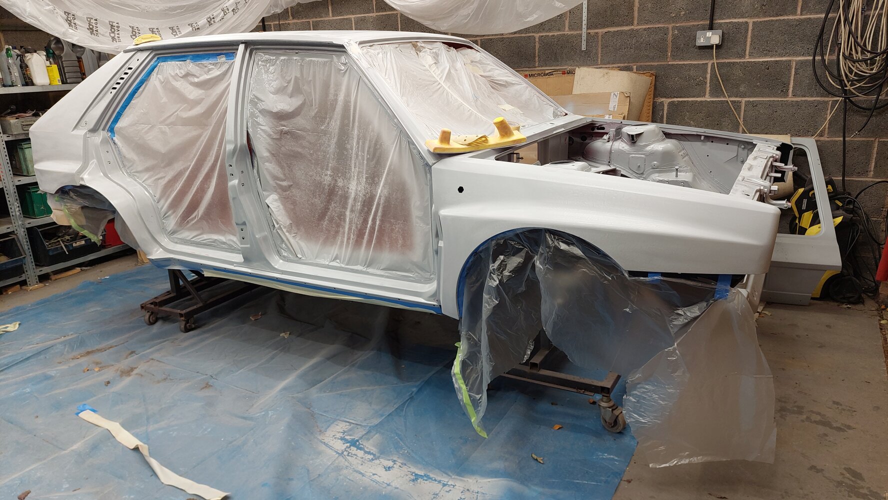

looks like a proper job , i would mask off that engine bay and do it on its own first , why not start on a few loose panels see how it goes ?
I'm planning on masking the exterior and paint the interior and engine bay first as a practice, before going onto visible panels. I'll post up some results when ready.
OK, I'll consider that, CheersI would do it the other way around if the panels are loose. Get the practice by starting on the easier stuff, as engine bays can require pressure changes and other contortions to get right. Panels by contrast are the easy parts.
