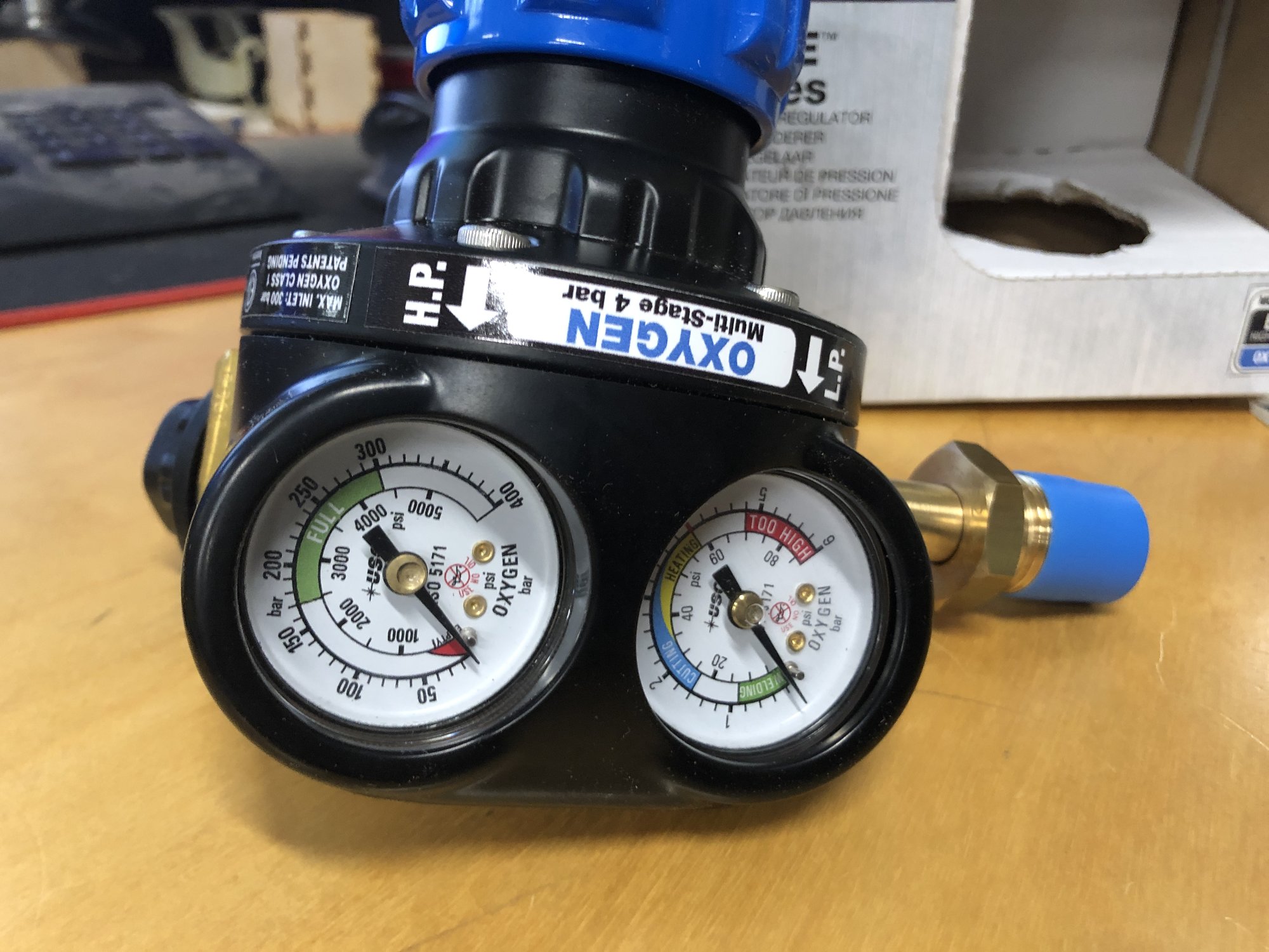

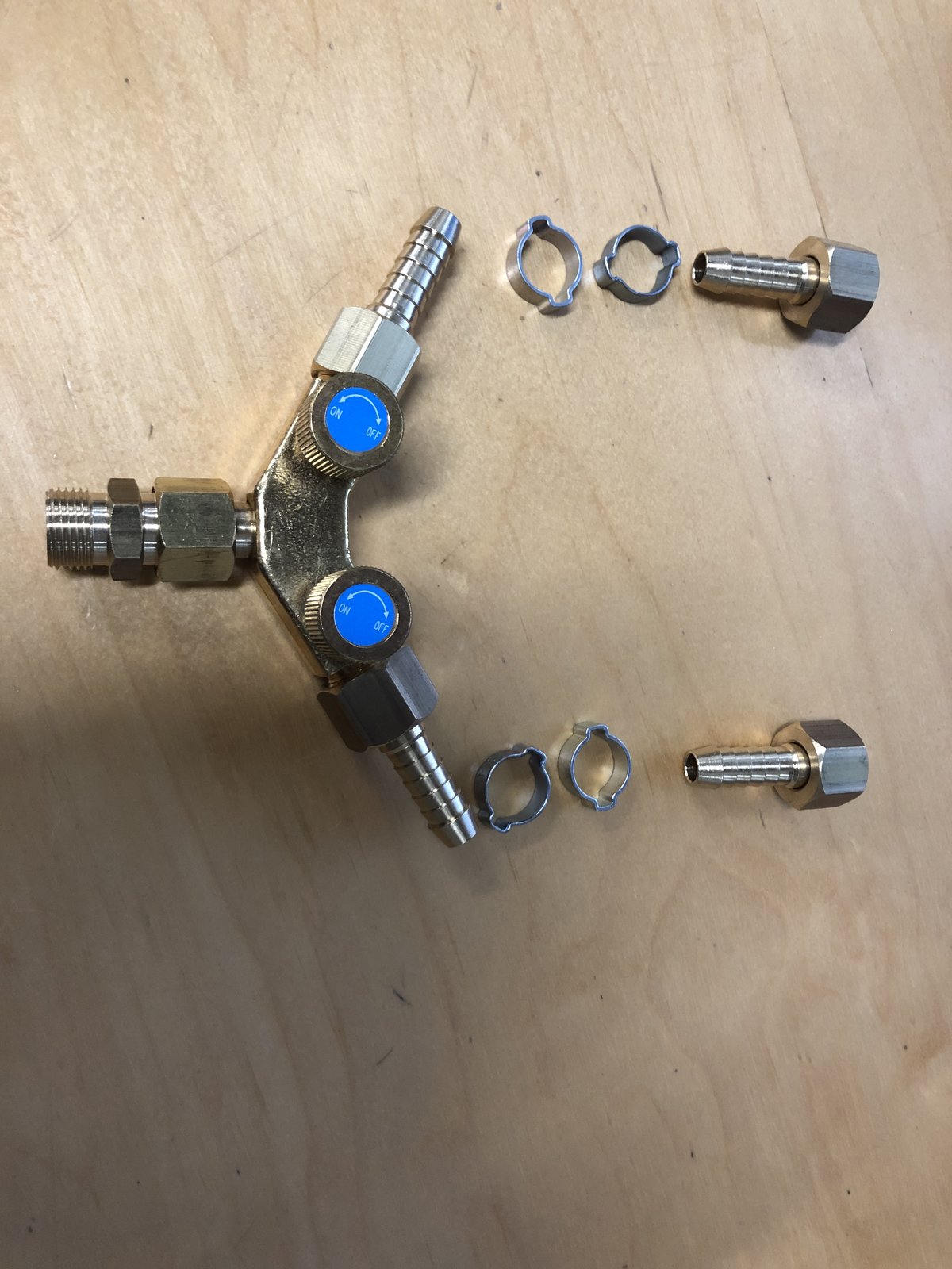

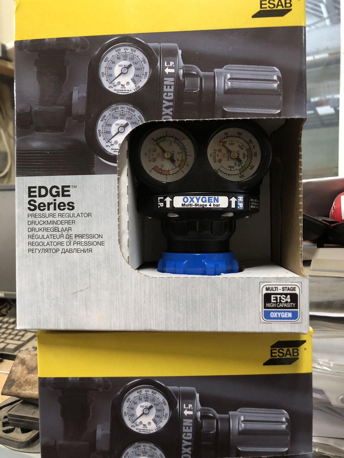

    Regs showed up today. They seem extremely well made, very heavy.

    Hope the Y piece is oil-free! Just a thought.

    I don't know but does it matter on the LP side?

    Umm.... probably. Give it a wash in hot soapy water and rinse it with the kettle would be my advice.
    *not a gas engineer, don't sue me etc, lol

    Yes it does... I'm not sure if Y peices are sold as specifically oil-free or not, but even LP oxygen will cause an explosion... it doesn't take much pressure at all, and it doesn't take much oil.
    Having said that, I like Hugh's advice :D
