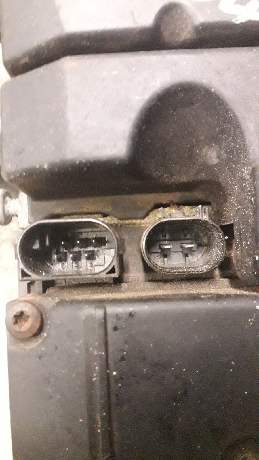

I know! Only paid £30 for the Webasto for use in my Mitsubishi Delica so didn't want to spend the same again on connectors.Quick goodle for Thermo Top wiring comes up with loads of suppliers of the wiring harness and plugs. Not cheap though
https://uk.rs-online.com/web/p/products/6801464?cm_mmc=UK-PPC-DS3A-_-google-_-3_Migrated_OldAccount_BMM-_-Migrated-_-+1++967616++1&matchtype=b&kwd-333643396054&s_kwcid=AL!7457!3!246281980077!b!!g!!+1 +967616 +1&gclid=EAIaIQobChMI16y2iNmY5QIVi7TtCh0TsQ6EEAMYASAAEgLGqvD_BwE&gclsrc=aw.ds
Six pin above .
Two pin is Skoda abs plug https://www.ebay.co.uk/itm/2-Pin-Connector-357973202-6N0927997A-for-ABS-Speed-Sensor-for-Audi-VW-Seat-Skoda/152699821031?_trkparms=aid=555018&algo=PL.SIM&ao=1&asc=57923&meid=b68e0e96febf448c8518b62b49006449&pid=100005&rk=1&rkt=12&mehot=pf&sd=143374375846&itm=152699821031&pmt=1&noa=0&pg=2047675&_trksid=p2047675.c100005.m1851
Depends on the model. Some just require positive and negative - thermotop c. Models such as thermotop z from discovery 3 and 4 are linked to the cars ecu and cost more to convert than a new heater.Do you have a wiring diagram? I've been thinking about fitting one but I've seen a few threads/articles that mention they can be a nightmare depending on how they were linked to the host car's electrical system.
