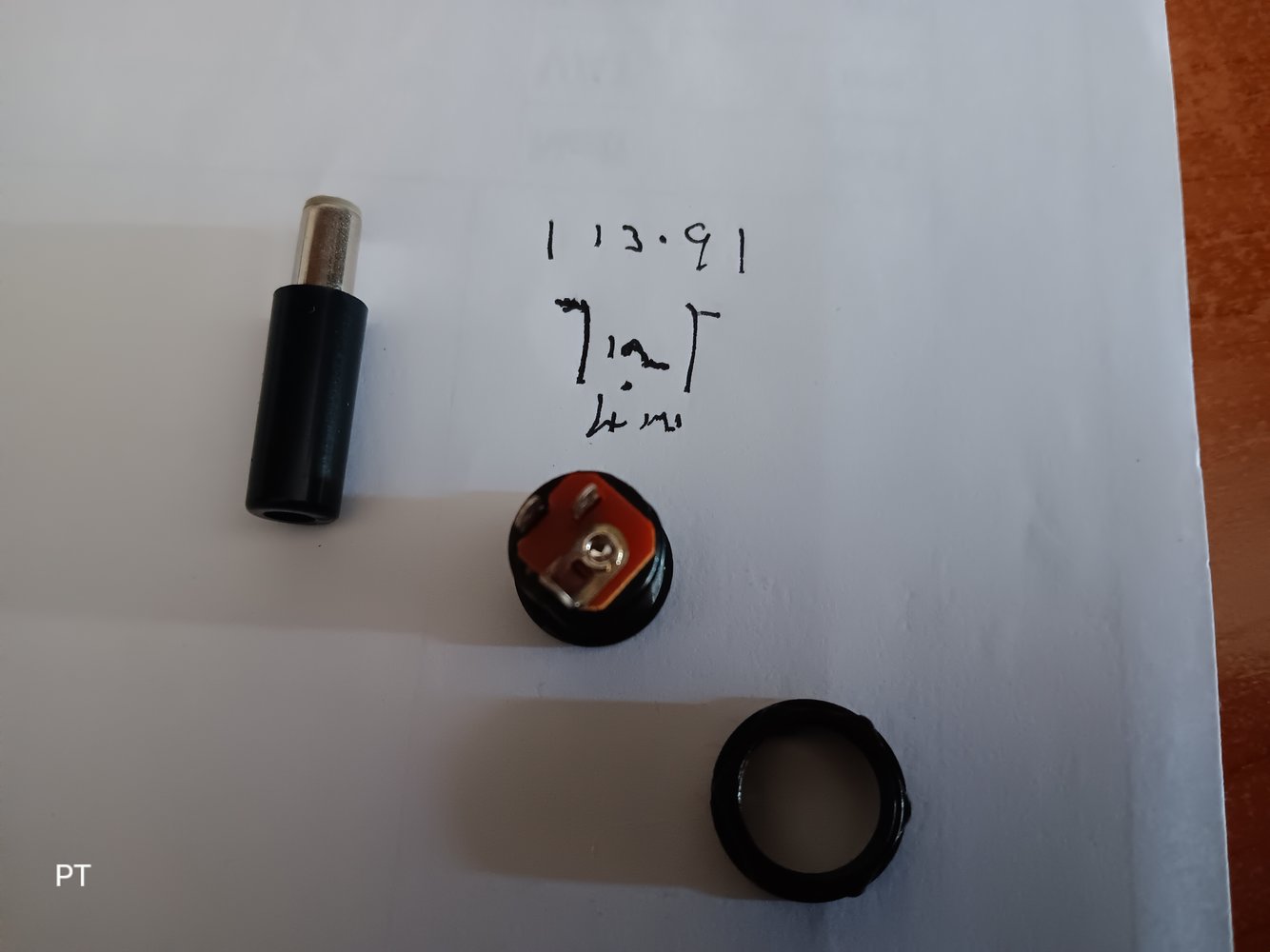

) are need longer plugs. Your new socket needs to match the length of the plug you have.

Hi, some experience with these - best to also measure the outside diameter of the plug then Google etc. Include words like PCB & Breadboard ..
Most I'm seeing have a 2.1mm pin, something to watch out for.![]()

Not sure if the 3 connections are standard layout, it's something else for you to check ...
Beware some sockets take "short" plugs, others ( including my laptop) are need longer plugs. Your new socket needs to match the length of the plug you have.

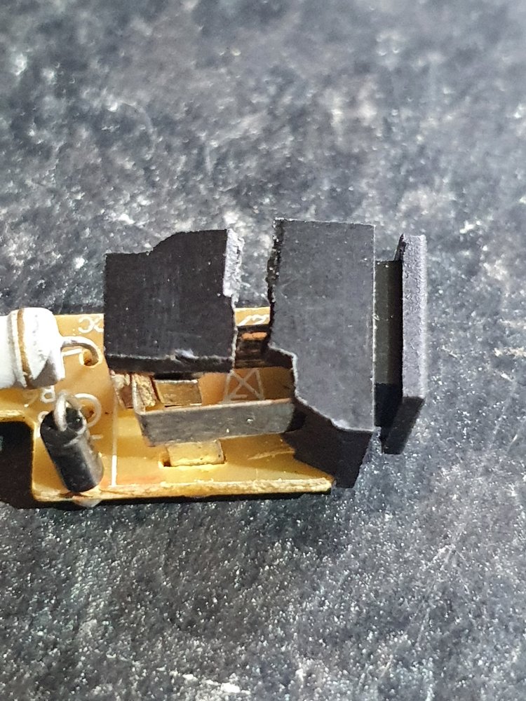

It may help if you tell us what it's from.

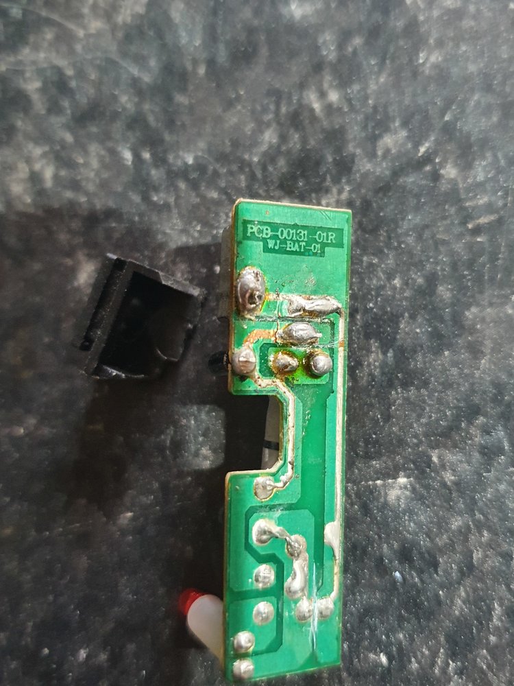

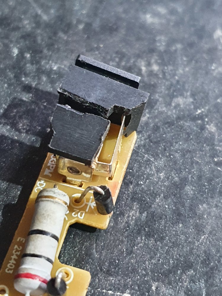

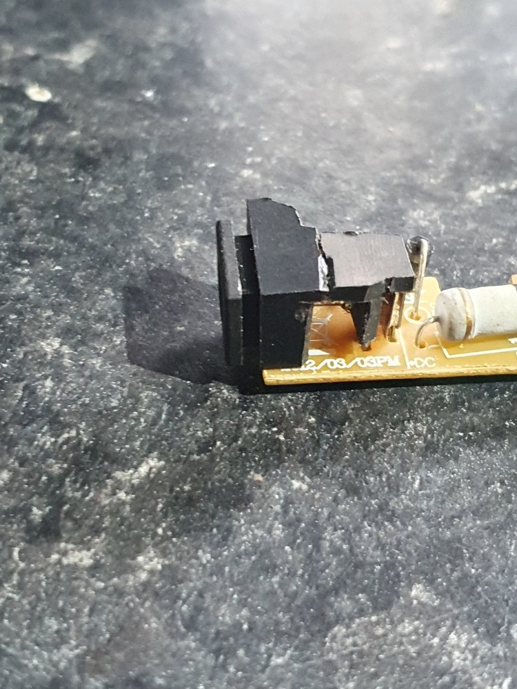

Its definitely a 2.5mm. Easy to measure as it's all smashed open!
The 2 central connections match spacing on others I have found but the 3rd is on the opposite side..
Its part of a horse massage blanket, This is on the power pack. Contains a 7.2v li-ion battery and that small pcb. You plug the charger in this socket. Then, once it's charged, plug a lead from the blanket into the same socket to get power back out.
Rather than swap one socket and 2 plugs I'll just see if I can find a compatible socket and mount it into the case somehow.
