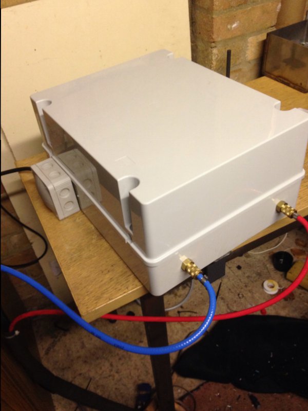

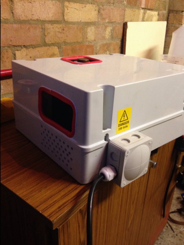

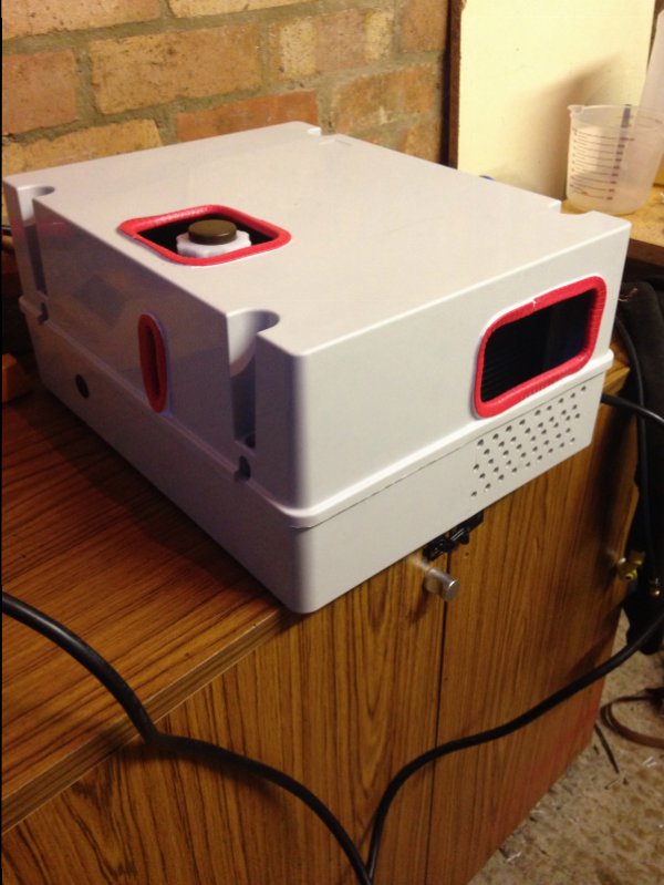

Cheers mate. Still a couple finishing touches to do. I'm cutting a hole in the top for filling and one on the side to check level and vents in back for fan then I'm going to fit a nice seal around the holes purely to look nice. Waiting for the seal to turn up now. More pics when finished to come.Well done that Man " that's a cracking job !

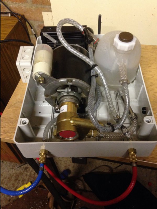

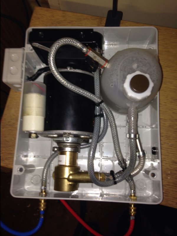

It was getting warm but now the heat is more contained there are 3 main points the air can get in for the fan but that little fan is cooling the motor and the rad and it's just not enough in my opinion. In fairness the water got to about 10-15 degrees which would not cause a issue and work just fine but for peace of mind id rather fit another fan blowing directly on the side of the motor to cool it further and keep it happy.Was the pump not getting warm with the lid on?
Does the motor draw in and expel air to cool?or is it completely sealed?
How much would you like for it. The max dimensions I can allow for are 120mm square and 30mm thick. It must be 240v also so I can wire it straight into the sealed box on the outside. I don't want any wiring done in the unit itself. I don't mind waiting there is no rush to get it finished I just won't let it go till I'm 100% it's fit for purpose. Cheers for that WMJ.That should work.
i was thinking of ducting to and from the motor to help it cool itself.would be cheap,easy but you wouldnt know if its enough.
