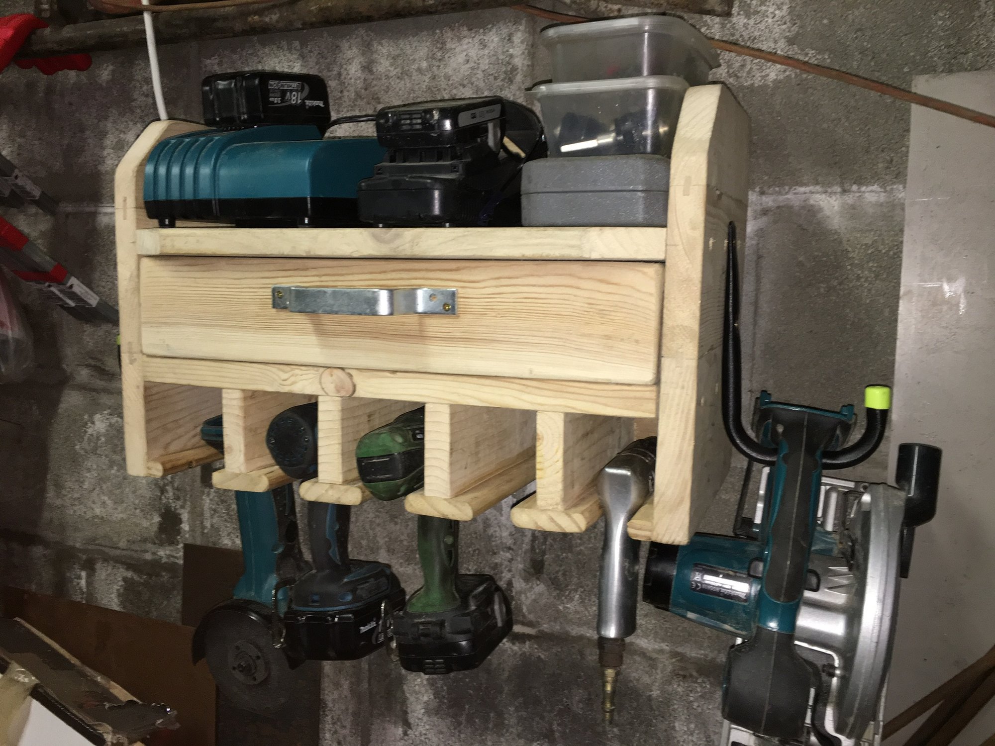

I got sick of hunting for stuff like blades and bits plus the chargers were in the office so decided to sort it out. There are loads of ideas on t'internet, this is my interpretation.

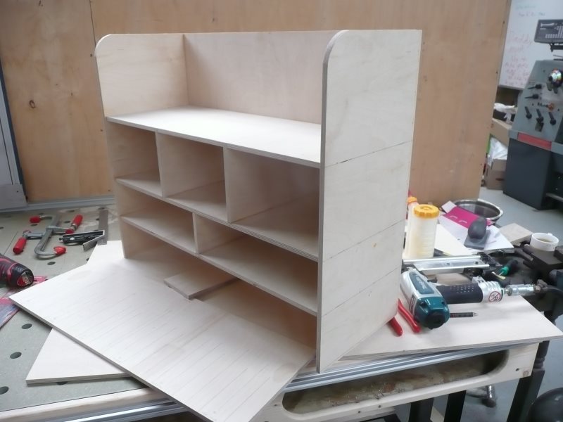

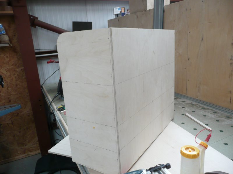

First knock up a cabinet, I over ordered on 9mm ply so used that but 12mm would probably be better.
9mm is bit skinny for dominoes and you have to fiddle about to get them centred so marked up the centre of the shelves and used the air pinner and glue. 35mm brads did the trick.

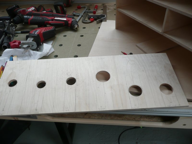

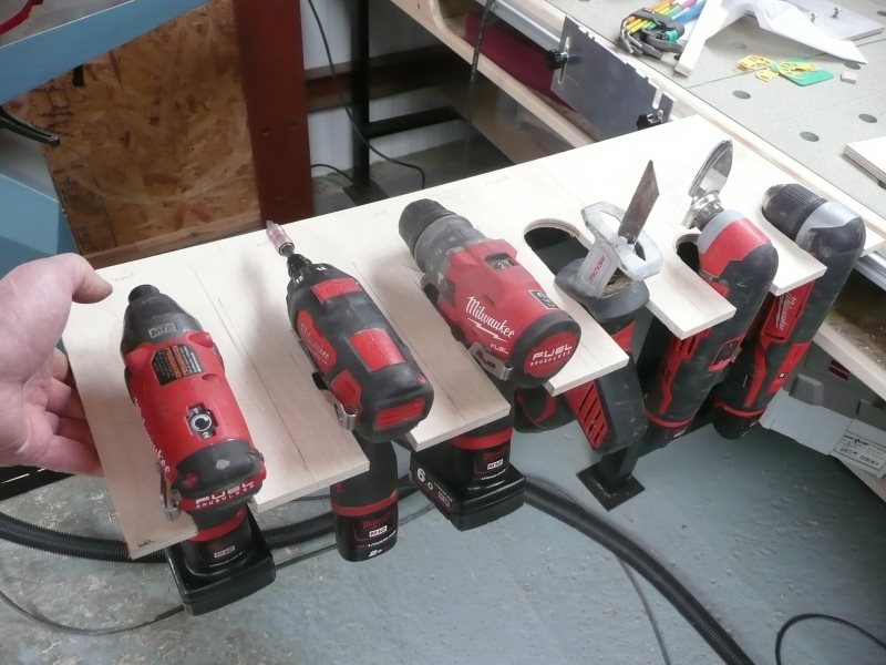

Mark out the bottom shelf for the tools to hang from and burn holes in with blunt hole saws.
Test fit the tools, not sure why the hacksaw slot was so long, I must have had a reason but it fits.

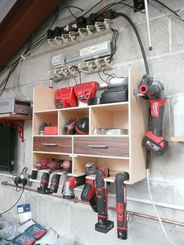

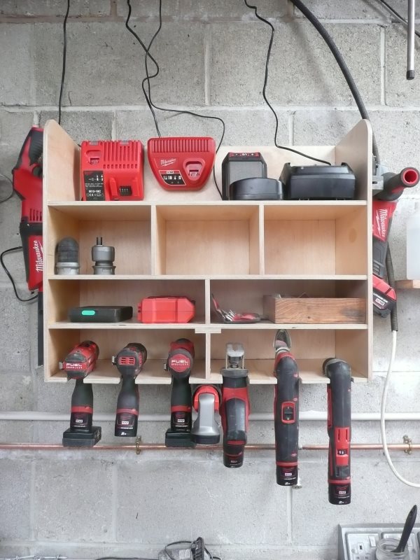

Fit the lower shelf, give it a couple of coats of Bona Mega water based poly, hang it on the wall and fix the chargers to it.
I found a bit of old plastic tube which I put between the drills and the hacksaw to hold the torch, this now shines down on the bench if I need a bit more light.

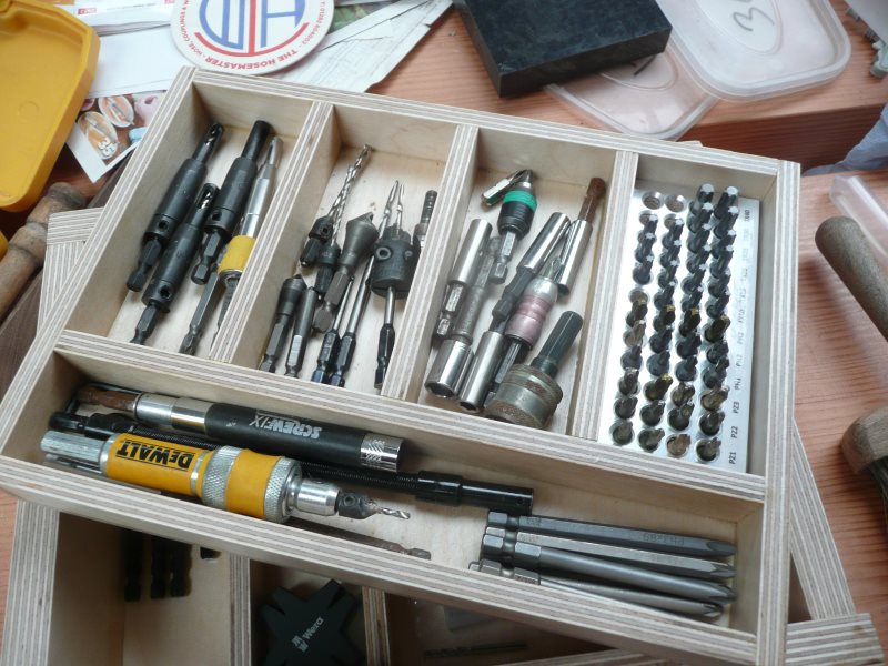

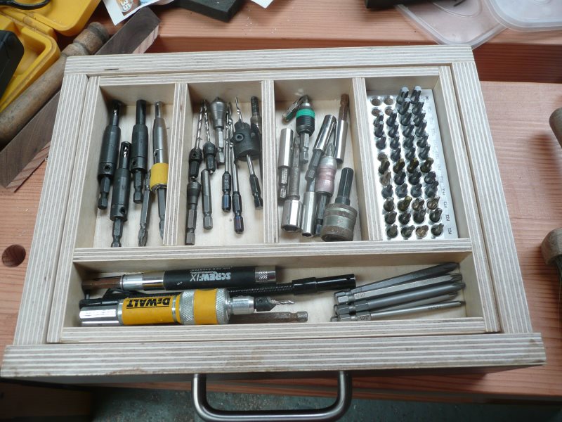

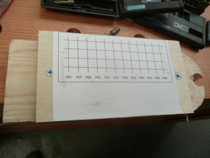

I put the grinder on the RH side and the asthmatic vacuum on the LH side. The charger for the power cap and the Stihl chainsaw also fit on the top. I'll make a couple of drawers immediately above the tools for blades, bits etc.
My old Makita NiMH stuff is relegated to the downstairs barn, I just have two drill/drivers. Saves me running up and down when I need a drill down there.
