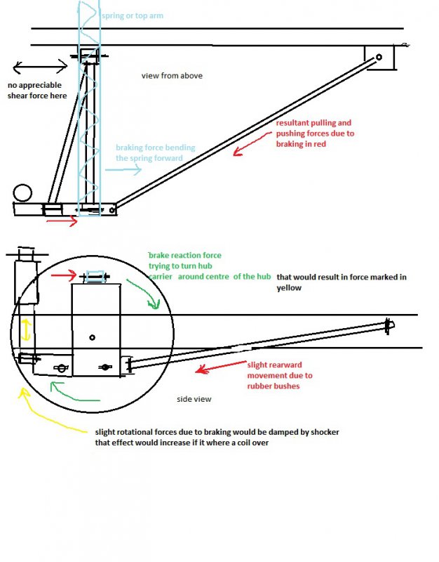

EXACTLY it would go into compression to stop the power reaction allowing the hub/ wheel to move forward within the wheel arch.
I did not mention torque reaction .

for saying this :- How come your seeing it's not in shear and everyone one else can't see it.
it's got me baffled
I did answer the original question in my first post 18 IIRCinstead of just answering your 1st question in a few posts
because the coil over becomes another telescopic link, it is pushing down off hub centre
you should know by now if u ask a question it either runs of at a tangent or goes to the far end of a fart and where it comes frominstead of just answering your 1st question in a few posts
and the combination of coilover position and top link removes a lot of the braking force IMO
