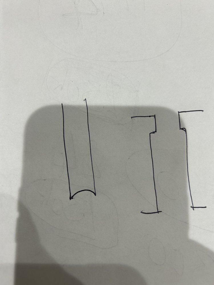

Yes, I've wondered about that, but never worked out how that could be achieved. With a really small grindstone on a dremel or similar, whilst turning in the lathe?One thing is to grind relief on the punch so there’s more shear action . With sheet material up to about 4mm this really helps
Would a bull nosed slot drill bit do it?Yes, I've wondered about that, but never worked out how that could be achieved. With a really small grindstone on a dremel or similar, whilst turning in the lathe?
Punch grinder or a tool & cutter grinderYes, I've wondered about that, but never worked out how that could be achieved. With a really small grindstone on a dremel or similar, whilst turning in the lathe?
