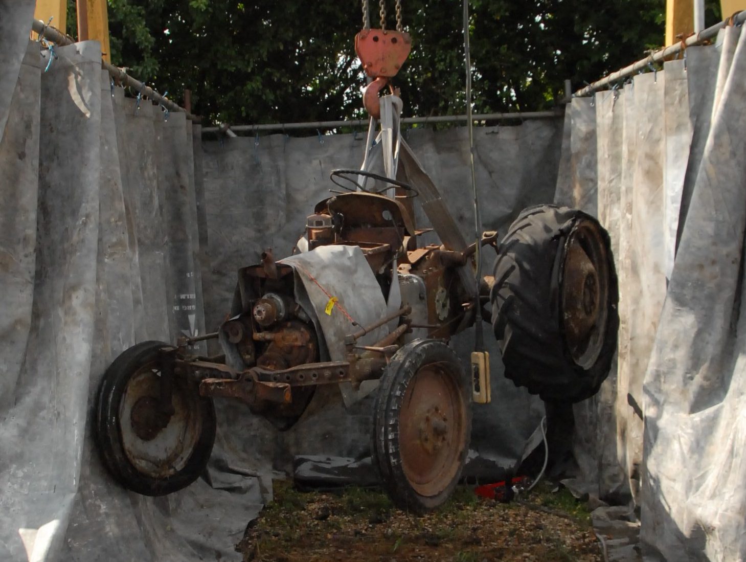

    Now I finish the Grinder I decided to re-visit an old project that I started last summer, Its an old little grey Ferguson tractor.

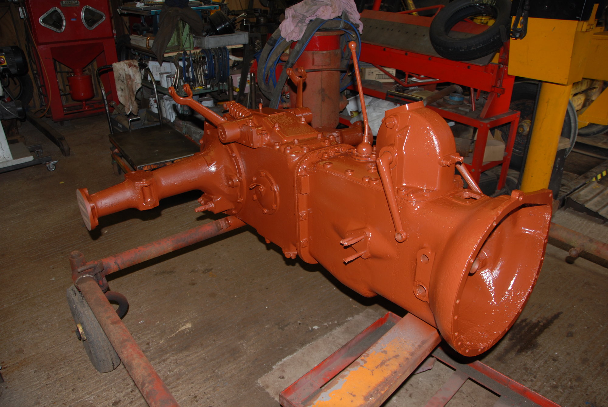

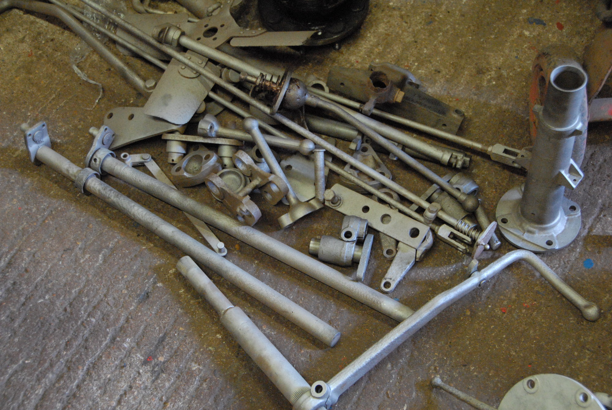

    Last time it ran was 35 years ago and was all seized and in a bit of a state when father picked it up for me, it really should have been scrapped but hey ho I like a bit of a challenge. It has a petrol continental engine and it was built in 1947. Once I had the engine running then get the sized gearbox off the engine, that took a while,

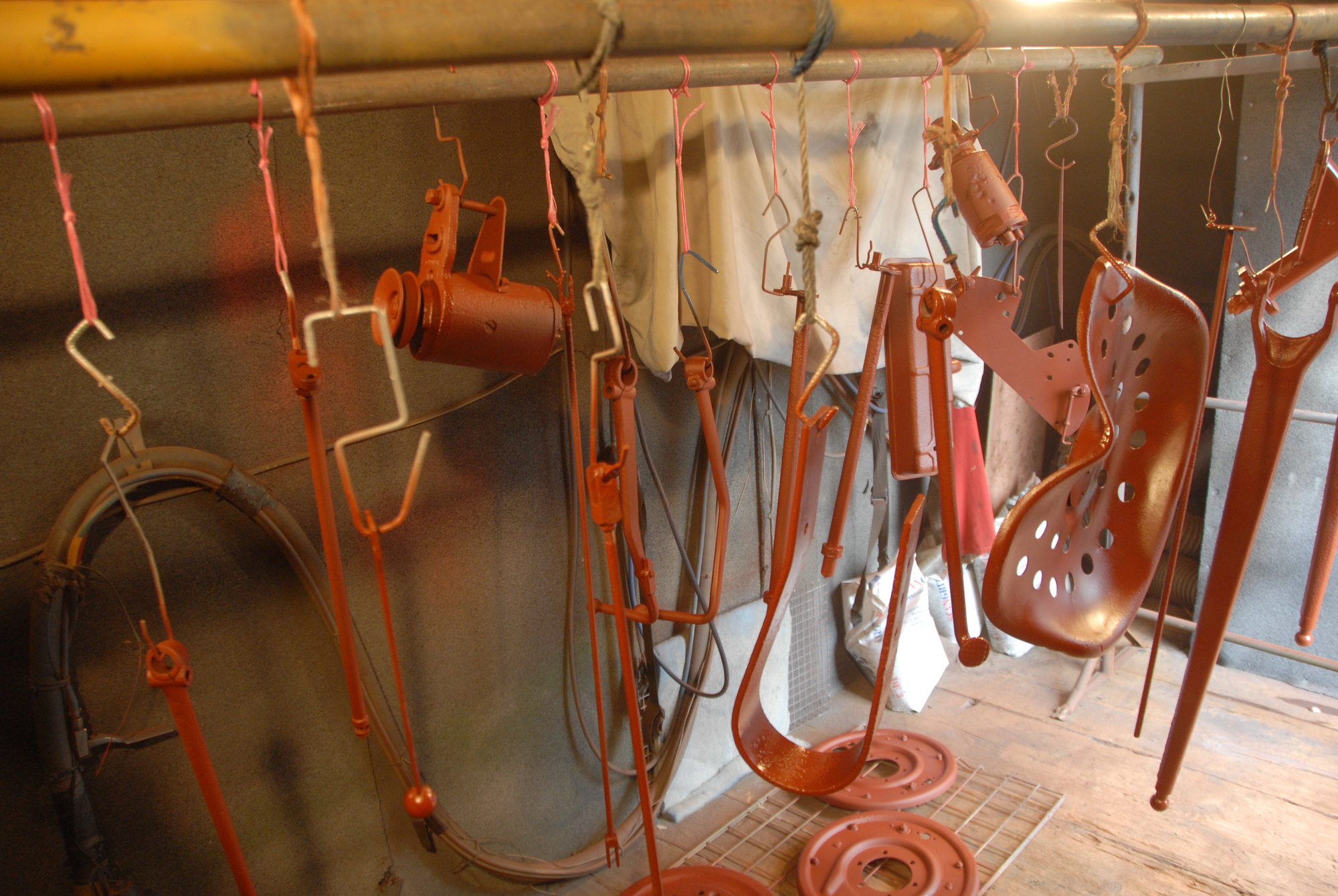

    I managed to get the seized hydraulics working. I decided to strip it completely and give it a good shot blasting to see what was salvageable,
    the parts that were salvageable had a coat of Epoxy primer and that's how its been sat since last autumn.

    Starter rebuild

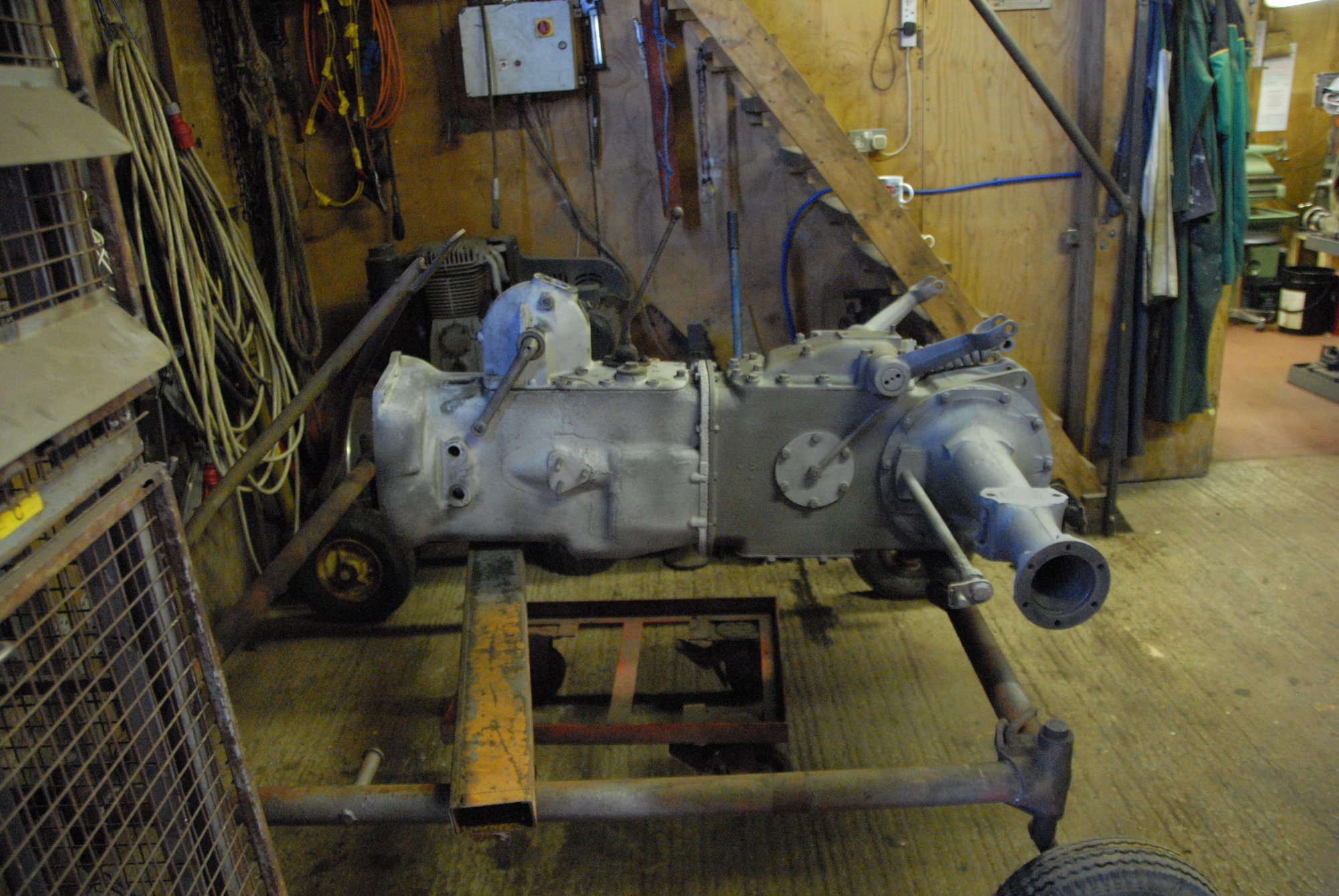

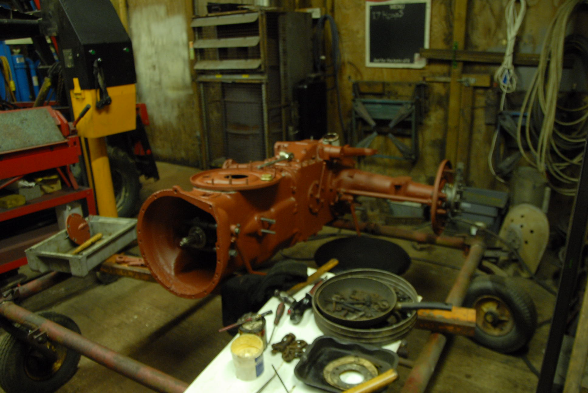

    Time fly s and I had to dig out a load of old photo’s to remember how things went. I had some free time this afternoon so I got it uncovered and into the shop, dug out some boxes and I got one of the half shaft back in along with 1 brake back plate and foot pedal linkage. The gearbox input shaft, thrust bearing and the two shafts that go through the bell housing to the pedals.

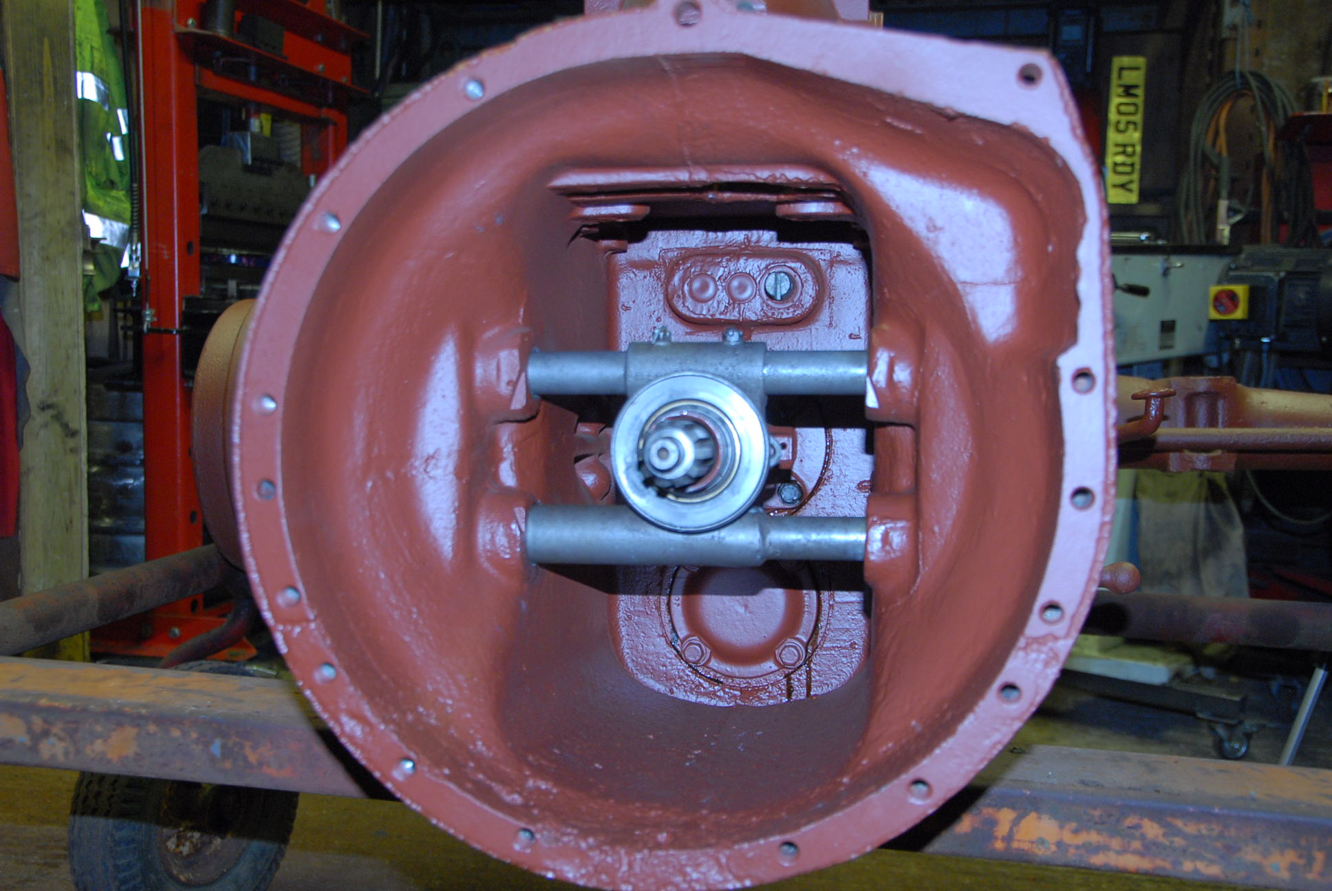

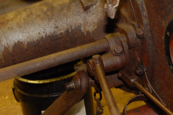

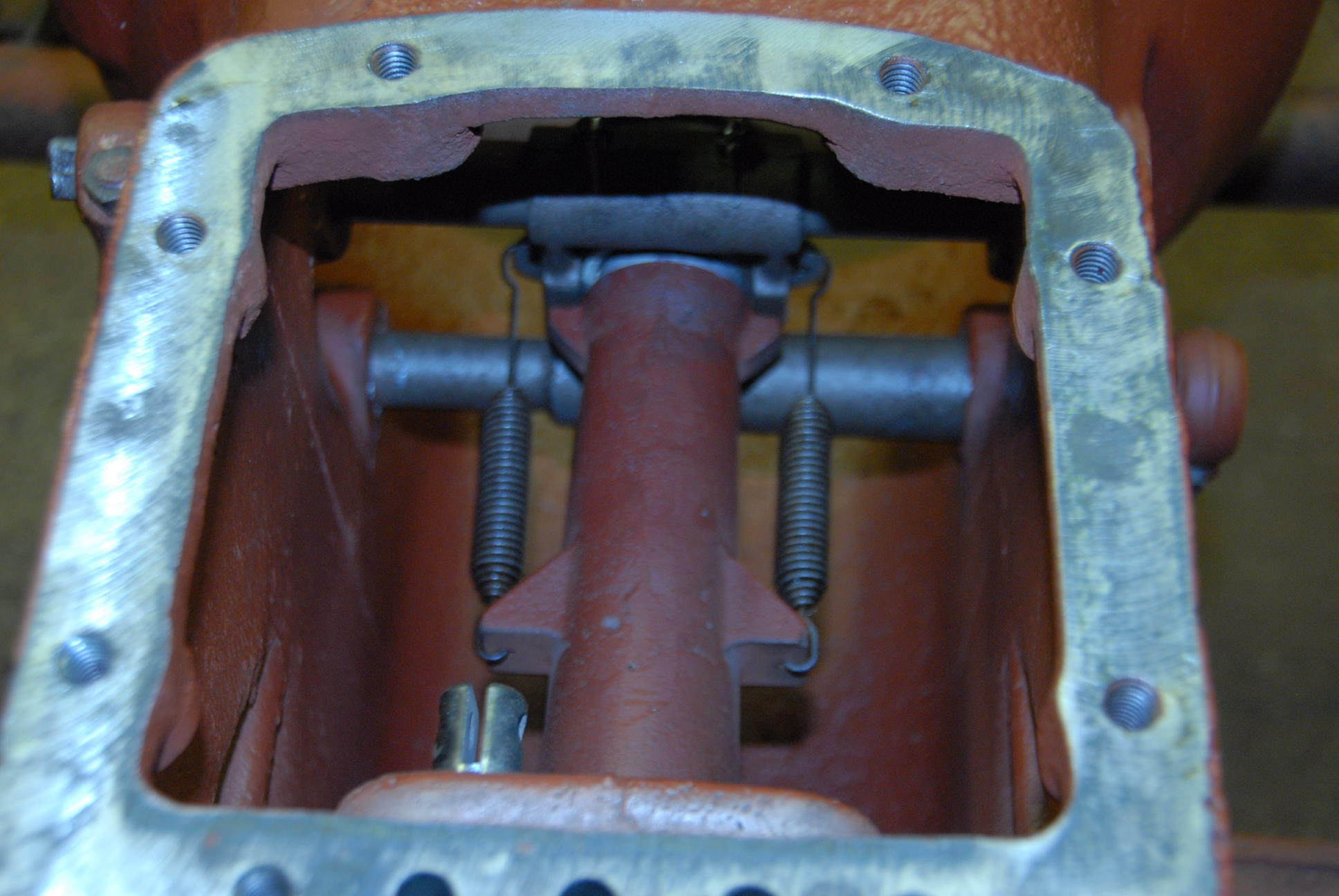

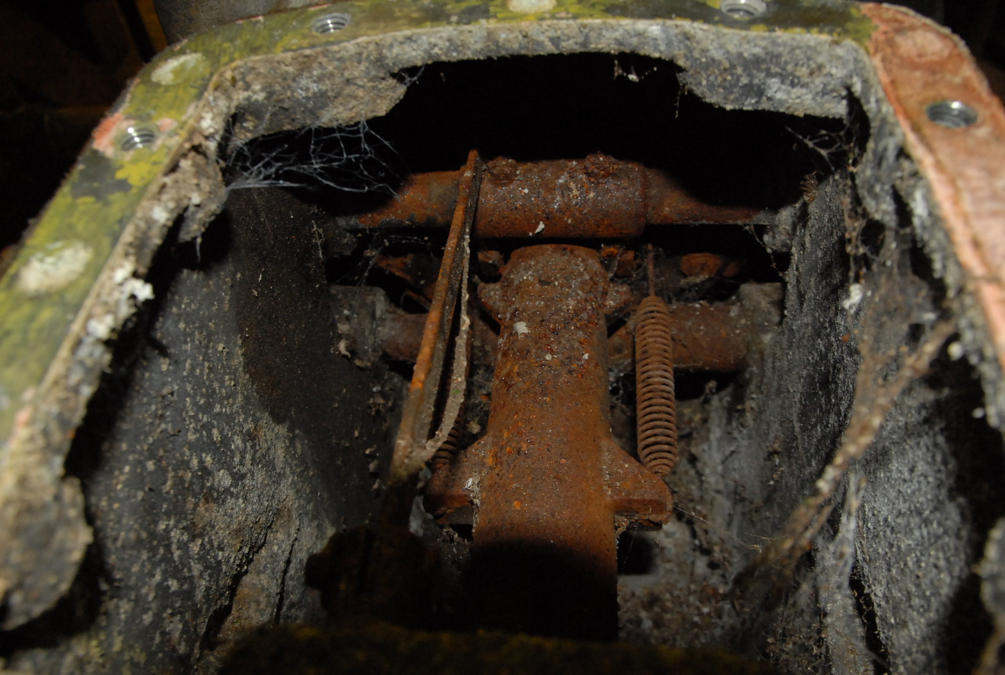

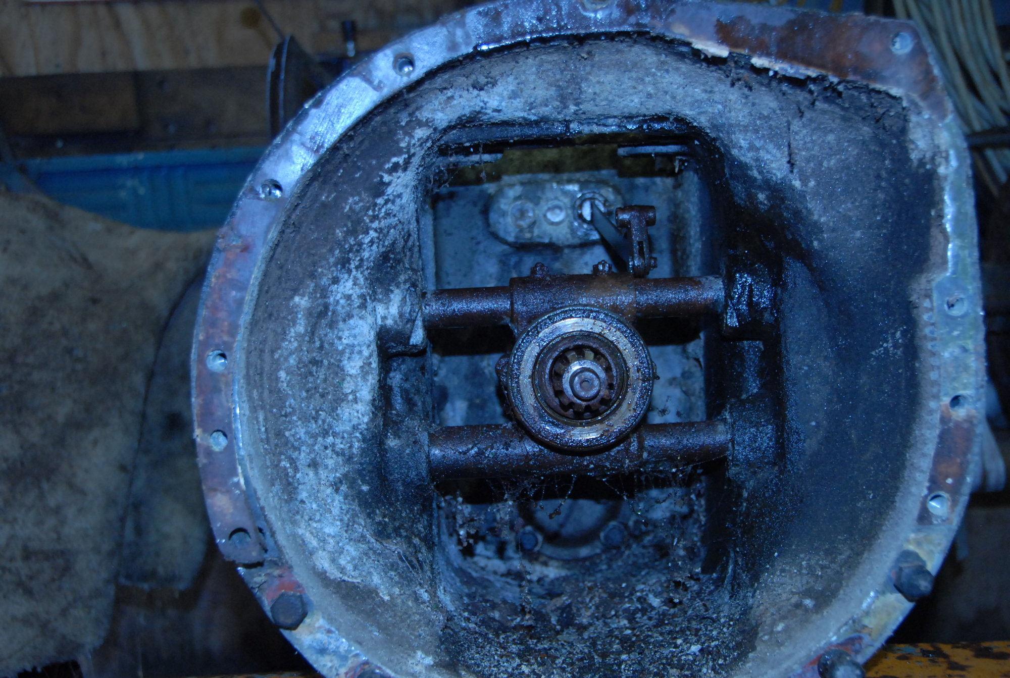

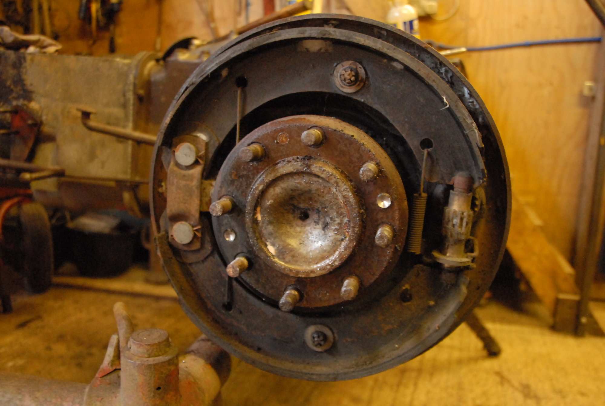

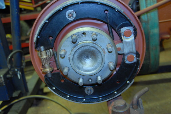

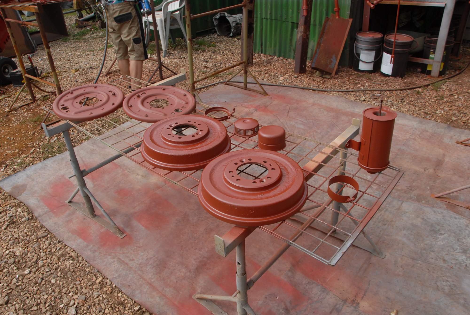

    Got the brakes all sorted and the link rods and pedals back on, I was going to spray all the parts grey before I reassembled , but I am so glad I didn't, there would have been a bit of touching up to do. That epoxy resin primer I used is as hard as nails and can thoroughly recommend Jotun epoxy primmer. Here are some before and after pics

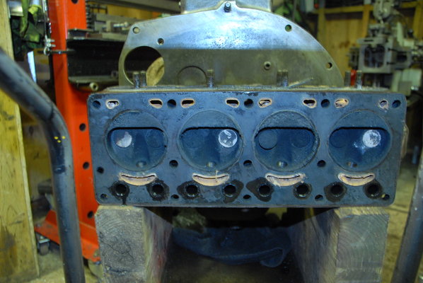

    Not much done today I got cold outside this morning:) so I had a qiet afternoon in by the fire and started to clean up the engine before painting. I may be going to pull the head off and get it in the blast cabinet as there are to many nooks and crannies where I cannot get the wire wheels in. Bit of a shame as it still got the original copper head gasket on.
  19. jordhandson Member
    Messages:
    708
    Location:
    Dorset

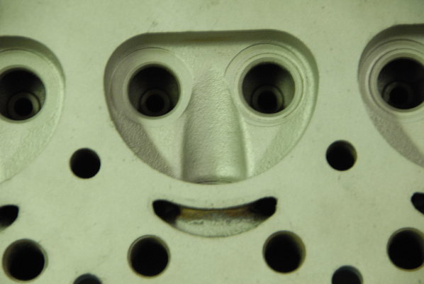

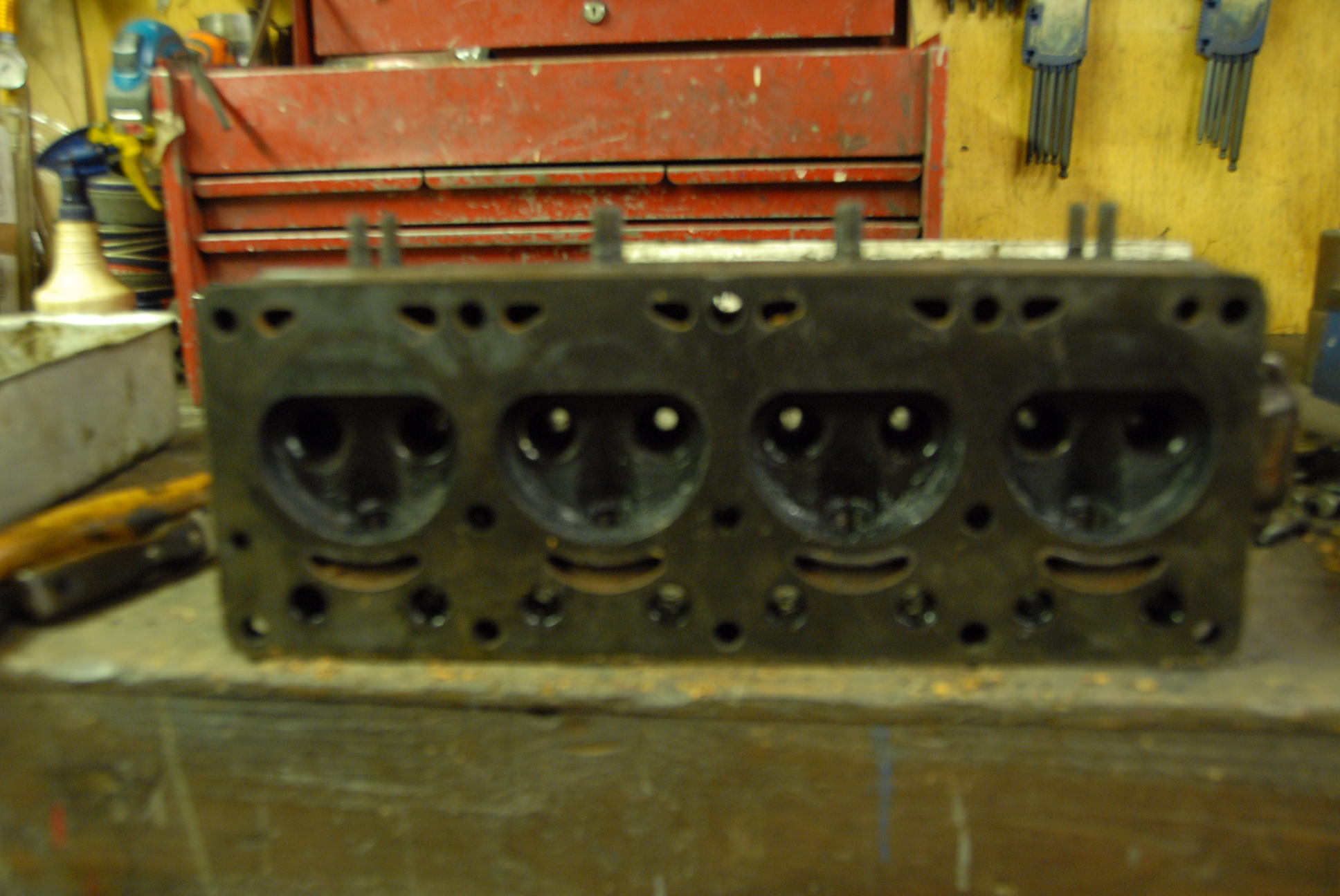

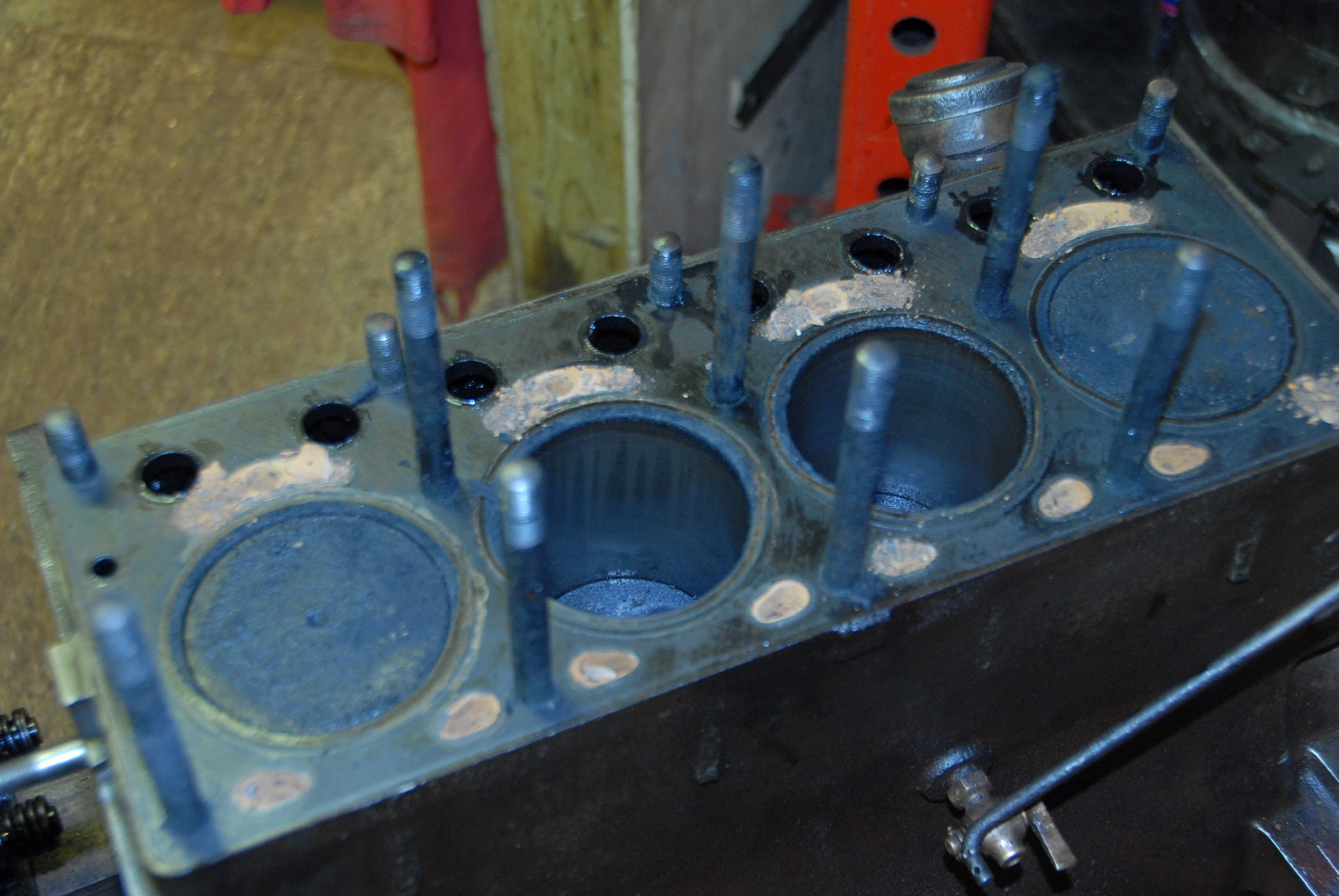

    I am glad I pulled the head off today there was a lot of carbon deposits in there and I had 1 stuck valve.
    The amount of crud that came out of the waterways was amazing, still got to blow out the engine block waterways yet, I will probably do that tomorrow as it make such a mess, I will add a vid on my shedOpps on youtube later to show how bad it is.
    Getting back to the head, I removed all the valves
    and I ran the head through the cabinet to clean any carbon deposits, it has come up quite good

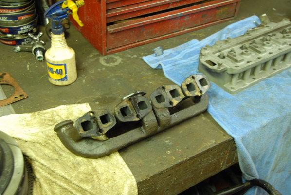

    I also gave the manifold a bit of a blast off
    This afternoon I reassembled the valves back in the head I gave them a bit of a lap to make sure there seat are good
    these two parts are now ready for paint.
