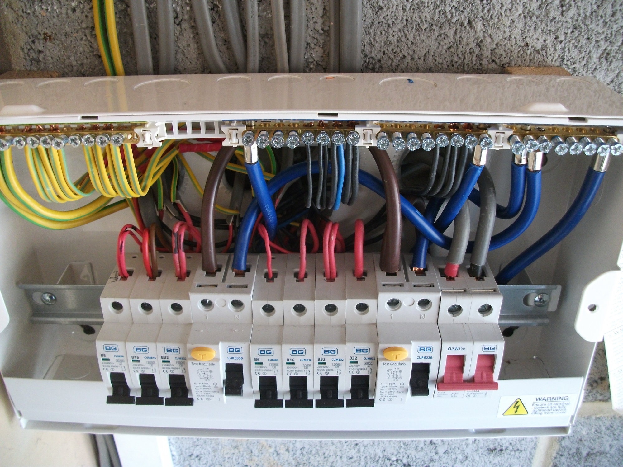

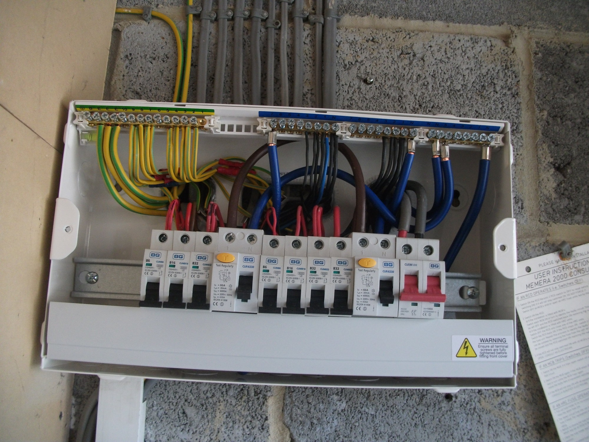

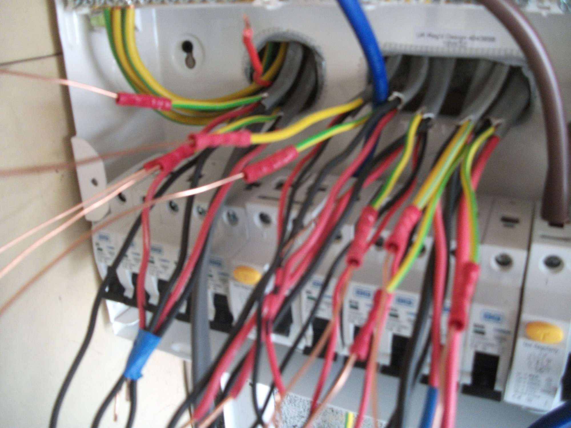

some others were a bit shorter than id have liked but it didn't turn out to bad .would have been tidier had all new were run in but its okjust done a db change today. every earth wire was short and needed extendingsome others were a bit shorter than id have liked but it didn't turn out to bad .would have been tidier had all new were run in but its ok
