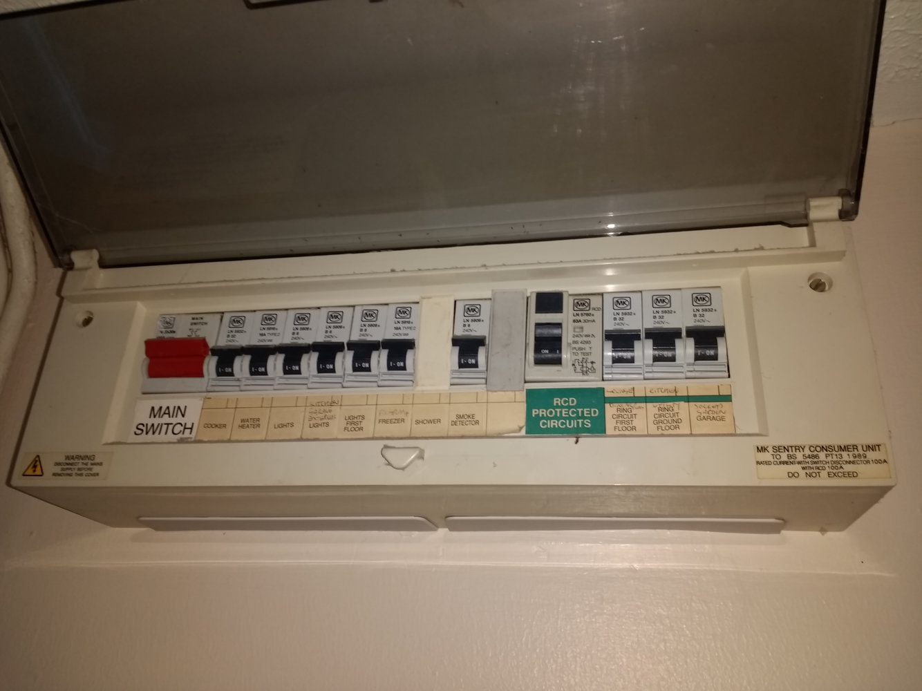

Our house fusebox shown below, was installed in 1995 when the house was ripped open for an extension.
All has been well since then, except -
The green RCD has been tripping lately, most often (but not always) when the pump-boosted shower is switched off.
The individual fuses don't trip, which seems odd? and the shower and all other appliances still work when the RCD is reset.

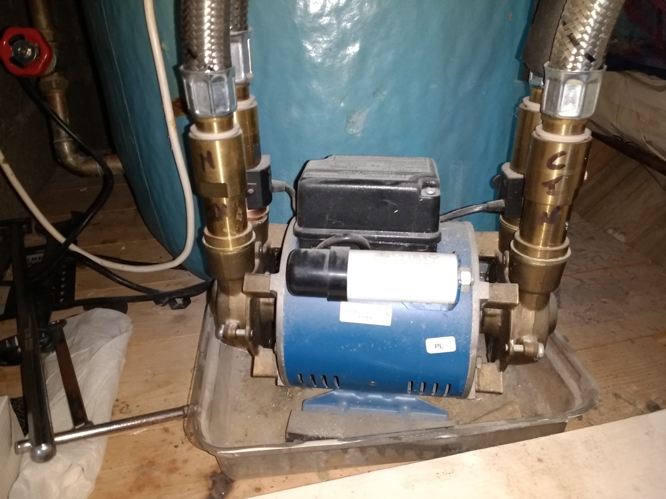

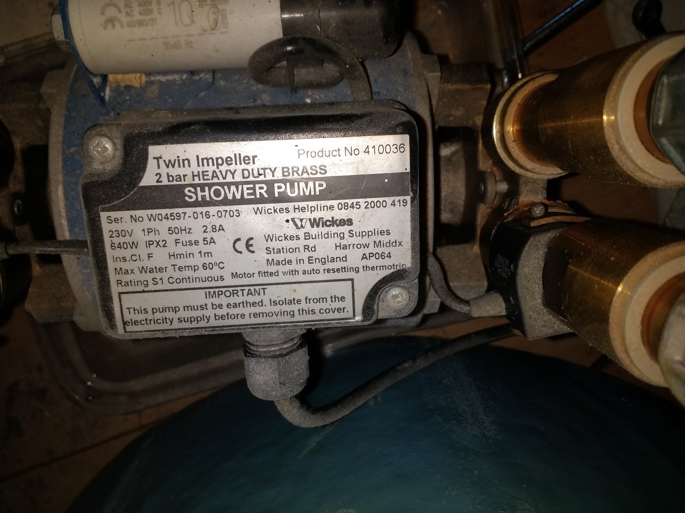

But the shower pump is about 15yrs old , and lately doesn't always switch on with the shower, so I'm suspecting a dodgy flow-sensing-switch and so will probably just replace the pump.
Does this sound logical / reasonable?
I seem to recall reading on here recently that individual fuses can fail, which surprised me, might this also be an issue here?
Also - any recommendations for a new pump?
