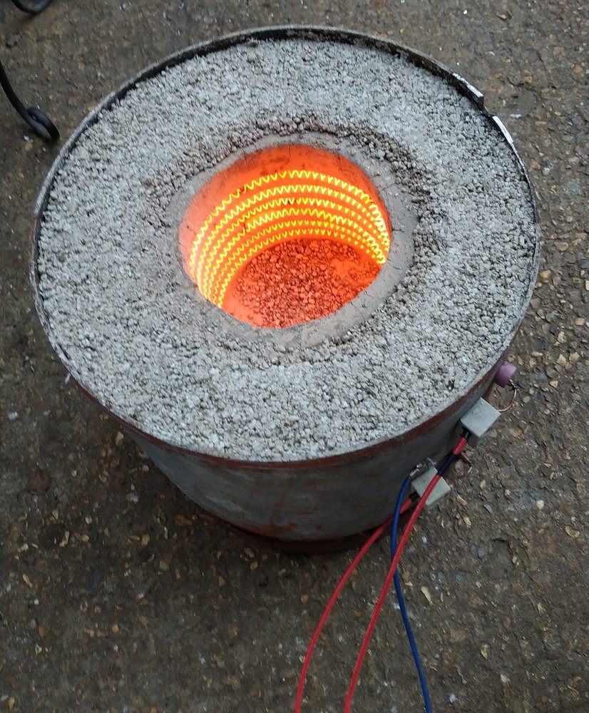

When our electrics were done in 2020 the sod electrician gave us two 30ma RCD's covering the whole house instead of RCBO's. It is a pain if it trips, takes out the lights. He could have put the lights on the other RCD but its the same as the sockets.
Can I get a more sensitive, 5-15ma RCBO/RCD to put before the shed socket, to catch any trips that I may cause, without taking out the whole house?
I have a few normal, 30ma RCBO's and Ive tried with them, but the main one always trips first.
