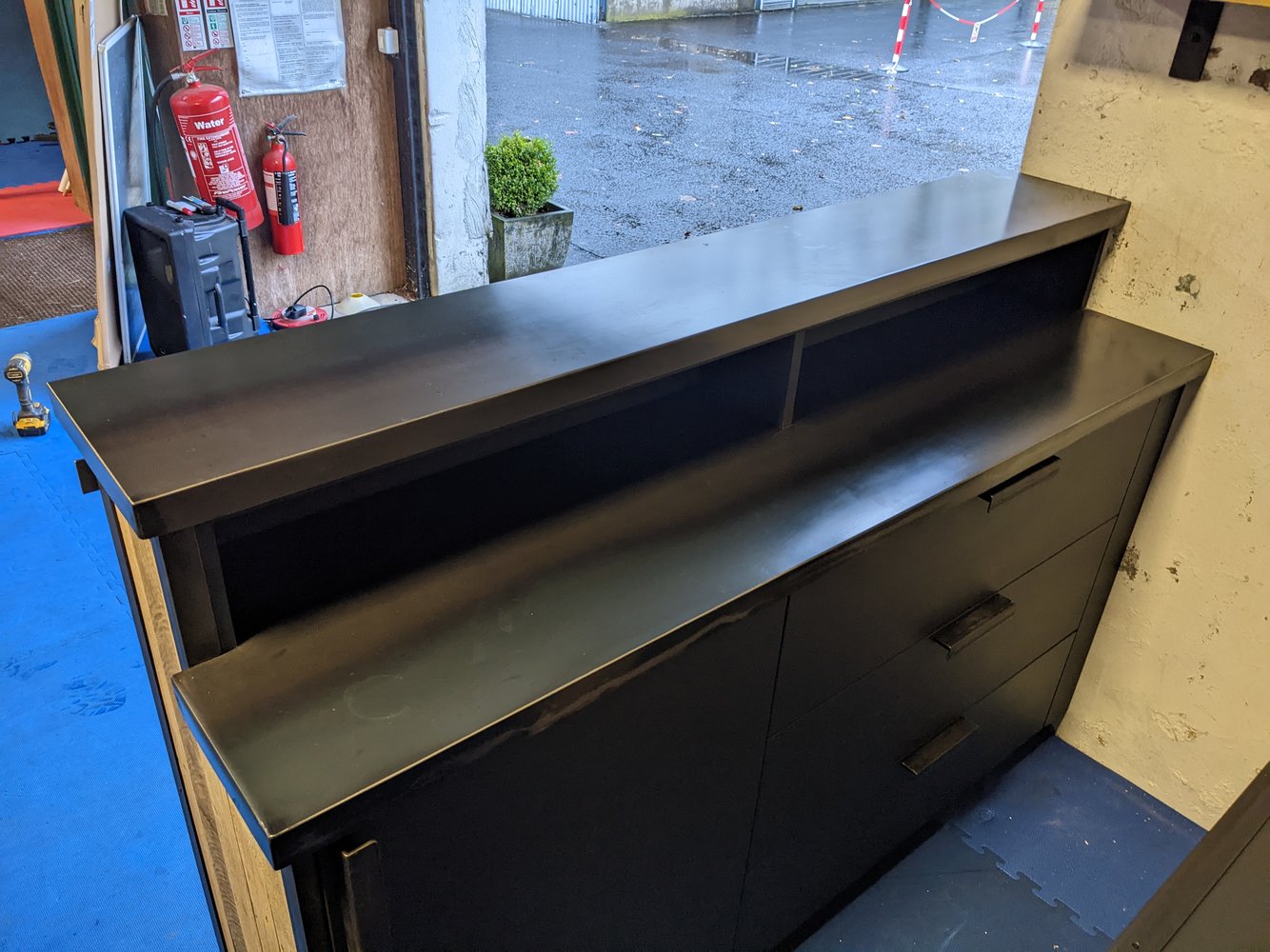

As its only a mild steel on mdf wouldnt it be easier to knock up a new top/tops and spray them with 2k clear primer? you could let them cure and swap them over whenever.
Bob
Not really. They are folded round the core and scribed to the walls (old barn, lots of scribe).
I could roller 2k on...the actual finish isn't that important, it's "rustic"
I'm sure one of the marine suppliers, jotun or sherwin williams would have something clear and hardwearing.
Or perhaps a coatings supplier like resimac
There's a few epoxy clear coats intended for floor paints that might work actually, 24 hour cure is workable if I did it on a Sunday.
