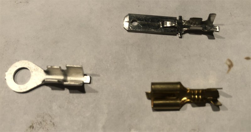

On those small uninsulated terminals I prefer the non ratchet style, a lot lighter and compact, you can crimp the wire first making sure you have a good connection and then crimp the strain relief

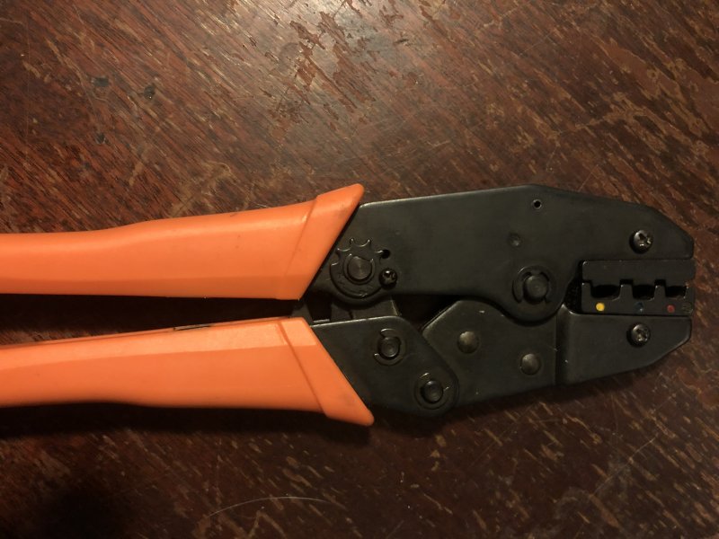

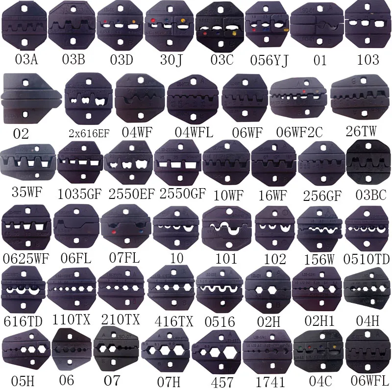

That’s idealIdeal do interchangeable heads for their frames
