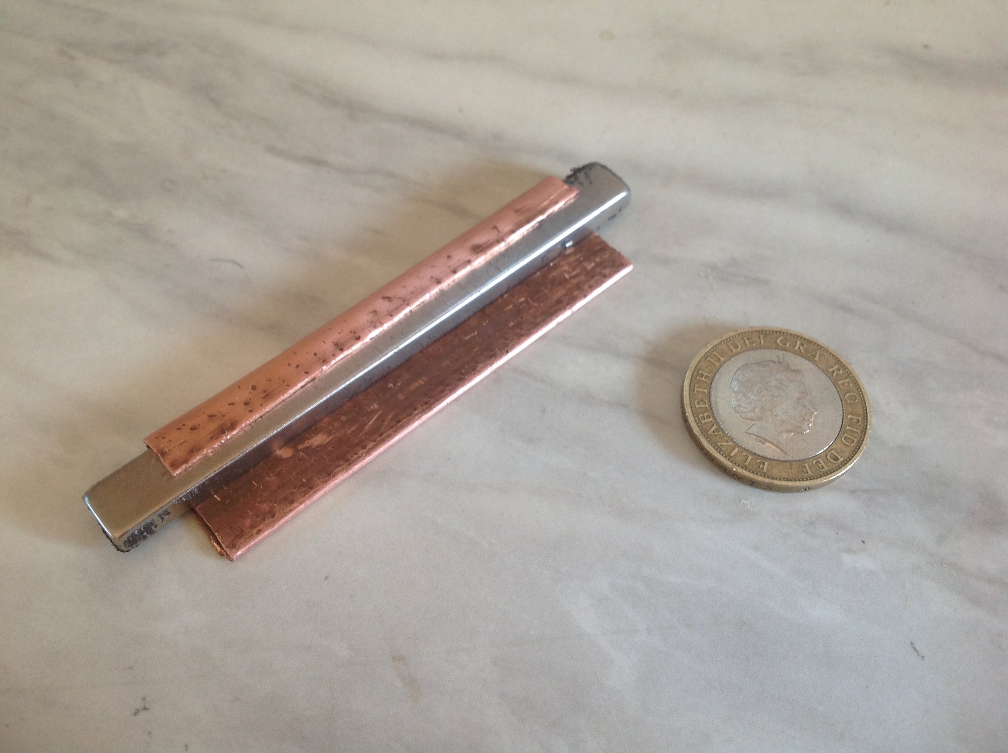

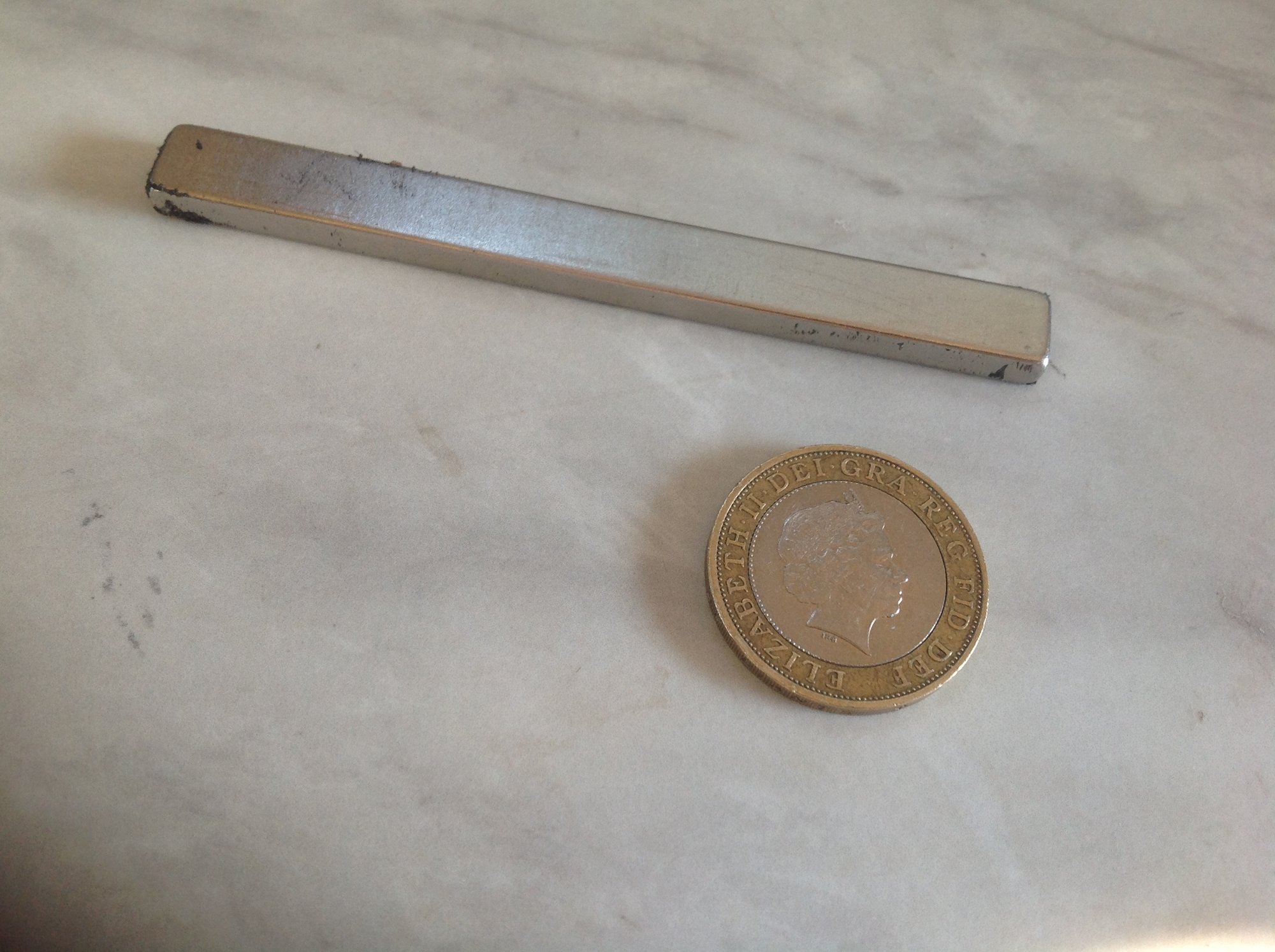

I will report back when the magnet arrives..
In 3 weeks..
In 3 weeks..

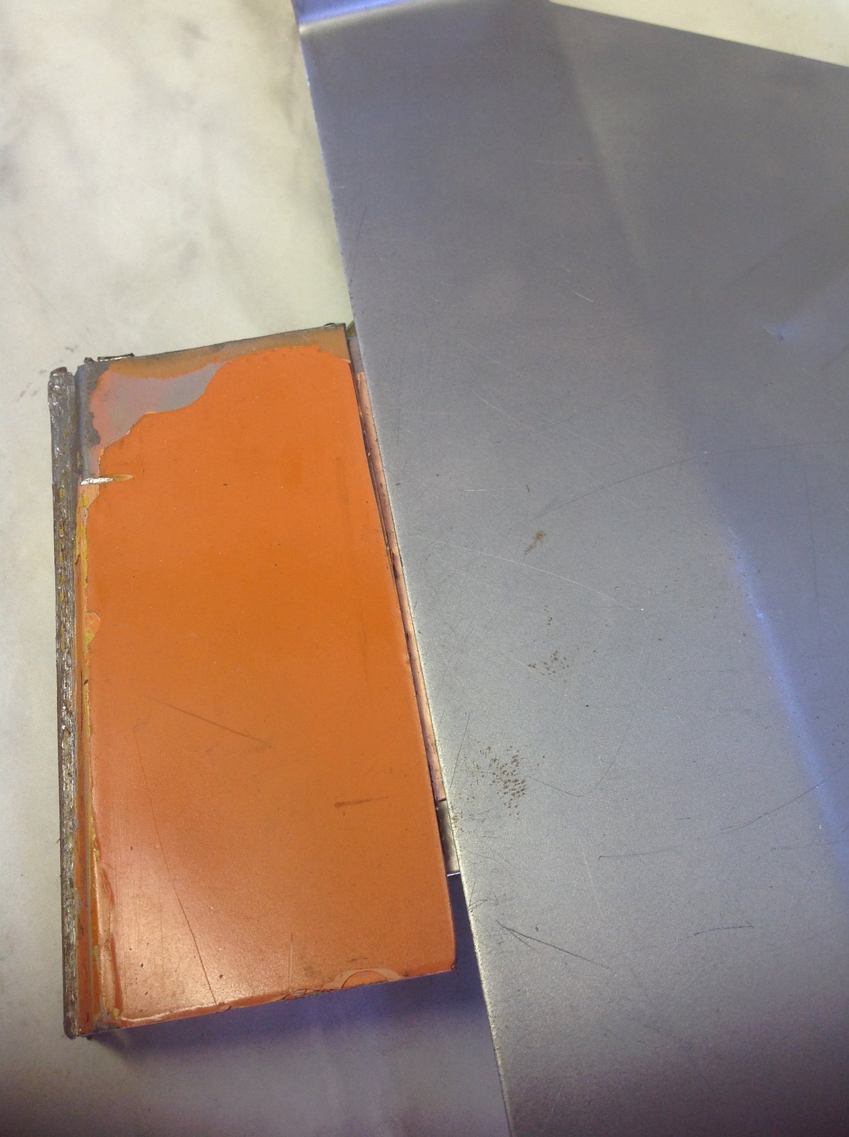

I've found on stuff of that thickness that magnets are more hassle than they're worth. On anything below about 1.6mm the offact on the arc is too much, it's hard to even get a nice tack with a magnet near by.
If I'm welding thicker stuff I use the magnets all the time as it doesn't seem to afact the arc too much.
Old computer hard drives are good sources of rare earth magnets.
Is that on porn hub..Google "arc blow" and you'll find out all about it
In 3 weeks..![]()
The magnetism seems to make no difference..,when stitch welding thin panel...![]()
