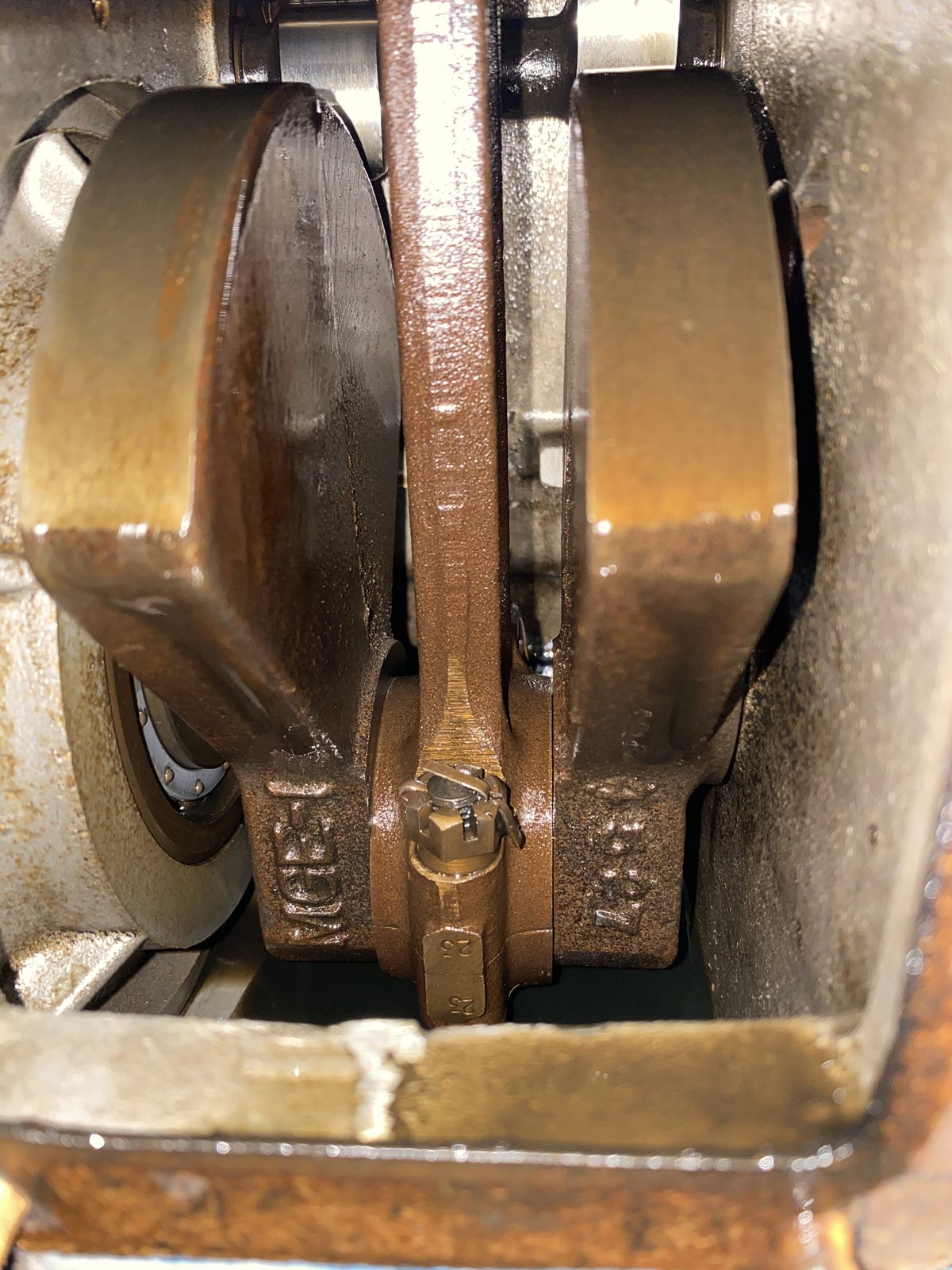

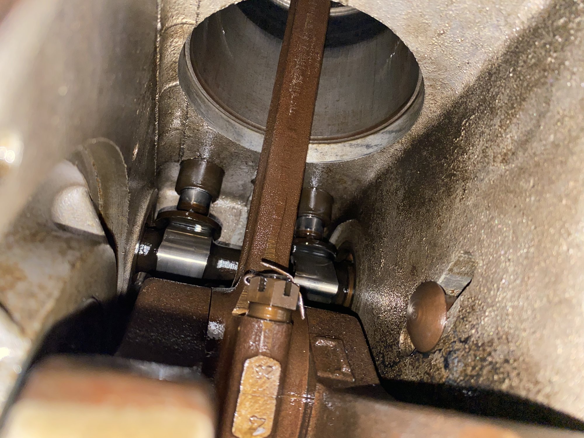

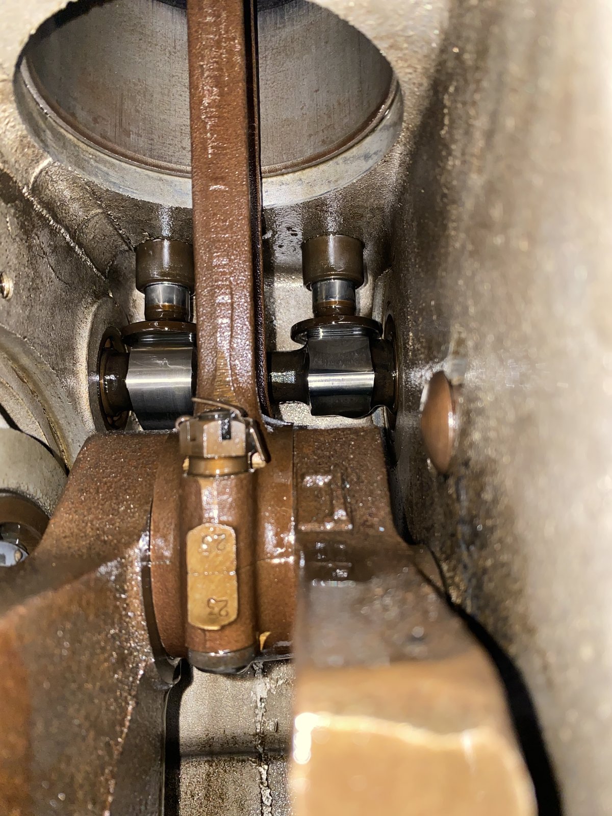

I think the engine sounds like it’s knocking, could it be the oil being too thin? Should I decarbonise the spark plug? Lap the valves? I disassembled and oiled the shift lever, which now works really smoothly. I’m not sure if it was sticking before because of being dirty, or because of the lack of clutch and the gears holding each other in place. I’d have liked to do a lap of the garden to see, but it’s pouring down! Tracks and very wet grass = mud

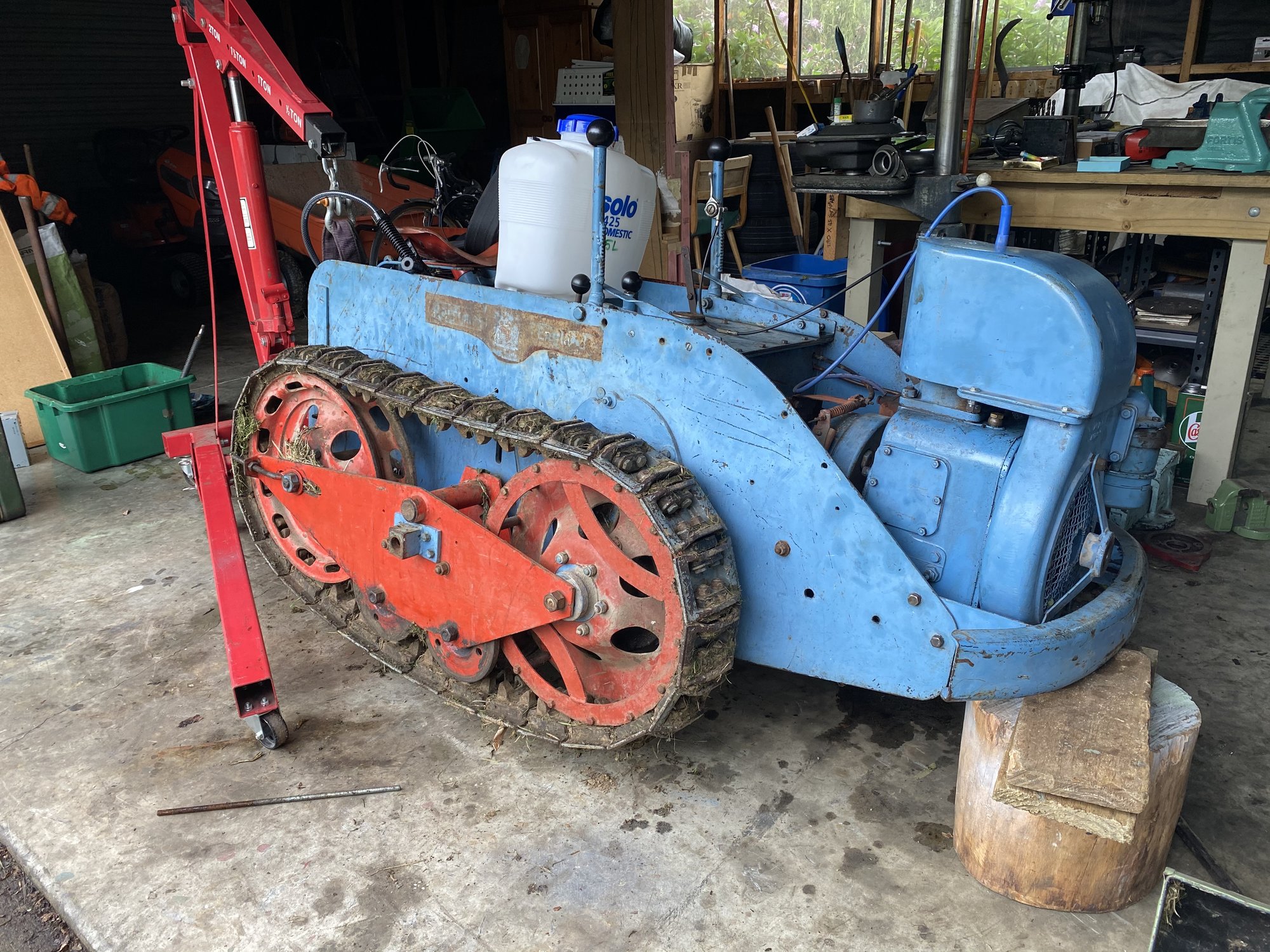

it’s running nicely and it’s stopped raining... I think I might go for a (careful) play!What an incredibly cool thing![]()

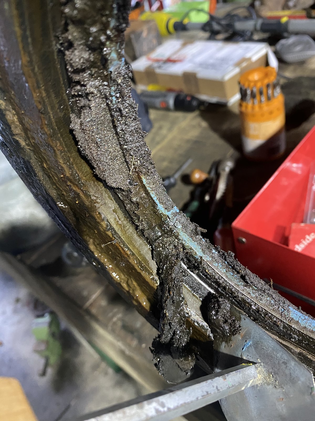

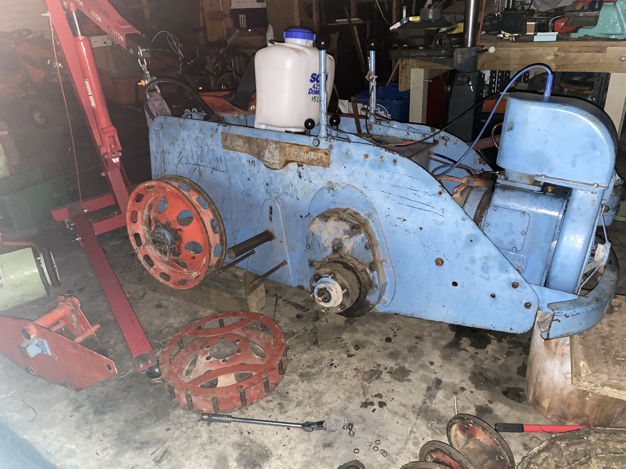

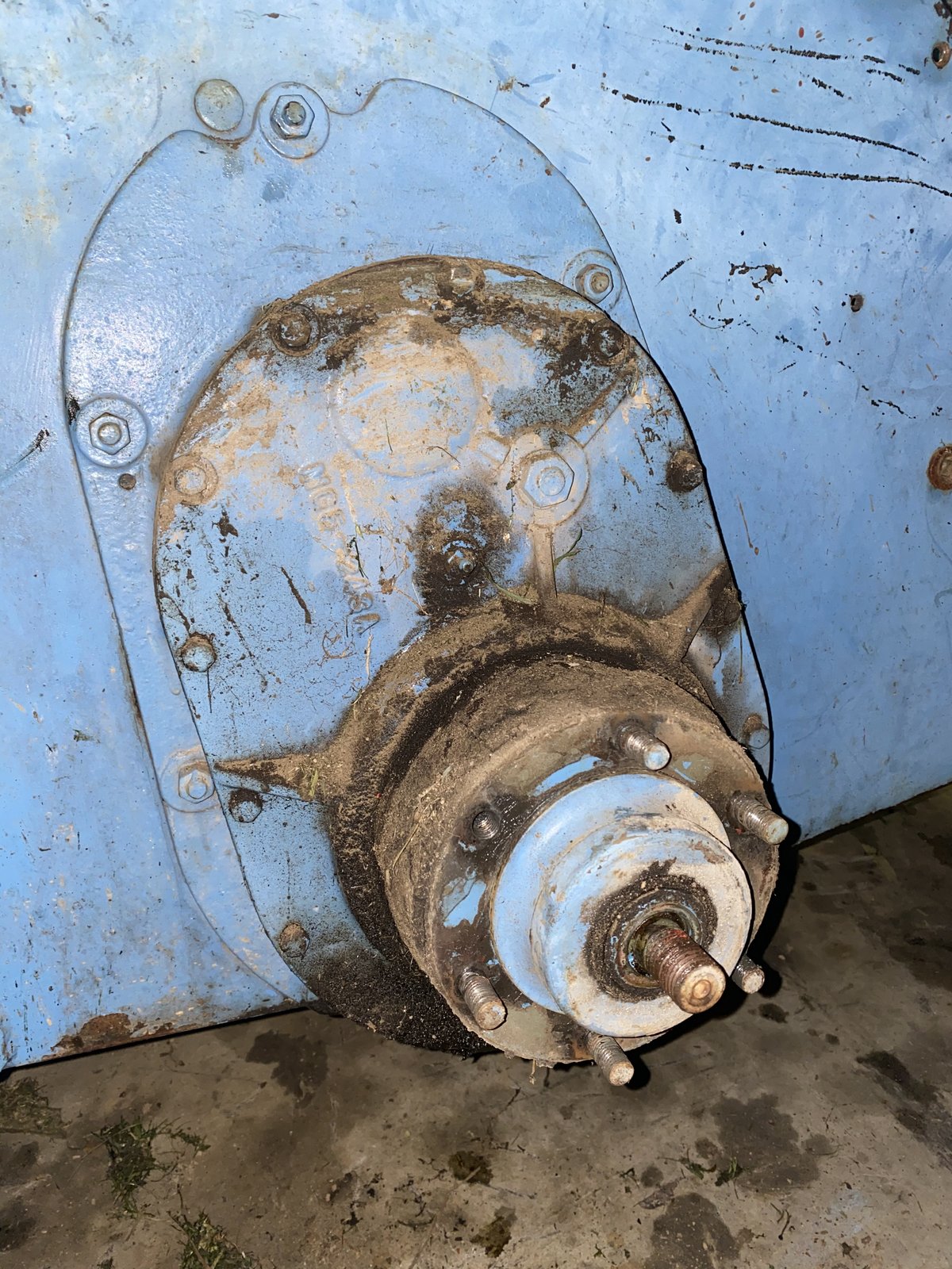

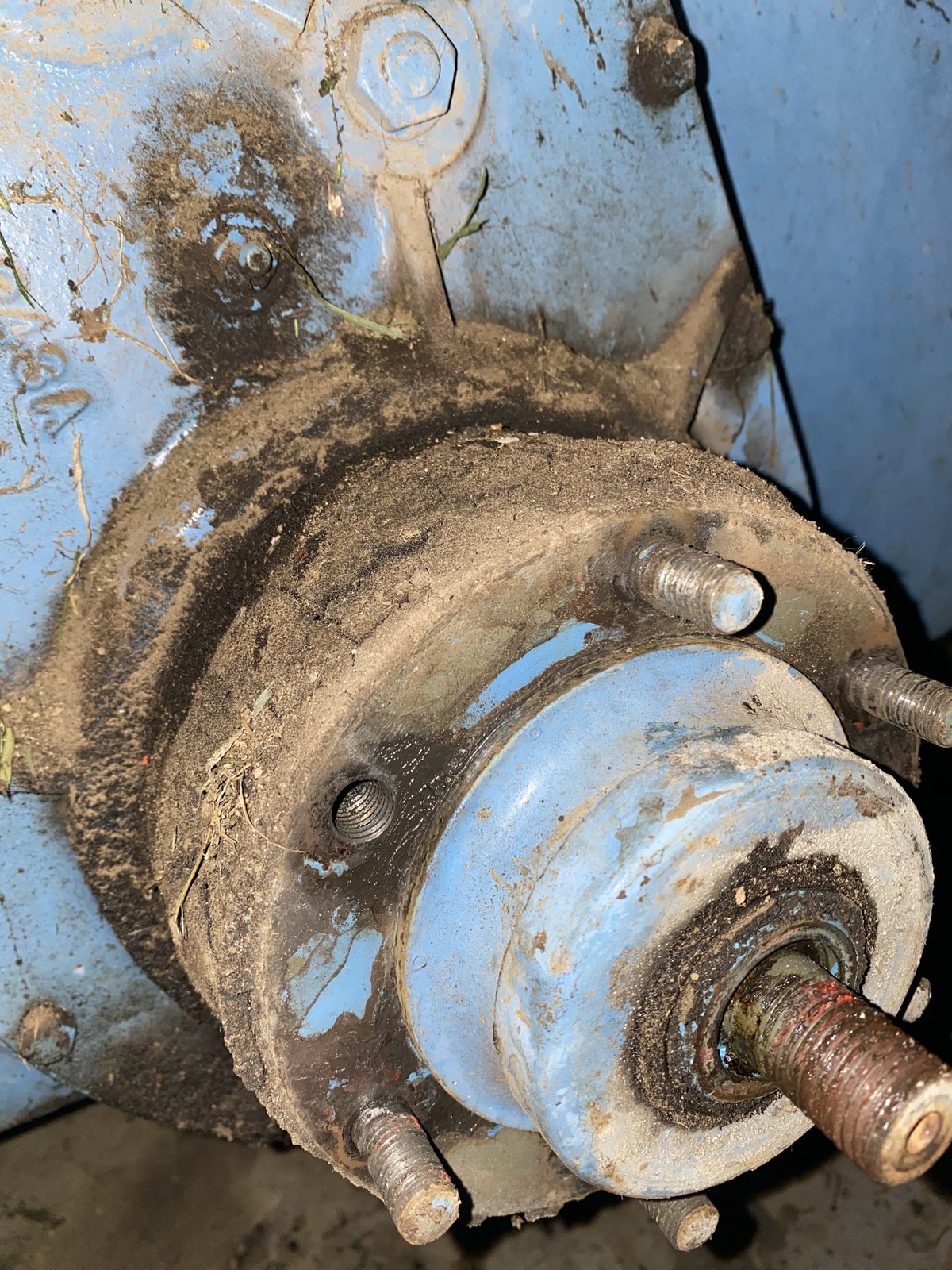

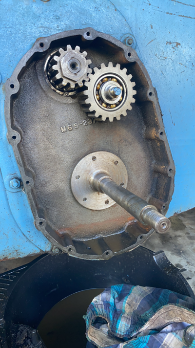

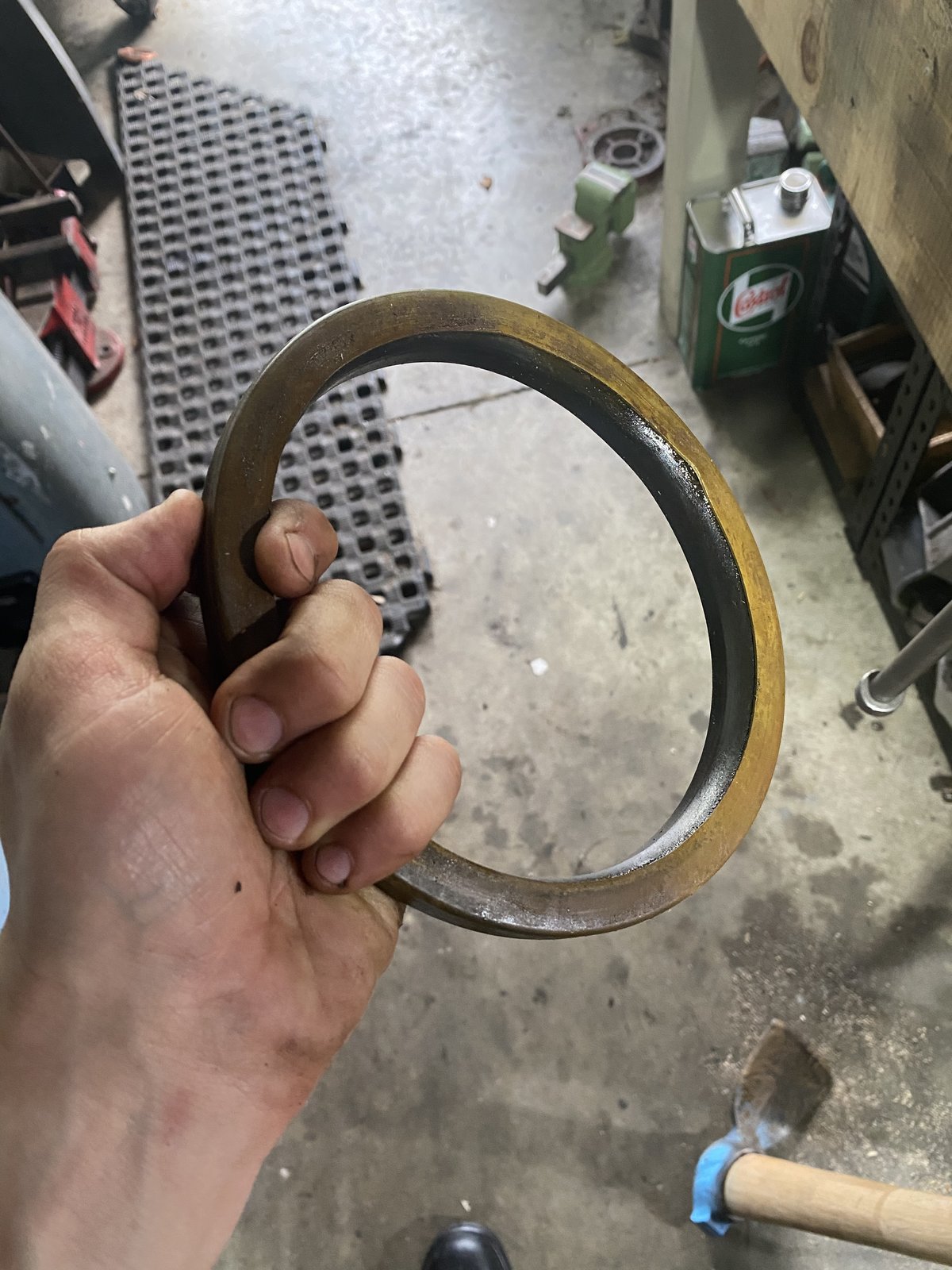

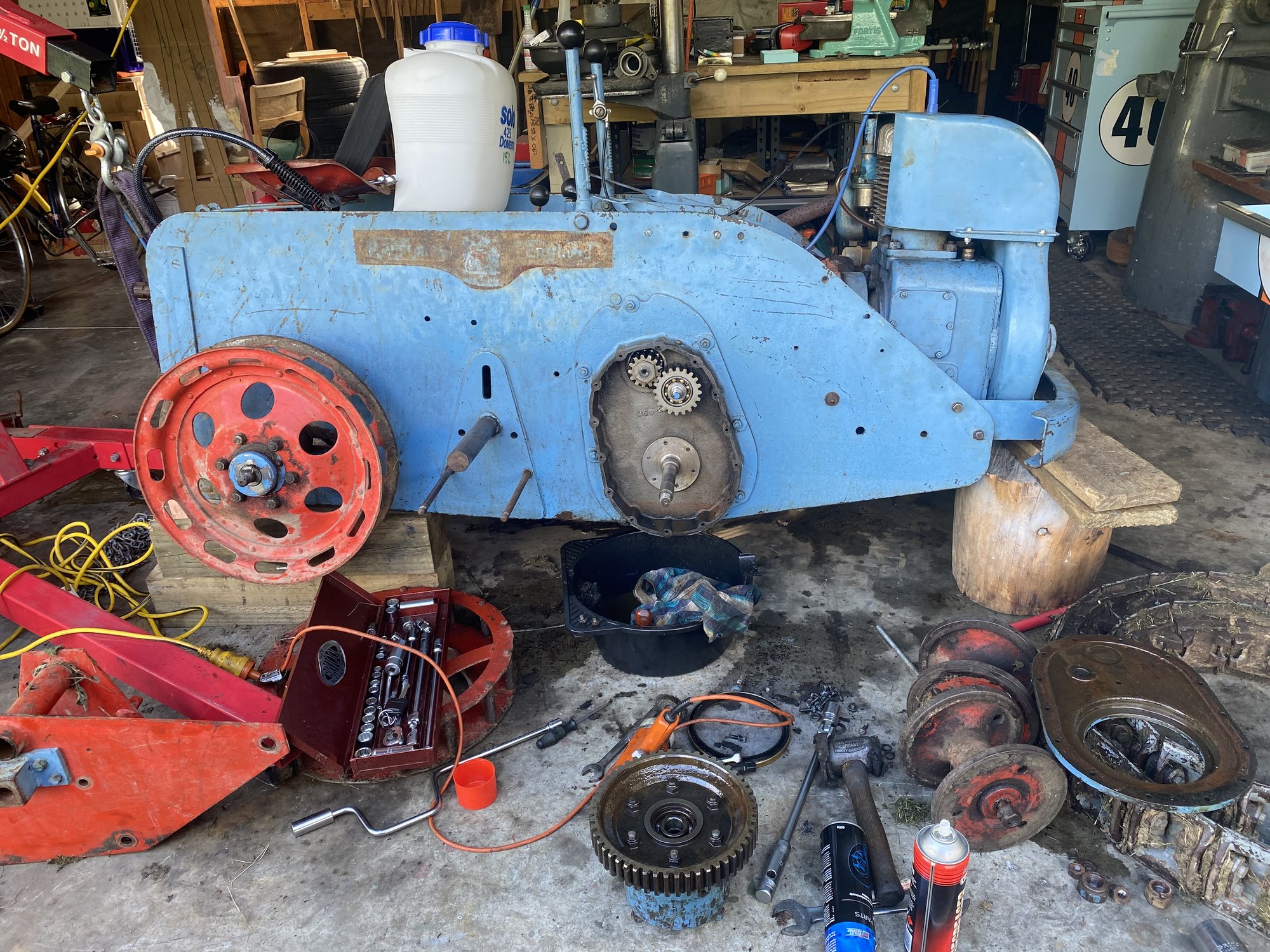

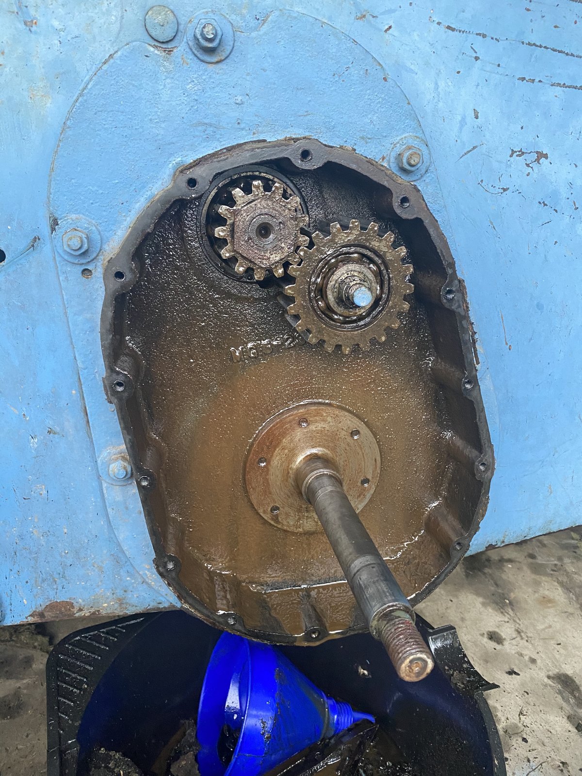

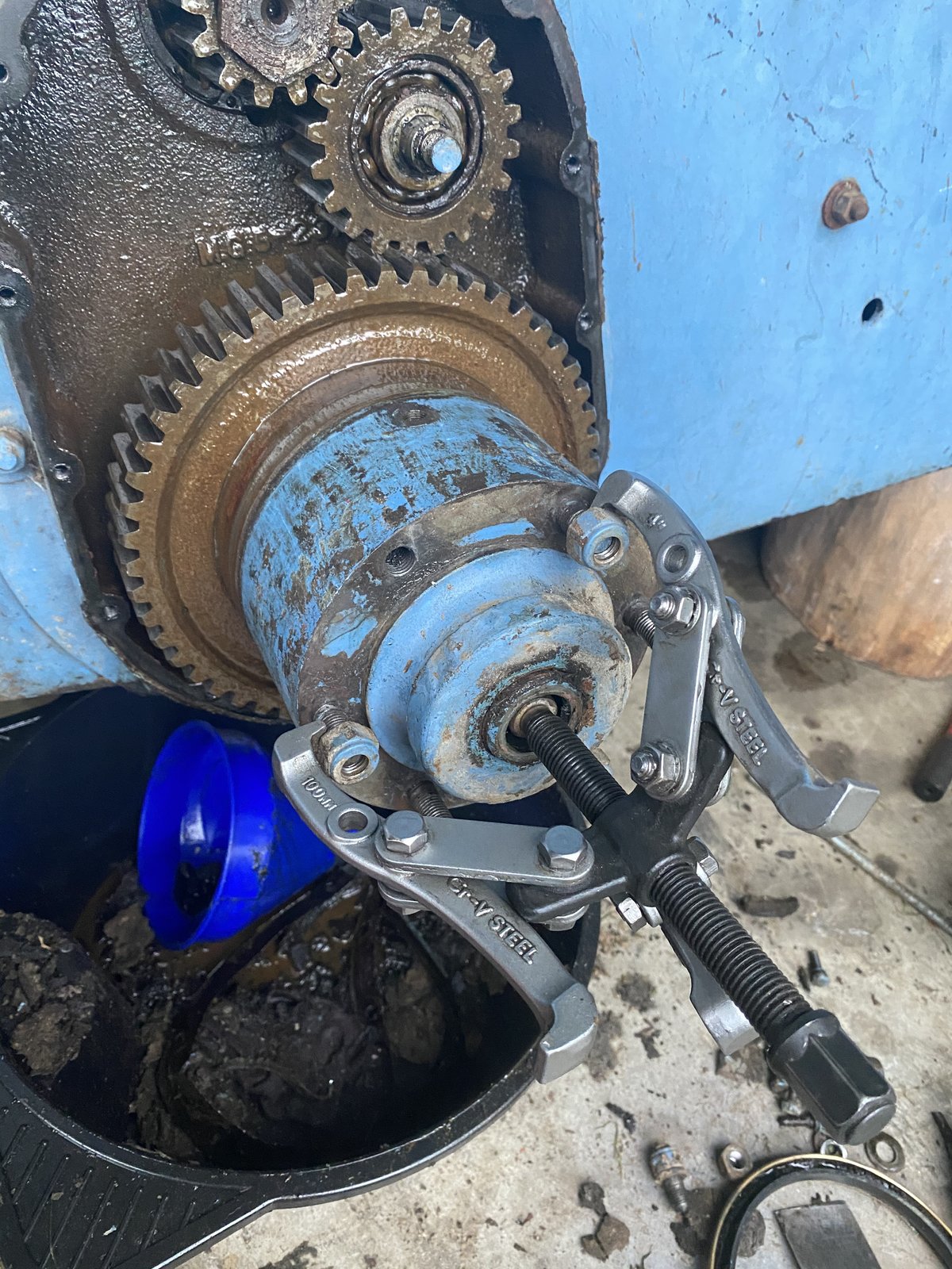

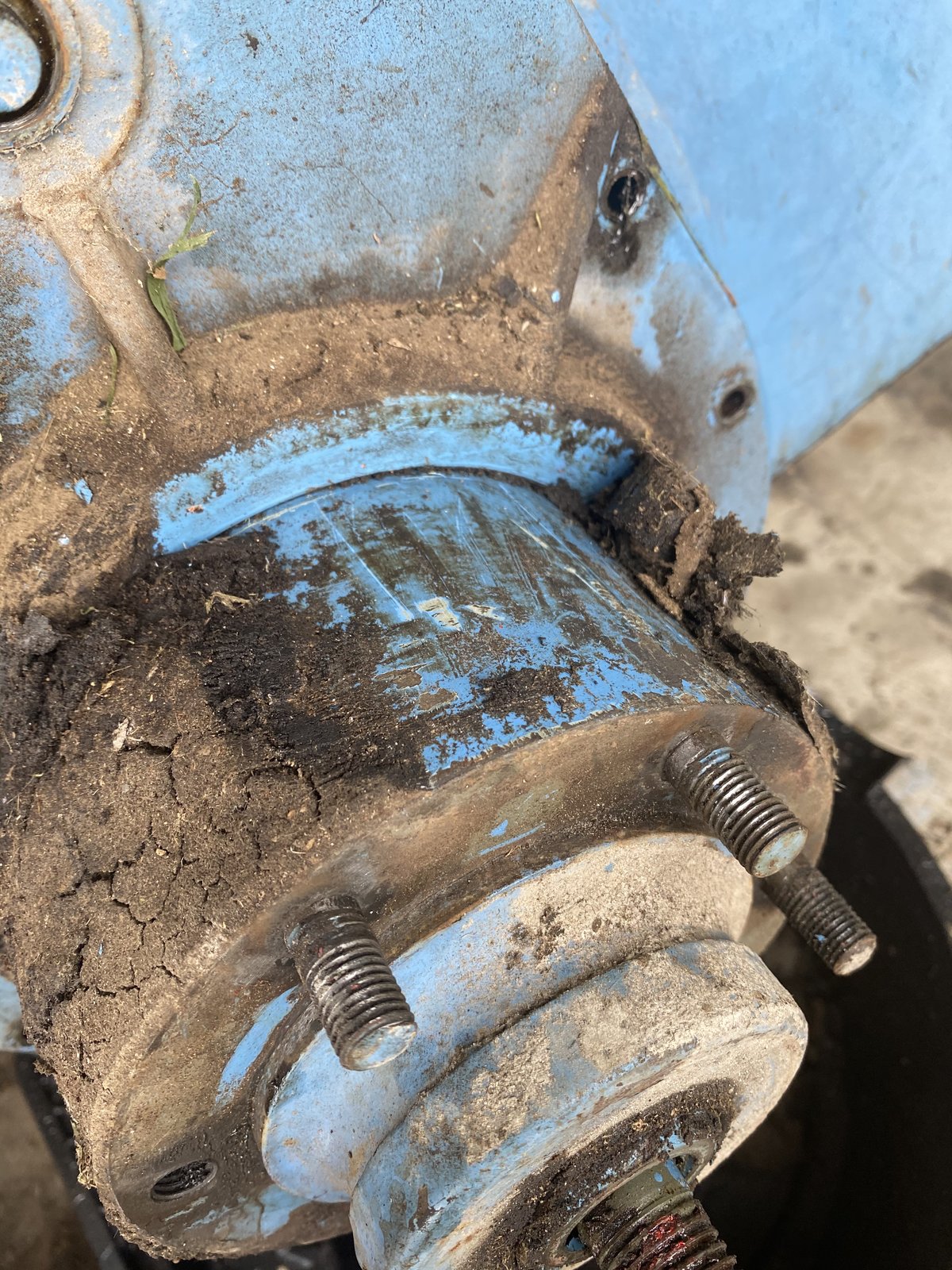

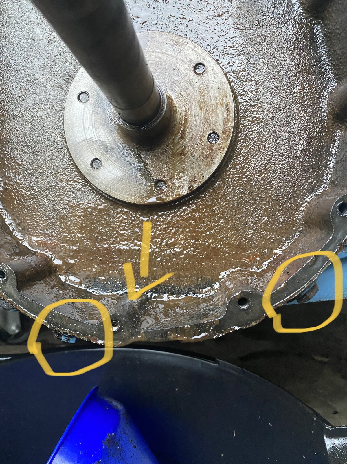

I jacked up the side of the machine last night and got to work removing the tracks. This is a less-than-simple operation, which requires quite a bit of work. I’m trying to get at the final drives, as I think it’s got a busted oil seal.

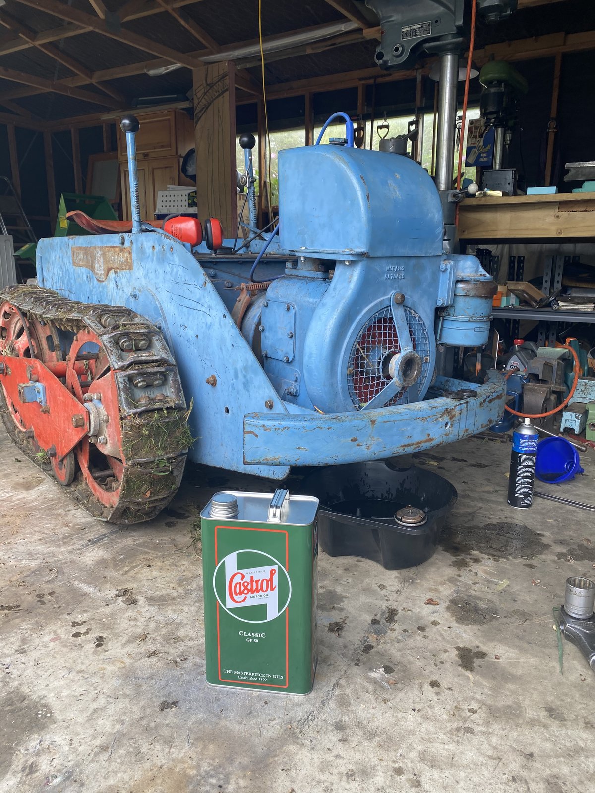

Castrol make the correct EP140 oil for the drives, so I’ll try and get some.
are you sure it's a oil seal gone in there to the final drive
because there is a grease nipple above it so maybe just a hub with the final drives separate
but what a chaotic scene has unfolded!
Giant Meccano set![]()
