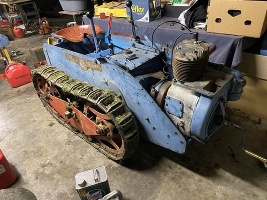

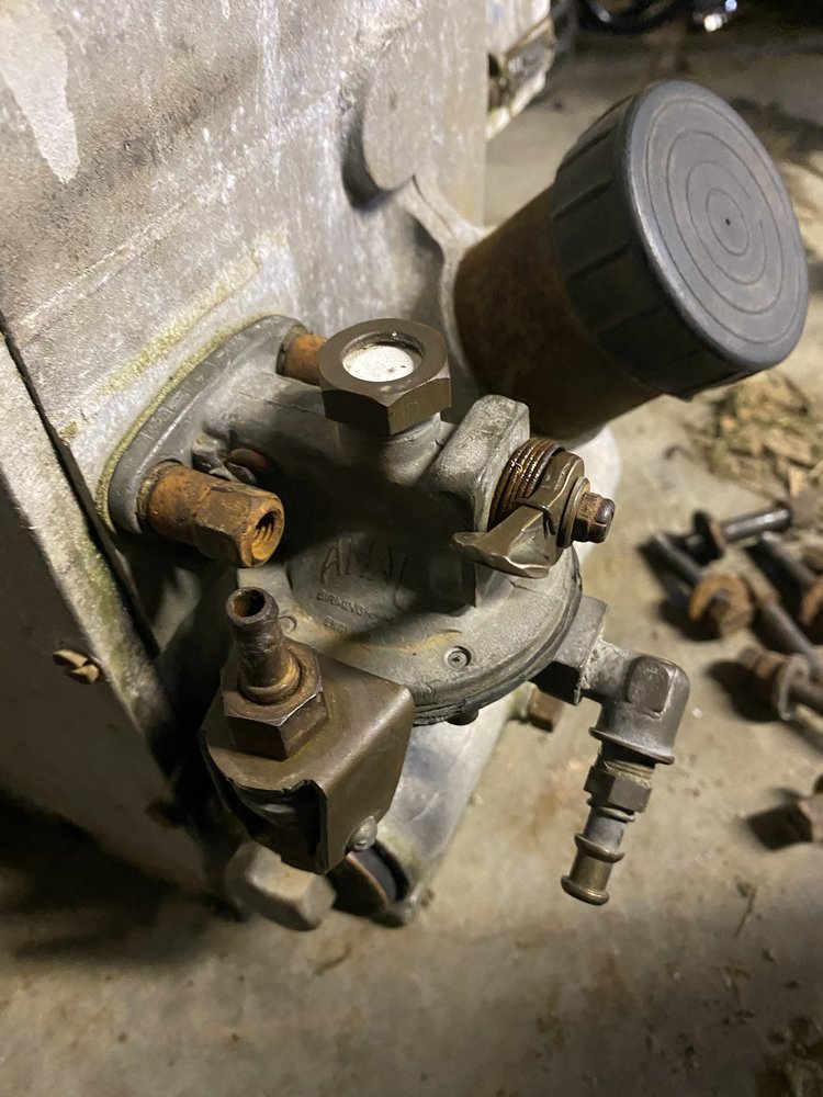

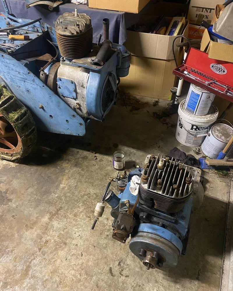

This also exists in the workshop, it’s a B&S mini genset, I think it’s WW2 or around then. Haven’t managed to fire it yet.
B&S engines of that era are pretty hardy, probably just needs the points cleaning or a new condensor. Once you have a spark try a bit of fuel down the plug hole to see if it will fire, the carb may need a rebuild.
