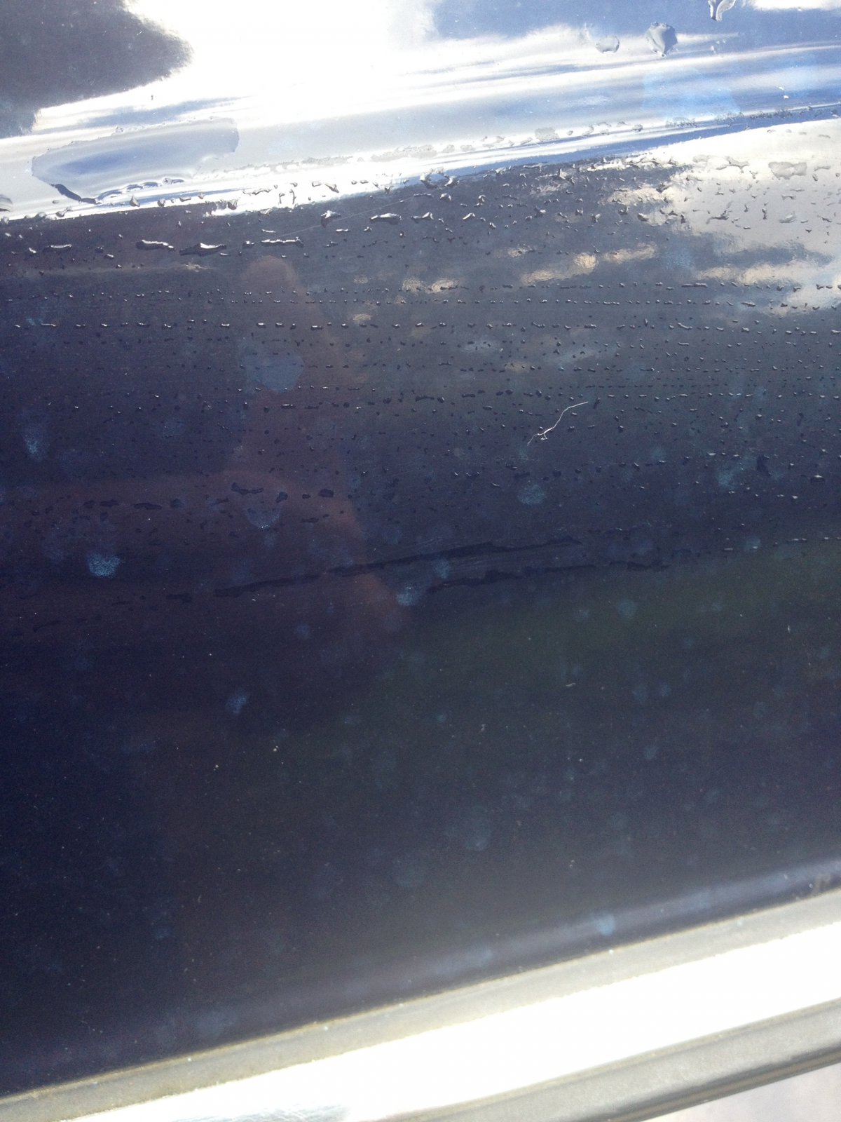

now the plot thickens, clear coat ? you said you used celly, what exactly did you use paint wiseI don't think it's that because:
1. I flatted the primer or clear coat back with 400 grit before painting.
2. I've painted over grey primer, and clearcoat and the effect's appeared on both.
3. It's definitely multi-coloured (like a rainbow, or an oil slick)
Anyone with experience of blooming on celly think this looks like blooming or something else?
I'm fairly sure it's appeared on areas I've not polished, which suggests it's not anything in the polish causing it.
No, rain shouldn't leave marks in the paintTook this photo just now showing the water marks (light blue) in the paint after it rained last night. I painted this panel last September. Is this normal?View attachment 88460
Would you expect paint that's been on the car for the best part of a year to do this?
