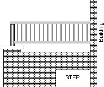

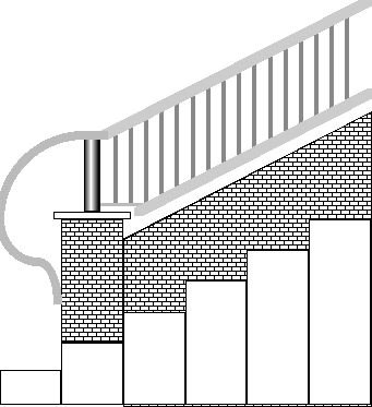

Hi guys, I need to install a railing in 2 weeks. It will be stainless and has some complex curves (not shown in this post). I have some queries about building regs and how to approach it all. Would appreciate any inputs from those who know.
It is basically a horizontal short run (about 1 m), then a 90 degree turn and down the side of an outdoor staircase.
At the top, there is a step running along the side of the building. Would the minimum rail height apply to the top of this 'step', or just the 'general ground level'? How would this normally be tackled - a very high railing of constant height, or one which changes height half way?
Secondly, at the bottom end, the brick pillar at the bottom of the steps is actually on the second step up, the last step has no adjacent wall. Do I need to run the railing right to the end of the steps, or just terminate it at the brick pillar (hopefully the diagram shows what I mean!).
If it must go to the end, I'll do a curve like the one shown. Would this also need fillers with a max 100mm spacing?
Somewhere I saved the pdf building regs for these, can't find them now! Any pointers to them???
Cheers, Al.
I've shown what I roughly intend to make. Any inputs much appreciated.
