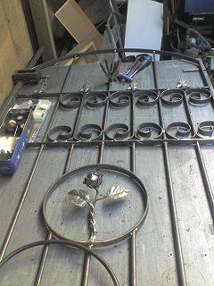

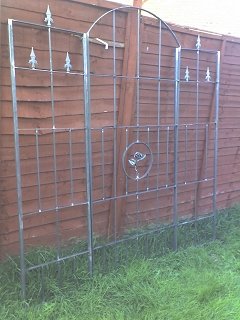

I nearly always buy in the pre punched flat bar, although we have the capabilitys to punch it, its just not worth the hassle. By the time its punched all the way along, its bent like a bannana, they you need to roll it flat again
Once made the fatal mistake - punched a bar all the way along, slid all the round bars in, then tacked them in all the way along - welded from one side. Gave me a lovely radius. Problem was it was supposed to be straight!
