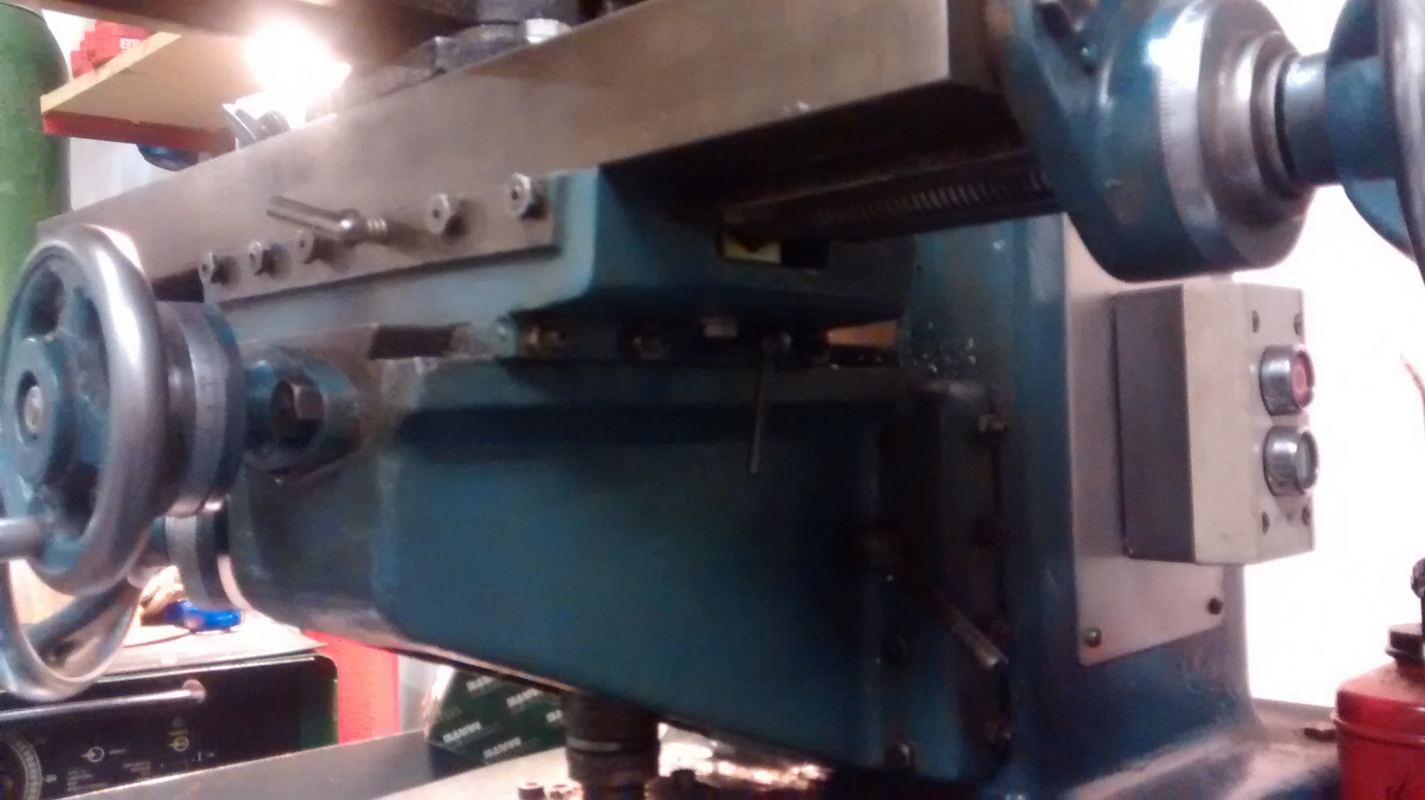

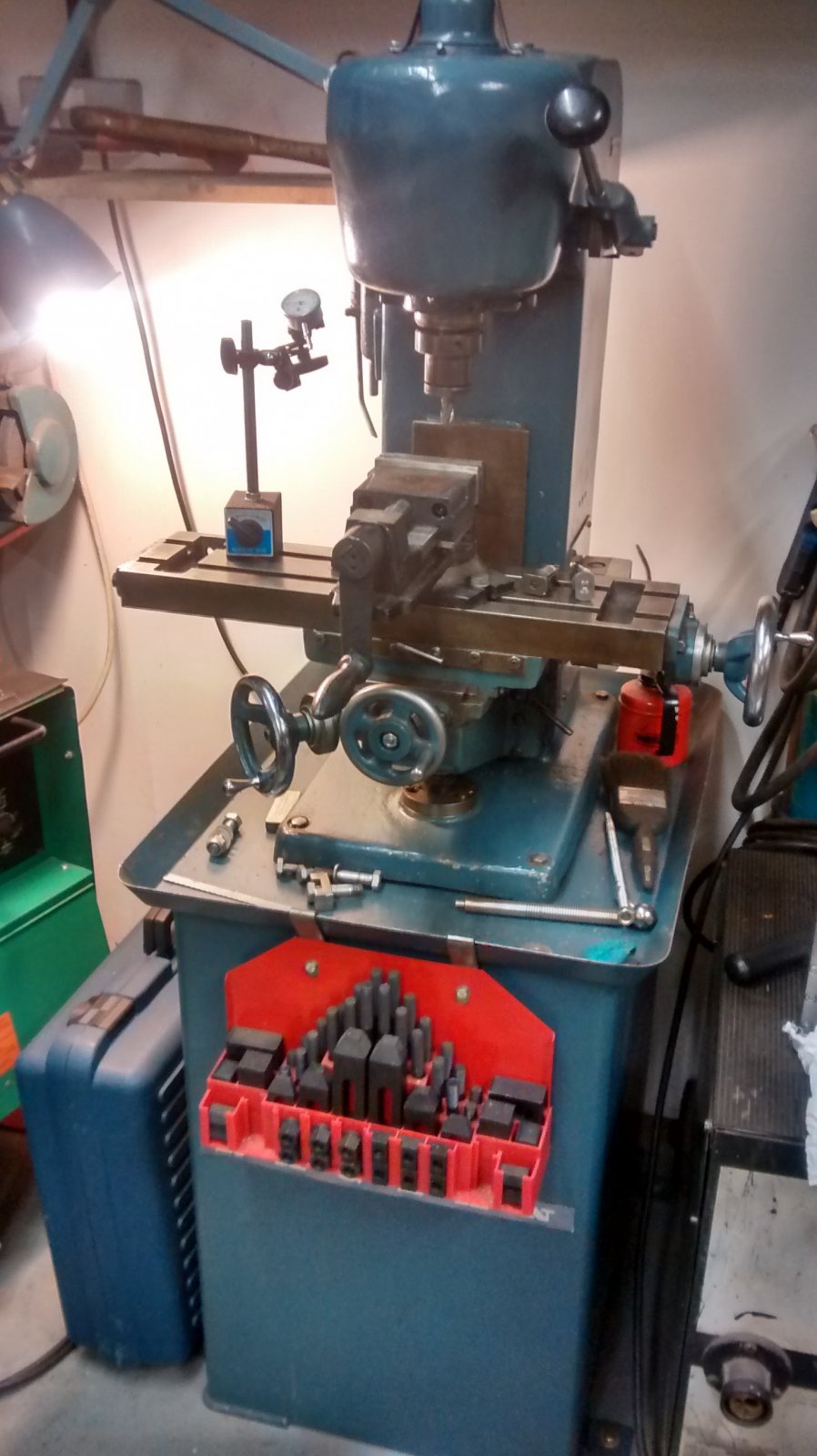

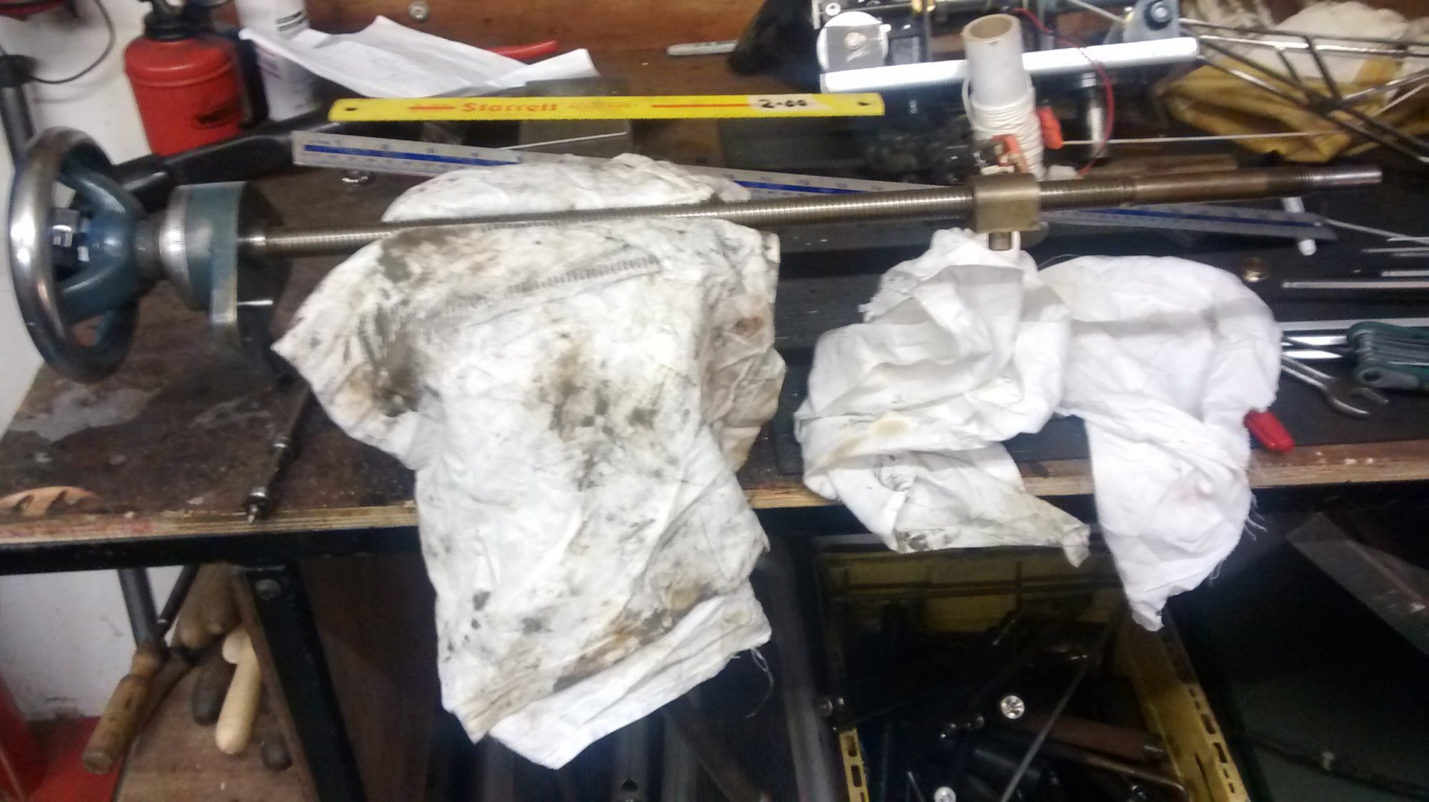

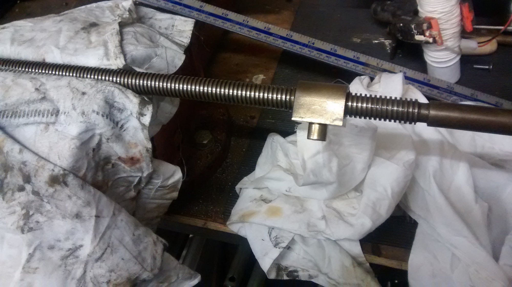

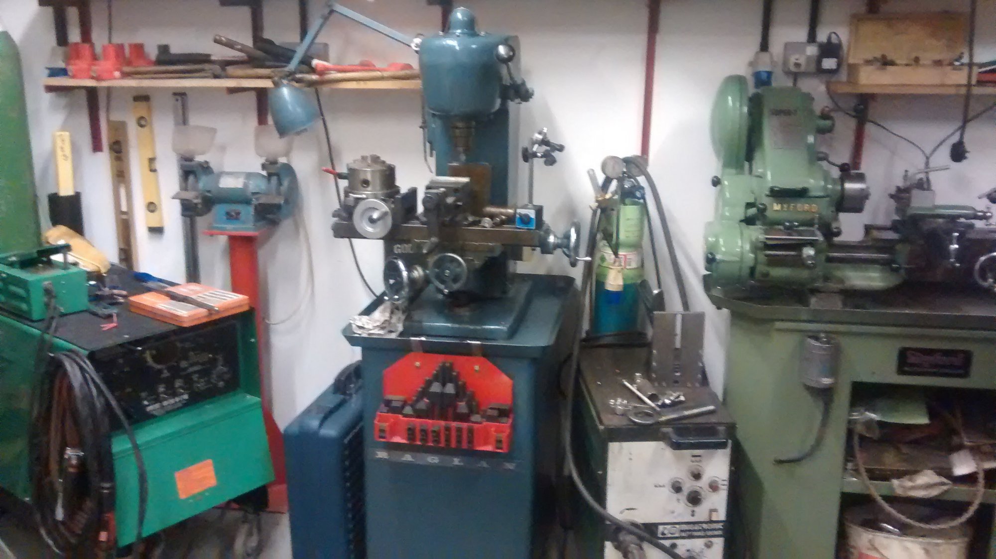

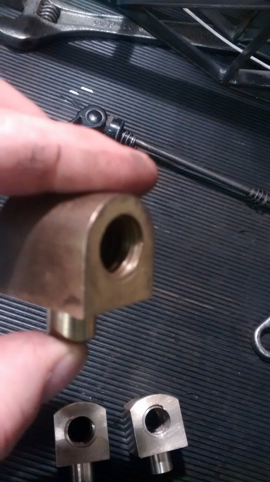

Good evening all, hope one of you can help. I noticed a massive amount of backlash on my miller today so I've stripped it down and on close inspection the nut is fubard. I can slide the nut three quarters the width of a thread on the screw so it can't have long left.
So the question is does anybody know of a place I can buy one off the shelf as I'm slightly terrified of the prospect of sending my leadscrew in the post and it goes missing

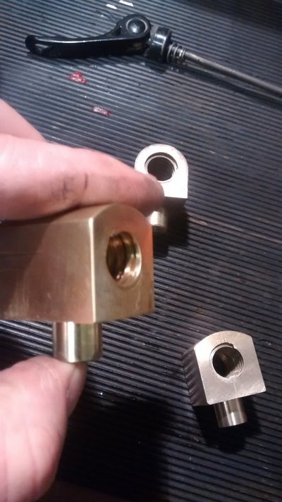

. I now ow a big favour to a friend of my brother who was (and still is) an expert machinist. He spent literally hours making me a replacement nut from scratch. It took 125 passes on his lathe to cut the internal thread
