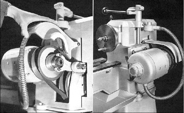

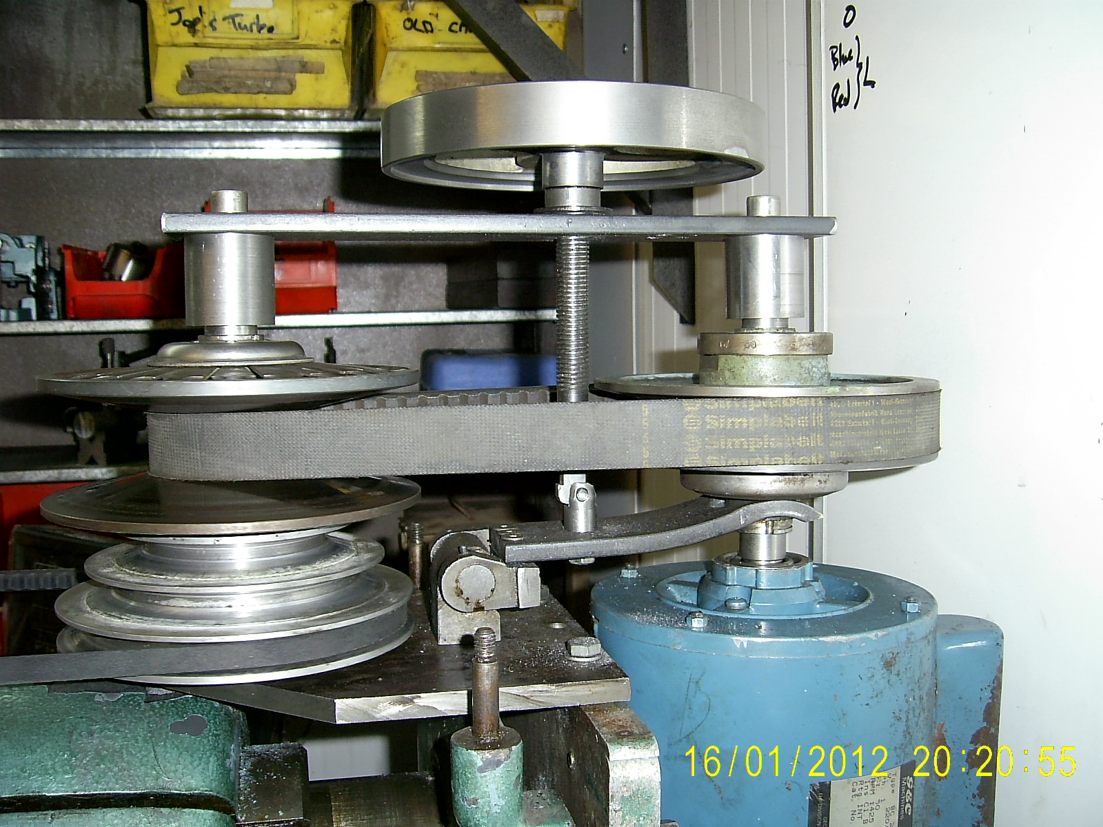

Machine is variable speed drive where two thrust forks one on the motor and second on drive shaft alter the pulleys thus giving speeds between 40 and 1700 rpm. Ive had to move these to get belt off to remove the motor. Ive got them back on but need to know how to set these up again to get the full rage of speeds. Both thrust forks are on the same shaft 180 degrees opposite and can be adjusted by a simple grub screw.
Does anyone know how to set these up correctly. Yes I know I should have taken photographs and measurements before dismantling but I didnt. Lesson learnt
