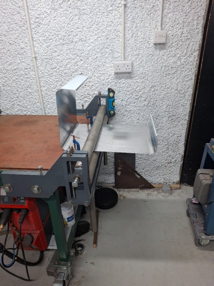

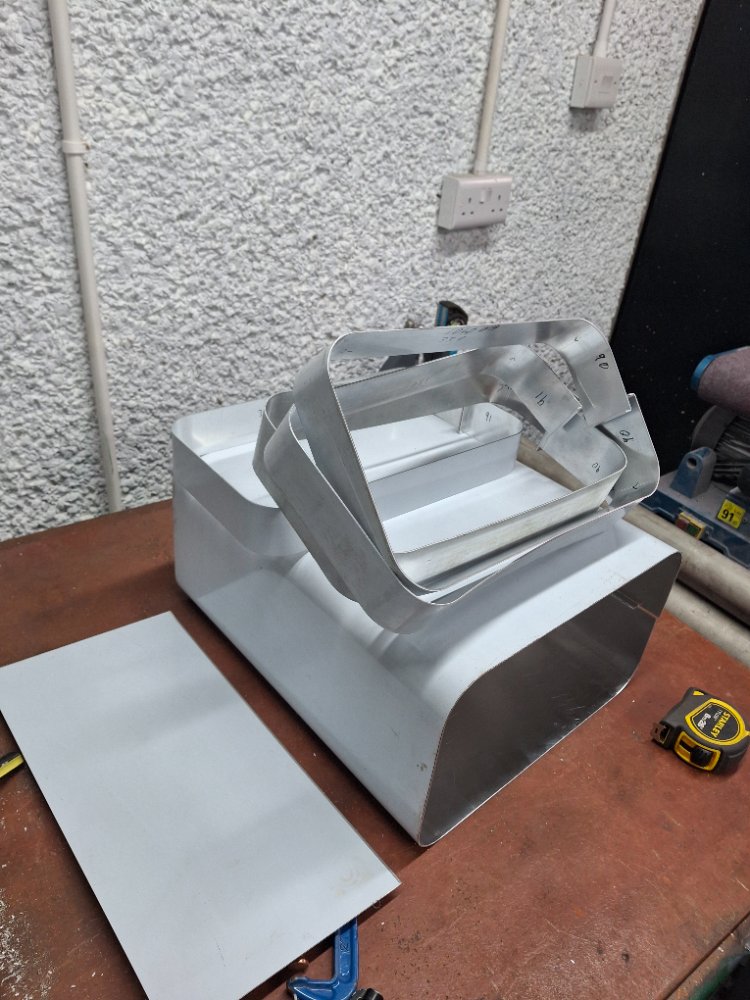

A bit more on the radius folder this and a few others will be test tanks i need to make something to clamp down the material otherwise it's difficult to get 2 folds the same, this is 1.6 1050 aluminium, 2mm will be max 1.6 should be ample once a add some more shape to it, I'm not sure yet how I'll work the end plates, I've a few ideas, I'm not keen on just slapping a flat plate on
