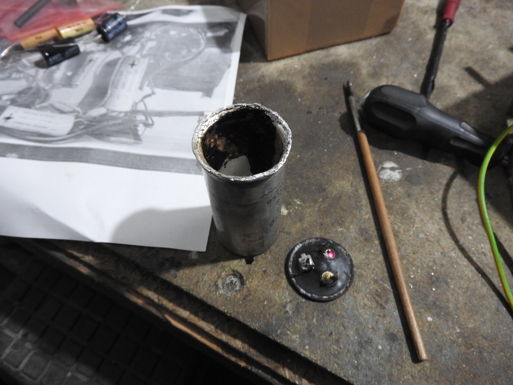

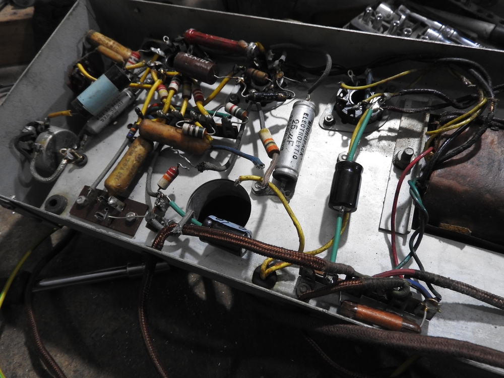

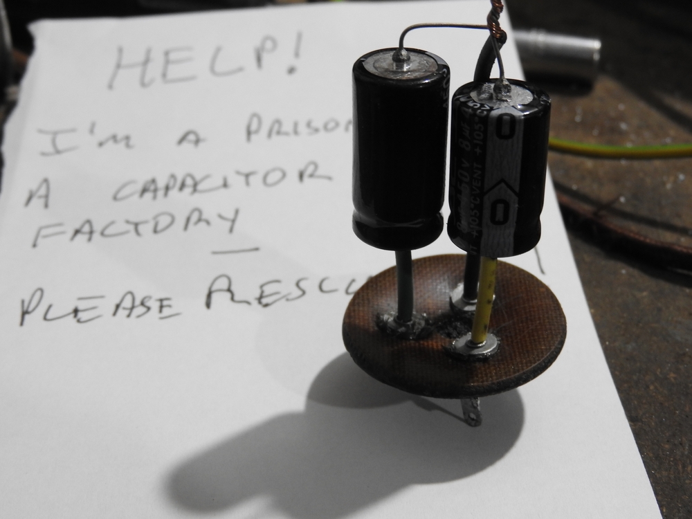

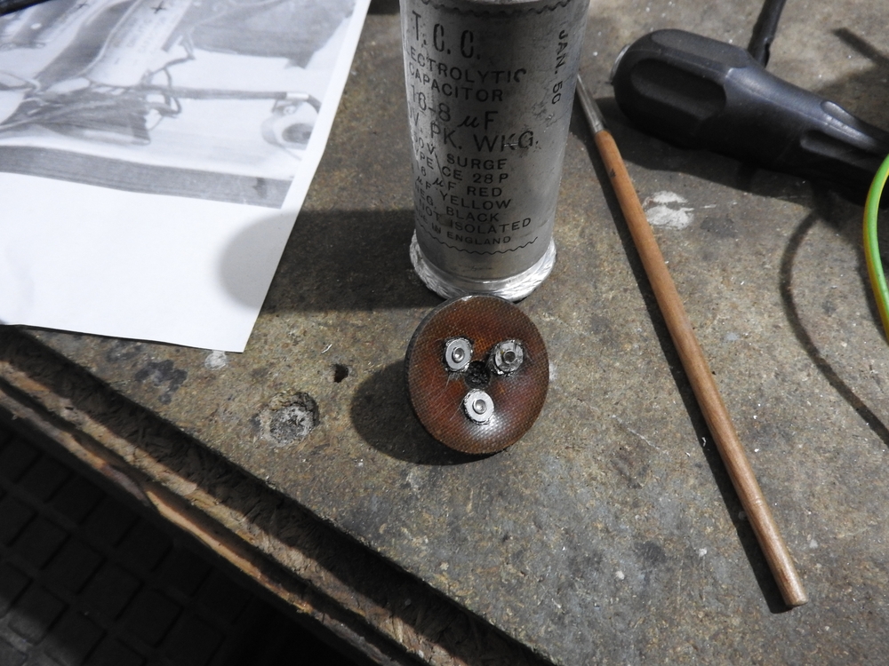

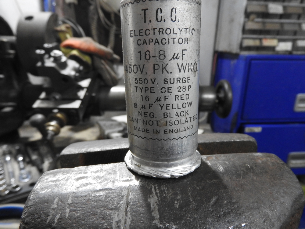

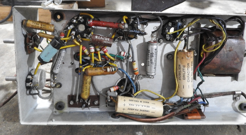

To that end I acquired a Fenman II (not a cheep out of it) and a Hacker Mayflower II which was working fine, but after a short time of operation the vital THAT Capacitor (term beloved of vintageradio forum) blew up. Serves me right for not changing it on sight, as said above.
