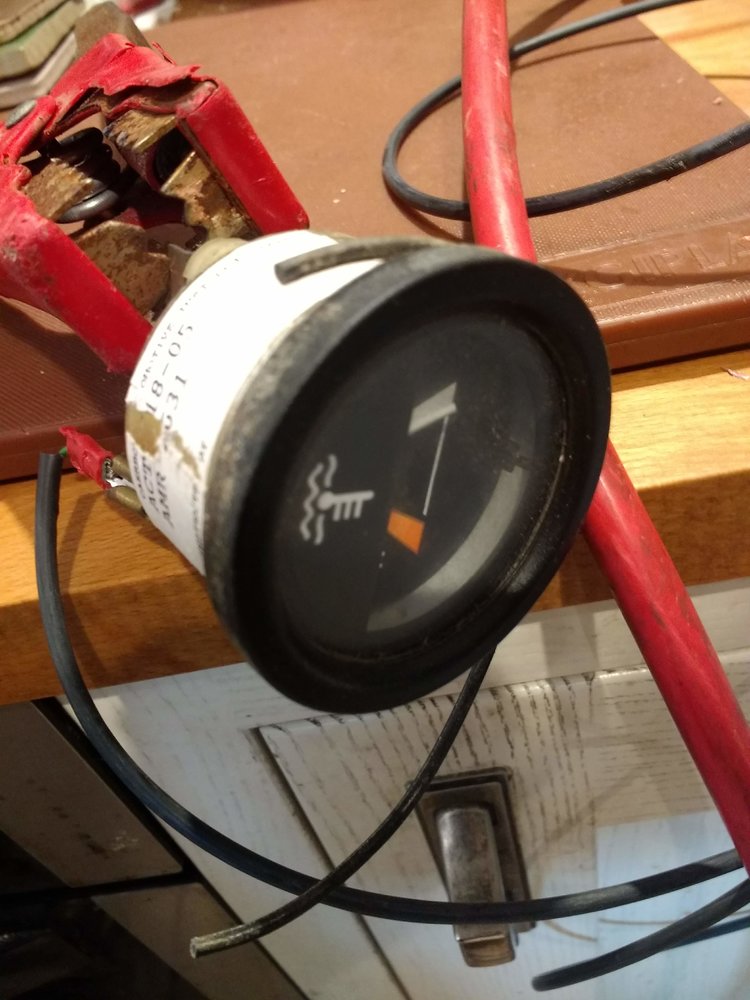

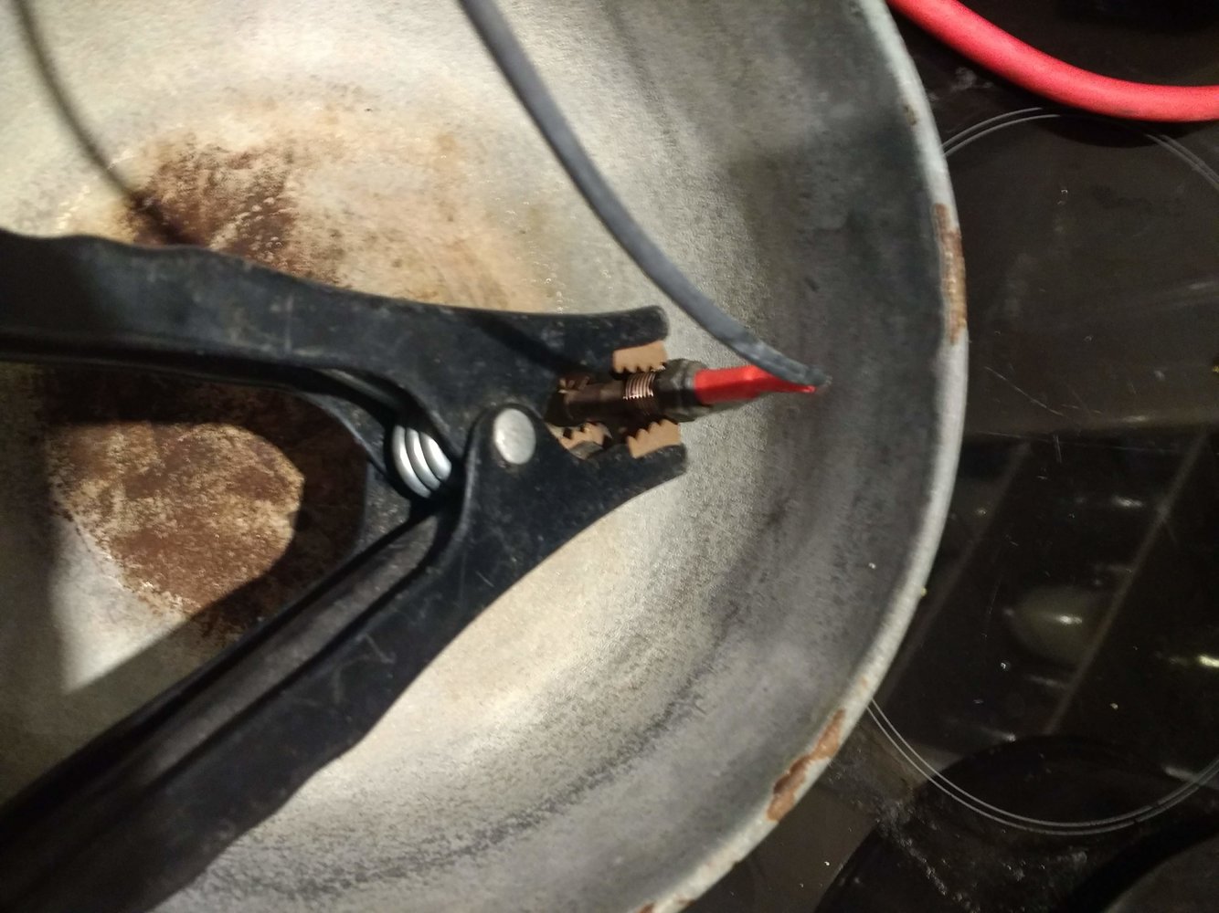

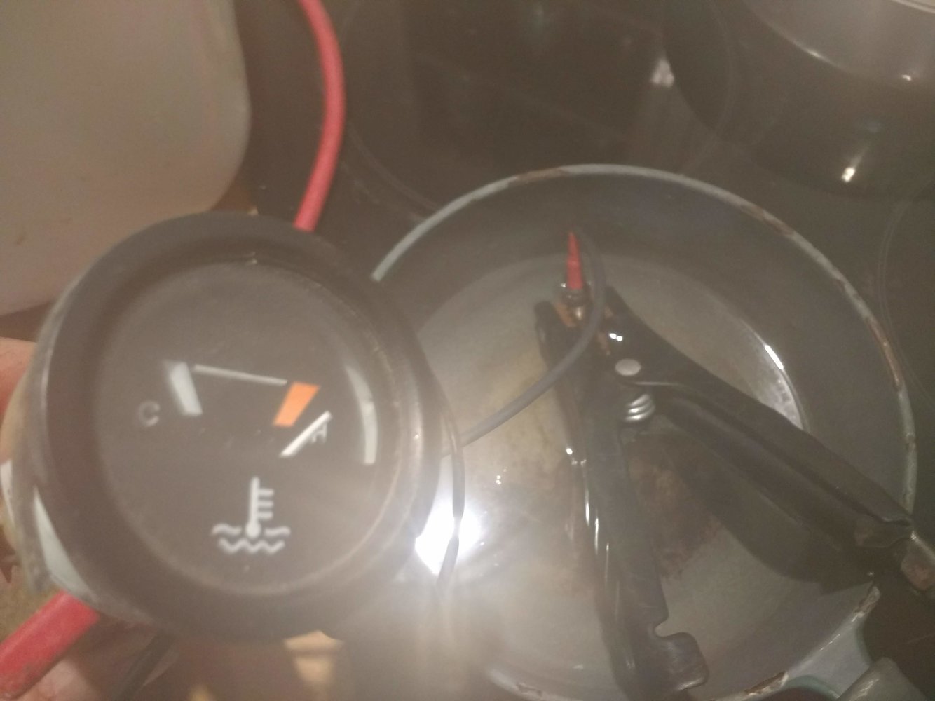

Ive not had time to look at this again until today. Just taken it for a short drive to get the needle off the end of the red...
Laser thermometer is reading about 75c externally. Id imagine that means up to temp internally, but ive changed the sender anyway, and the new one is identical reading to the old. Ill change the gauge later, but...
The bottom pipe isnt really warm. Certainly not hot. Which must mean its a flow issue.
The cab heater is getting hot, so that must mean, surely, its not a water pump issue, but a thermostat OR pipe blockage issue.
Its a new stat, replacing an old one, and there was no change when replacing. Ive got another engine here, so i guess ill pull an old stat from one of them, and either just change it again, or cut it up. But i think it would be wise to take off all the hoses too and make sure there's not a lump of something in any of them. I cant really see how there could be, but the symptoms point to that kind of thing, so there might be.
If i take the top off the headder tank and rev the engine, i can see the odd, infrequent bubble. Obviously this could be head gasket, or it could just be small amounts of residual air from all my messing about.
