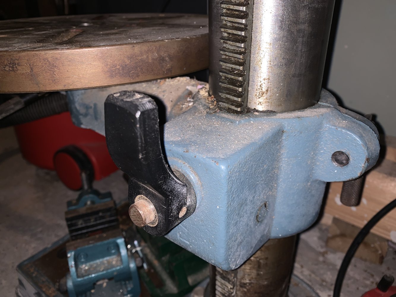

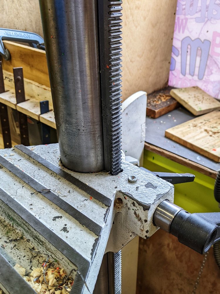

Whatever is the best of two evils I supposeWe had that mechanism removed as it was causing more grief and frustration for all concerned; the crank arm is a piece of flat bar with a hole in the middle, secured with a wee grub screw - so whenever the clamp screw was tightened it would bend the crank arm and wear away the shaft onto which it was loosely held. Fine in theory but not in practice.
Something we need to look at perhaps.
