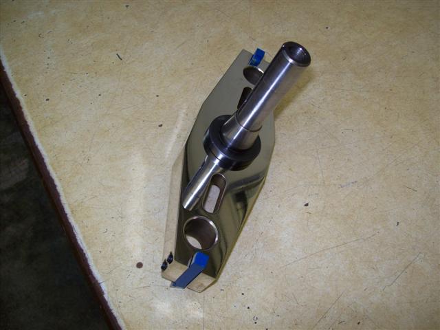

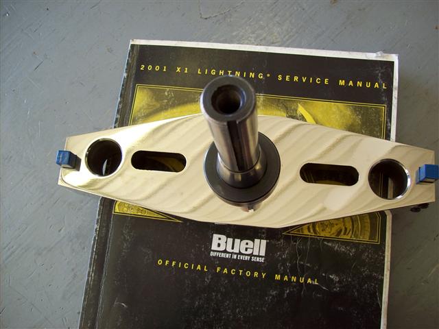

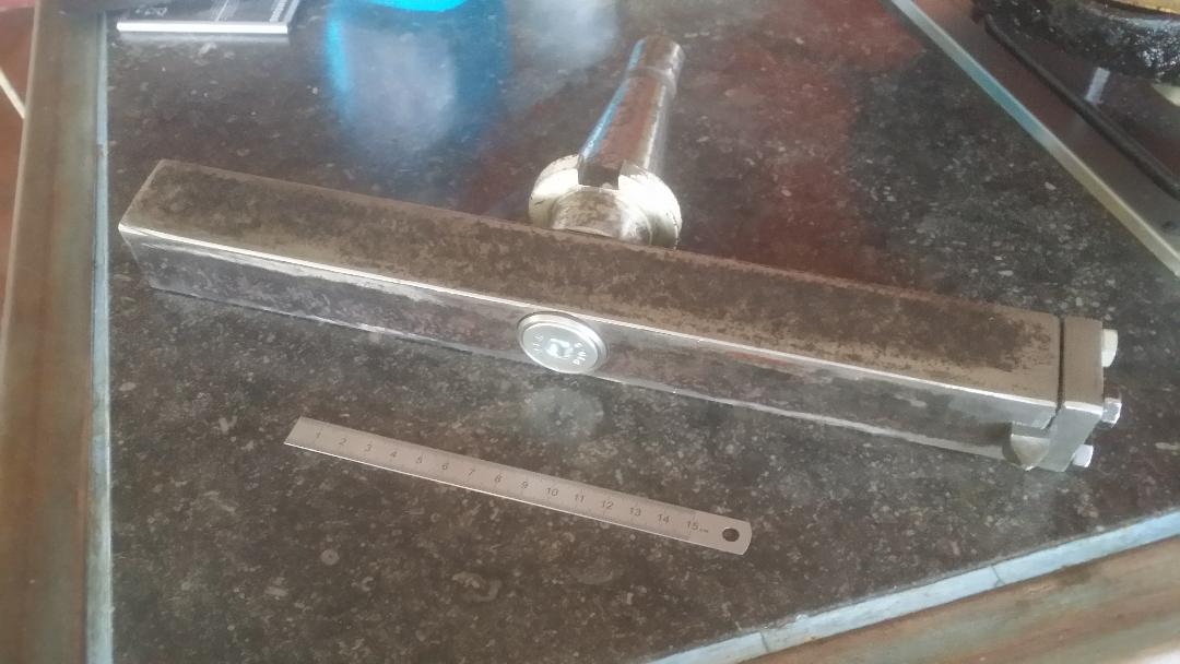

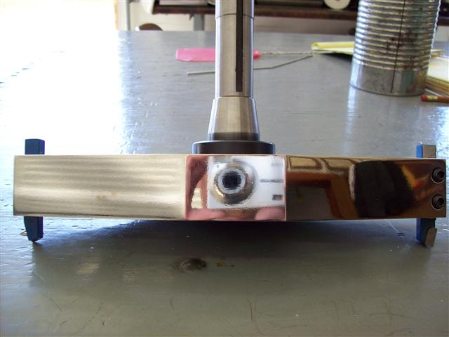

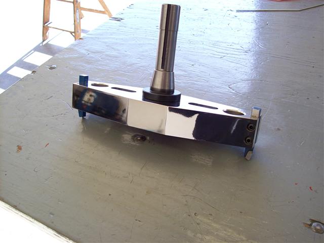

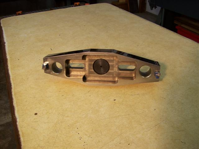

If time were on my side I'd be on it.That doesn't look like a terribly hard tool to make.
No good for my application unfortunately, I need a nice uninterrupted fly cut surface, not a face cut one.https://www.ebay.co.uk/itm/Kyocera-...226995?hash=item4d9705e233:g:kFEAAOSwOSddEK1w
Is 160mm too wide?
Needs tips and an arbour though
Maybe? I'm not sure what finnish the carbide cutter will leave in aluminium?So only put one insert in it? It's a bit over 6" diameter...
Dave H. (the other one)
You can get inserts specifically for ally, in a variety of shapes
I don't think the finish would be good enough for a cylinder head or block,As stated above maybe by running it with just one insert in would do the job but the cutter would have to be over 150mm in diameter to skim in one hit.Interested to know why? Ive got a 50mm facemill and with H01 inserts the finish is excellent.
View attachment 216455 View attachment 216456 View attachment 216457 View attachment 216458 View attachment 216459
