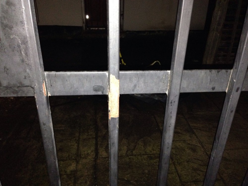

Difficult question to answer without specifics from your end. If your gates are made up of 2 inch prison bars then a little inverter with 2.5 mm rods ain't gonna cut it. But 2-4mm wall box and flat then as said above 70-80 amps with a rutile or basic electrode should stick it up well.so what amps and what tods would you need for welding gates
