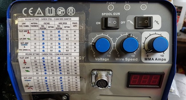

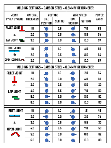

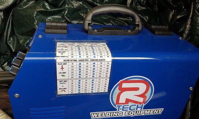

I don't know about you, but not using the welder frequently I have to refer back to the R-tech operating instructions manual, (sent with my mig welder) to just double check the ball park machine settings for the material I'm going to weld. Now the welding settings table(s) in the manual are listed over 2-pages, thus making it a bit of a pain when wanting to refer to, so I have put together a small compact quick check welding settings table for both the 0.6mm & 0.8mm Wires which I then laminated and stuck to the side of my welder, see photos. I have also have attached both a .JPG and a .PNG files of the table if anyone would like to use it. If by any chance I have made an error (not that I can see anyway lol) please let me know and I'll make the correction and repost the table in the for mentioned file types listed above.
Cheers
Rich
